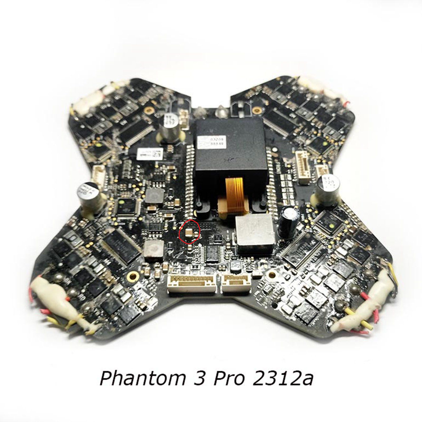

Hey Guys,
i bought a broken DJI Phantom 3 Pro so cheap i could not resist.
I thougt i would give it a try to fix it myself.
I know i could just buy a new ESC center board, but theres one capacitor on the board missing.
Its not that big electrolytic one most of the people are missing after a crash.
Do you know where i can get any information on the parts used on the board like a circuit diagram?
Or do you know how i can find out what values this part could have?
Greetings from Germany.
Its the one in the red circle:
All we have are partial schematics from here:
Also - if the board doesn't work, missing cap us unlikely to be the issue.
This specific cap, along with the small one near it, is used for smoothing the voltage at output of a buck converter (well, almost all caps on this board have that function). Any capacity will do, as long as it's in range of uF and not nF (nF is probably range of capacity of the smaller one).
