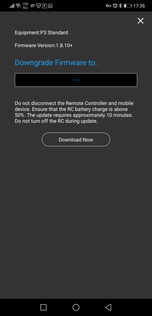

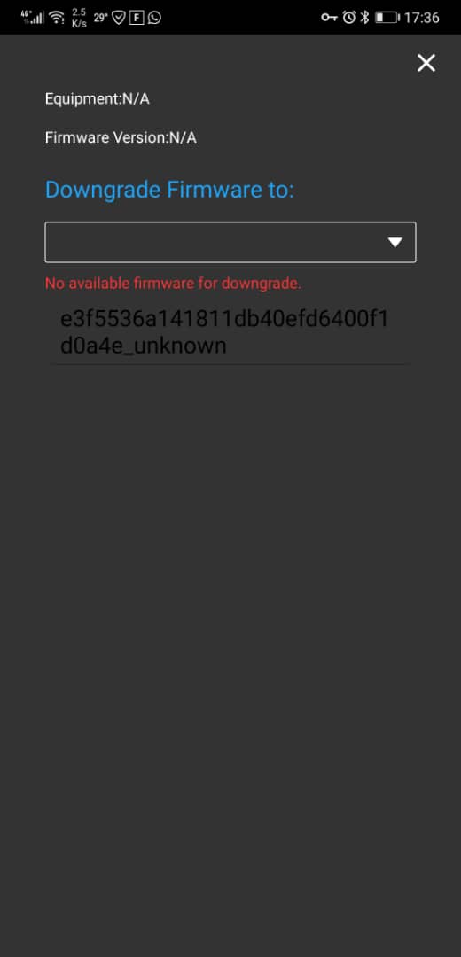

1st photo is when aircracft connected, 2nd photo is when aircraft disconnected. no option to choose firmware
View attachment 120928View attachment 120929
The first picture shows that your aircraft is a Phantom 3 Standard. The P3S does not use the GL300A or GL300B remote controller. This thread is about those two remote controllers. Sorry, I was under the impression that your aircraft was a P3P or a P3A. I have no idea about updates on the P3S and it’s remote controller. I would suggest that you use the ‘search’ feature of this forum to find information about your model of aircraft.
