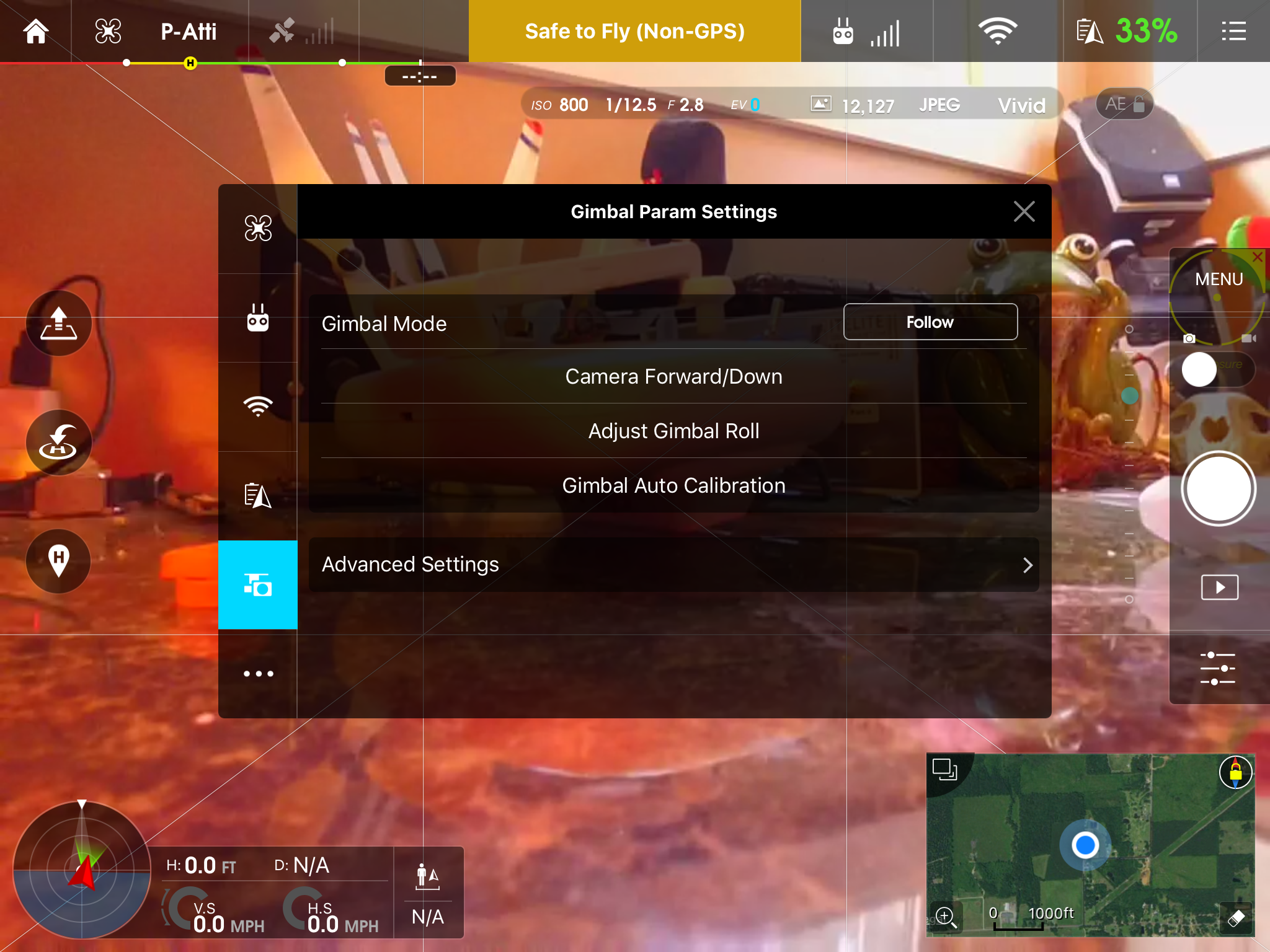

Here it is . Sorry it's on my table but you see the grid screen so you get up to see the horizon and click Adjust gimbal roll IMG_2695.PNG

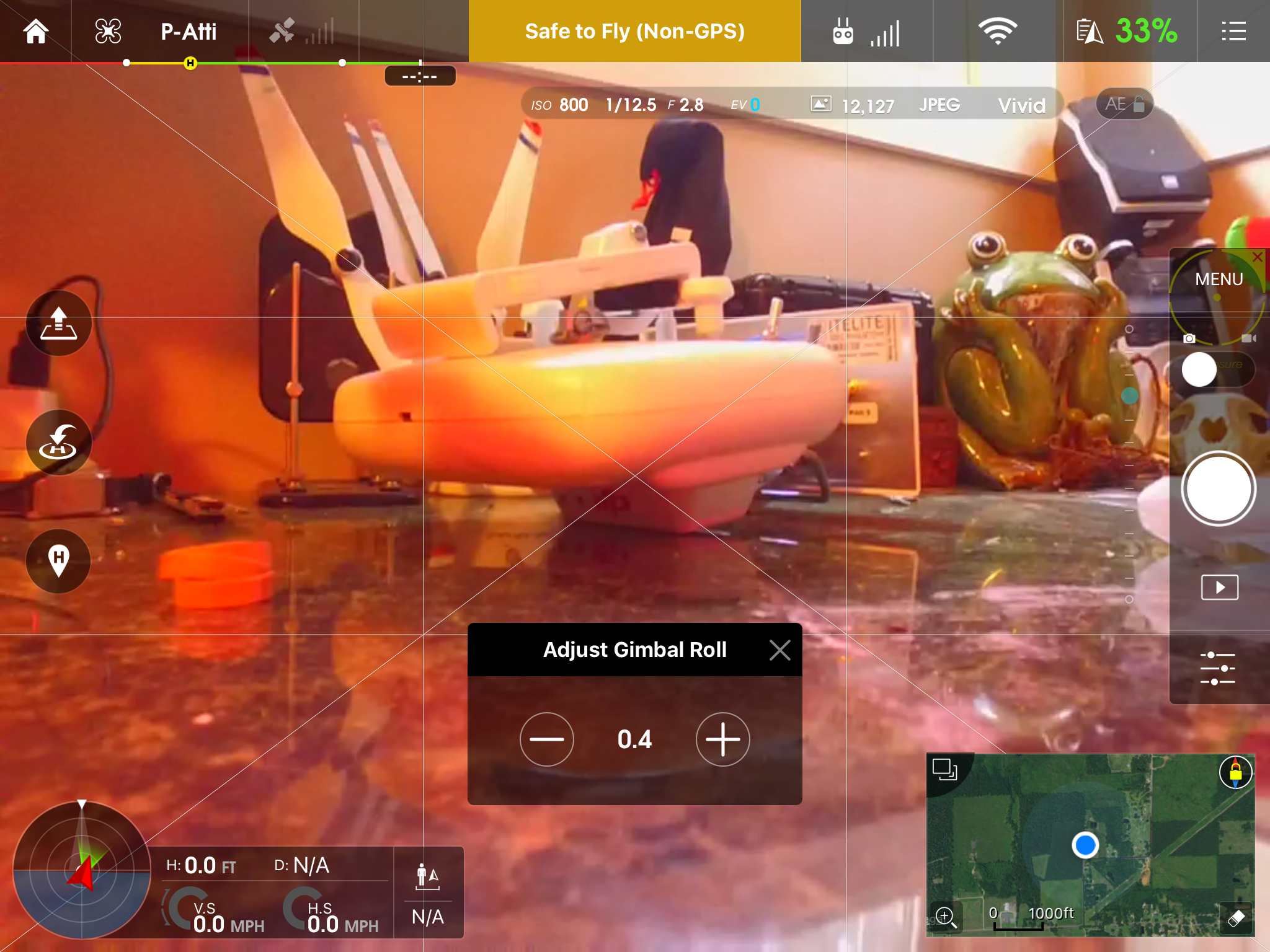

Then you adjust it here IMG_2696.PNG .
