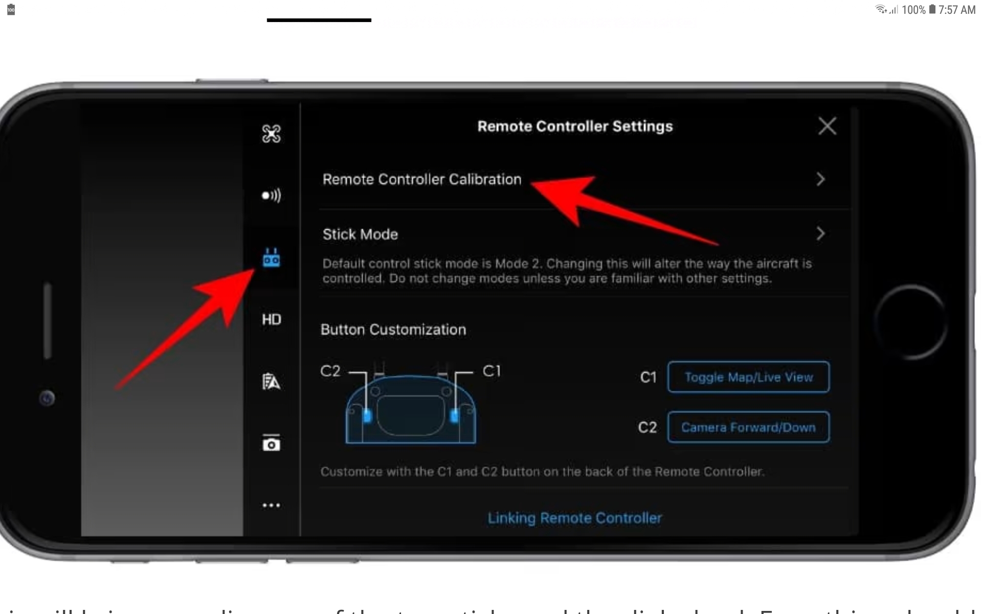

Can't figure out how to calibrate my controller, it just keeps beeping. upgraded firmware and calibrated aircraft with the tots.
Any help would be very much appreciated.
Turn on remote and device ,,open app,,click on the 3 dots top right of screen,find remote controller and click on and follow what it says,you have to move sticks all directions to there fullest movement and move gimble wheel left and tight and press done or Finnished when its complete ,pretty easy to do
