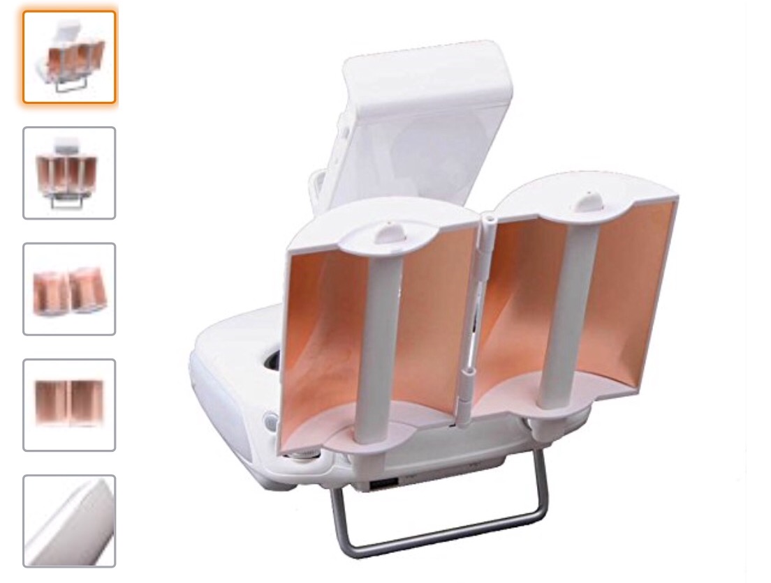

I have experienced the occasional comms. dropout with my recently acquired P4. I thought of upgrading to one of those signal booster kits which result in two external white square panels in place of the OEM antennae on the rear of the CU. But fitting those invalidates the warranty, due to the internal RF output modifications involved. So I bought one of these (at a much lower price anyway).
Although seemingly a sound idea, its implementation leaves much to be desired, for the antennae are badly oriented. Even without parabolic reflectors, the antennae are poorly positioned. The strongest signals are achieved from the flat surfaces of the aerials, which ideally should face upwards and away from the rear of the CU, to where the drone is most likely to be. With the curved copper reflectors in place, the strongest signals would be somewhere between straight ahead and focused downwards to the ground. If only the two antenna blades would swivel downwards, then the optimum upwards/forwards RF radiation direction would easily be achieved.
This would require the blades to be rotated by 180 degrees in the CU casing in order to be angled downwards, with the reflectors then fitted 'backwards' as it were. But in that respect, they are fixed. Does anyone know of an easy, non-invalidatory way of persuading them to rotate?

Tony, have you flown with your Parabolics yet ?? I thought the same thing after popping a set on to test. I thought they were aimed to low due to them hitting the RX when tipped back. This wasn't the case when i flew with them. Tipping the controller up would drop the signal %, They work very well aimed almost flat out at 10+K ft, 400 ft high.
But hey it's worth a try. I haven;t been into one yet but would assume they could be rotated if you take it apart. someone will chime it that knows. I personally would just add SMA jacks in the stock location. you could put some small Dba antenna's ( like stock or whatever ) and point them anyway you want.
Oh, sorry. you did mention warranty. I bough a P3P controller off EBay cheap, to mod and can keep the original in the box. For warranty and upgrade reasons.

I have used them just once, and was unimpressed. Perhaps due to their highly directional nature and my not having kept them aimed exactly at the drone - difficult when the drone is some distance away - I felt their use was worse than without them.
I've now ordered these...
despite their need to delve inside the CU and invalidate the warranty. (I am more than capable of fitting them, by the way). I would think the 'paddle' antennae can be oriented to best advantage, even if it means them being sloped downwards from their RF attachment sockets. They are reckoned to give a 7dB improvement.
As they're from China, they'll take a while to arrive, but at only 60% of the price of UK-shipped ones, I'll put up with the delay.
