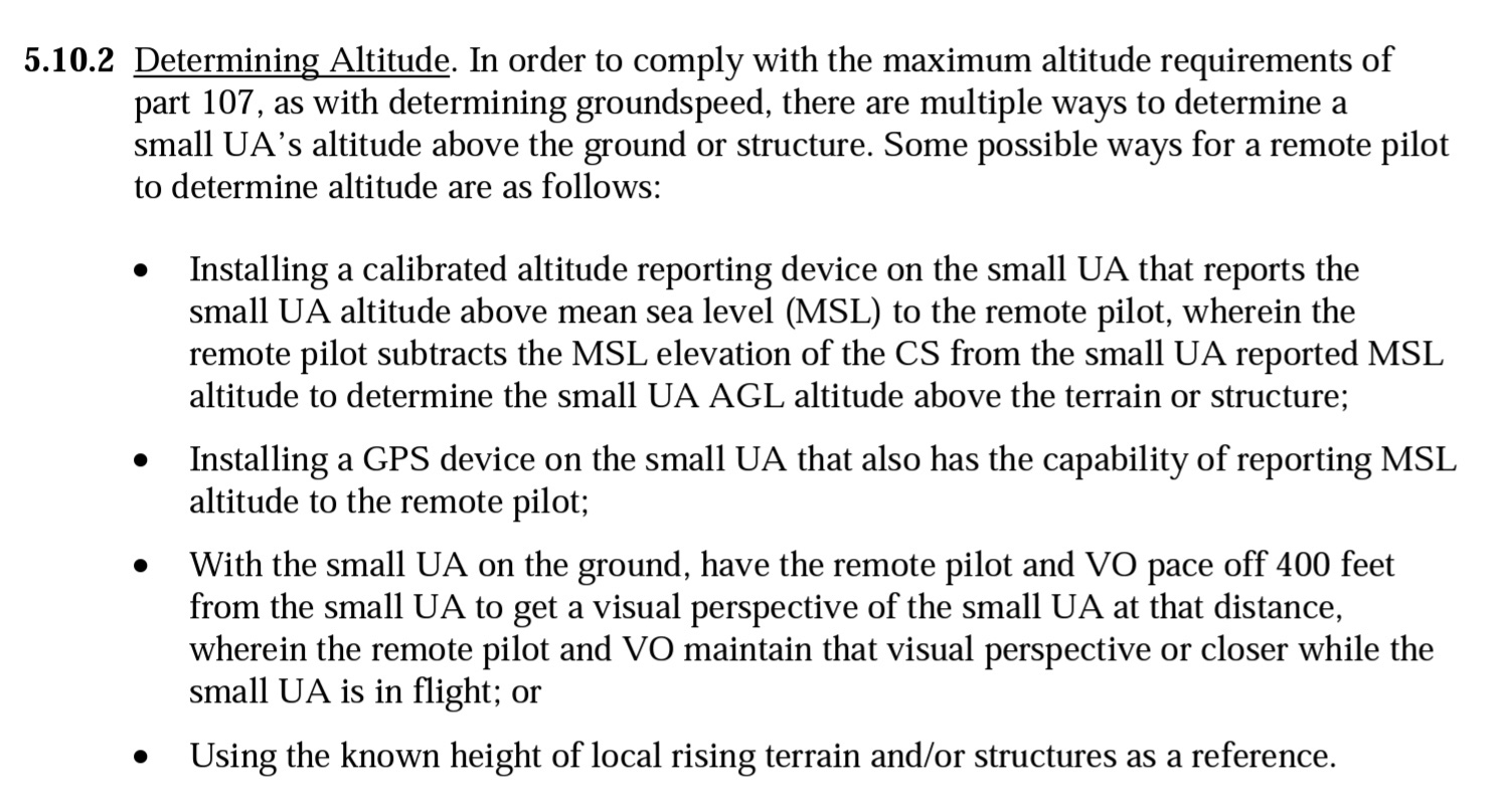

I'm sure that this was discussed already but I just couldn't find it.
Taking off from the hill and ascending to let say 100m. Then you fly at straight line forward away from the hill keeping the same altitude.
But the slope of the hill quickly causes the altitude to become a few 100 m from the ground, although you have still 100m on the display.
How can one keep the drone below those 120m (400ft) if the distance to the ground is not known in such circumstances?

Using the Phantom RTK it knows its actual altitude and corrects based on the topography. It is kind of cool, and kind of a PIA.
