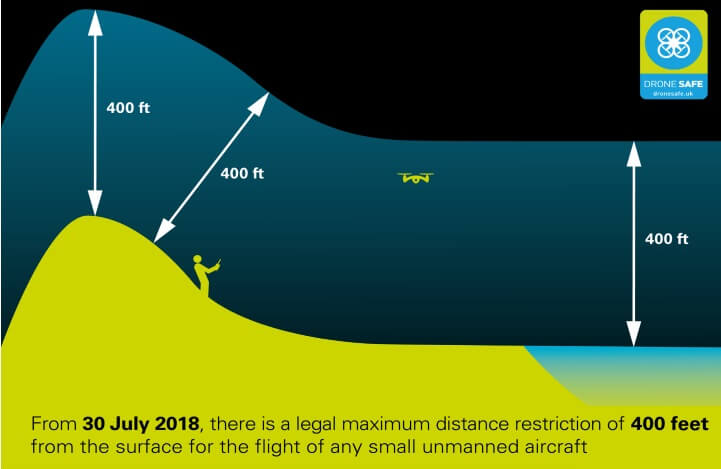

OK - so you are not arguing that there is ambiguity in the requirement - just that the onscreen display doesn't indicate height AGL? Unfortunately the lack of that indication doesn't change the requirement, any more than driving without a speedometer exempts you from speed limits.
The CAA explicitly addressed the operational meaning with regard to terrain in CAP1687:
109994
I don't see any room for confusion there. In the US, Part 107 mentions flying within 400 ft of structures but doesn't, specifically, address lateral spacing to terrain features. I think that most Part 107 pilots work under the reasonable assumption that a similar requirement applies, since it would otherwise be physically impossible to fly over a vertical cliff compliantly.
In any case this seems to me to be an unnecessarily complicated (and bad tempered) discussion, because the OP's question wasn't even about the cliff problem - it was just about whether you are required to maintain less than 400 ft AGL as the terrain changes elevation. There is surely no ambiguity about that question in the US or the UK - Part 101 excepted.
This discussion is really going over any resonable arguments.
My original question was answered but not completely. It is clear, that flying away from the hill top will violate the rule of max. altitude allowed. But the problem remains as operator will never know at which poiint he is over 400ft. It will always be only an estimation.And the authority won't know that either.
Your full flight track is in the flight log. Once imported into a program with a DEM, such as Google Earth - that will show height AGL. Alternatively, if you post photos or video, height AGL can be seen in the EXIF data or simply estimated from the field of view of the camera. So it would be unwise to assume that the FAA or other LE authorities would be unable to verify whether you broke the law.
