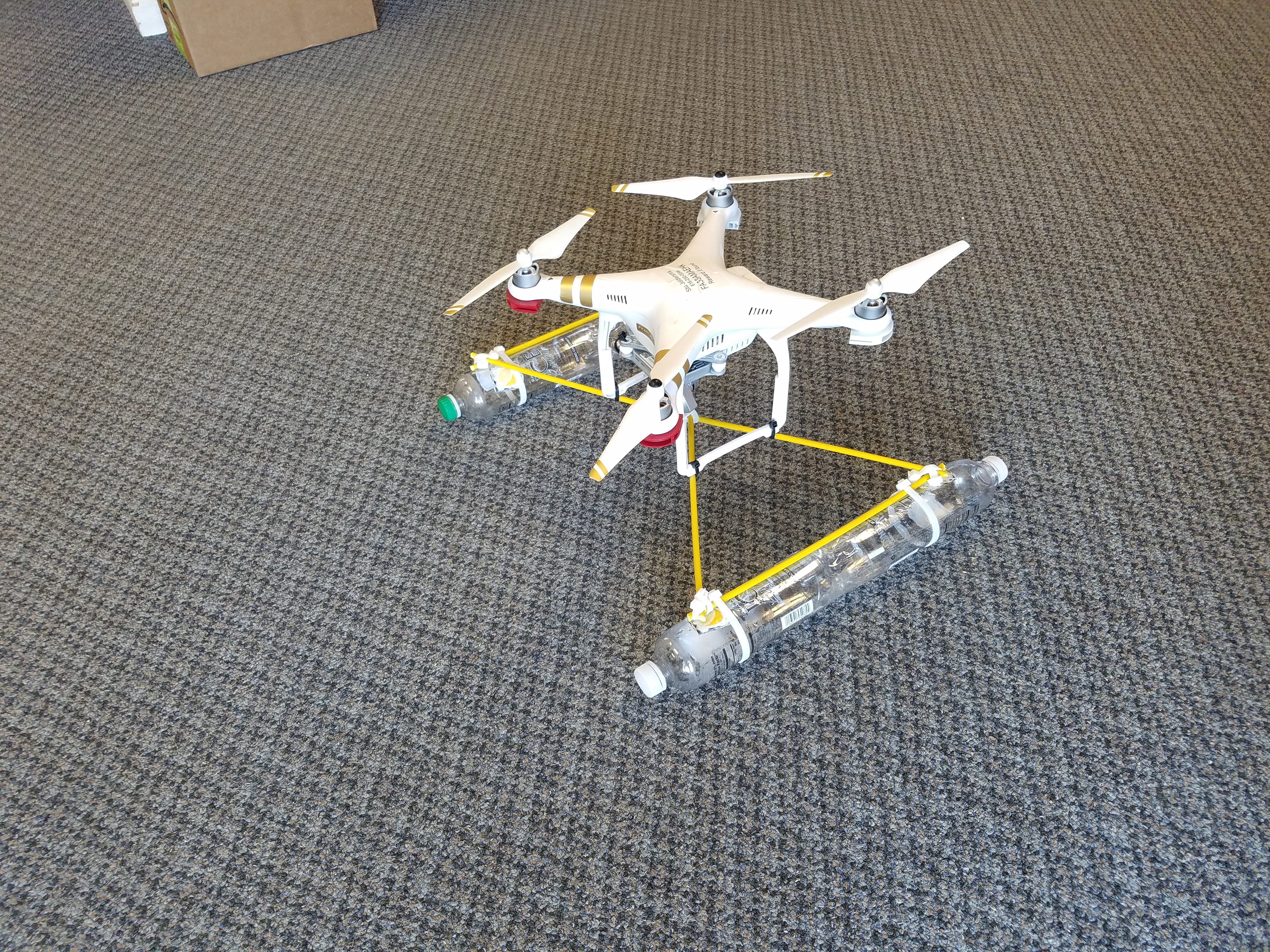

After a unfortunate incident involving a steel boat, a little wind, a vhf antenna and a exit from gps mode because of the steel boat my p3p fell into the water. Fortunately it was in only 5 feet of water so I recovered it quickly and pulled the battery immediately. After drying it out for 2 days with lots of canned air it was fine. Since most of the shots I want involve much deeper water I built a set of water bottle pontoons for the drone. They work well the drone is stable on the water and still flies well, albeit slightly sluggish.
