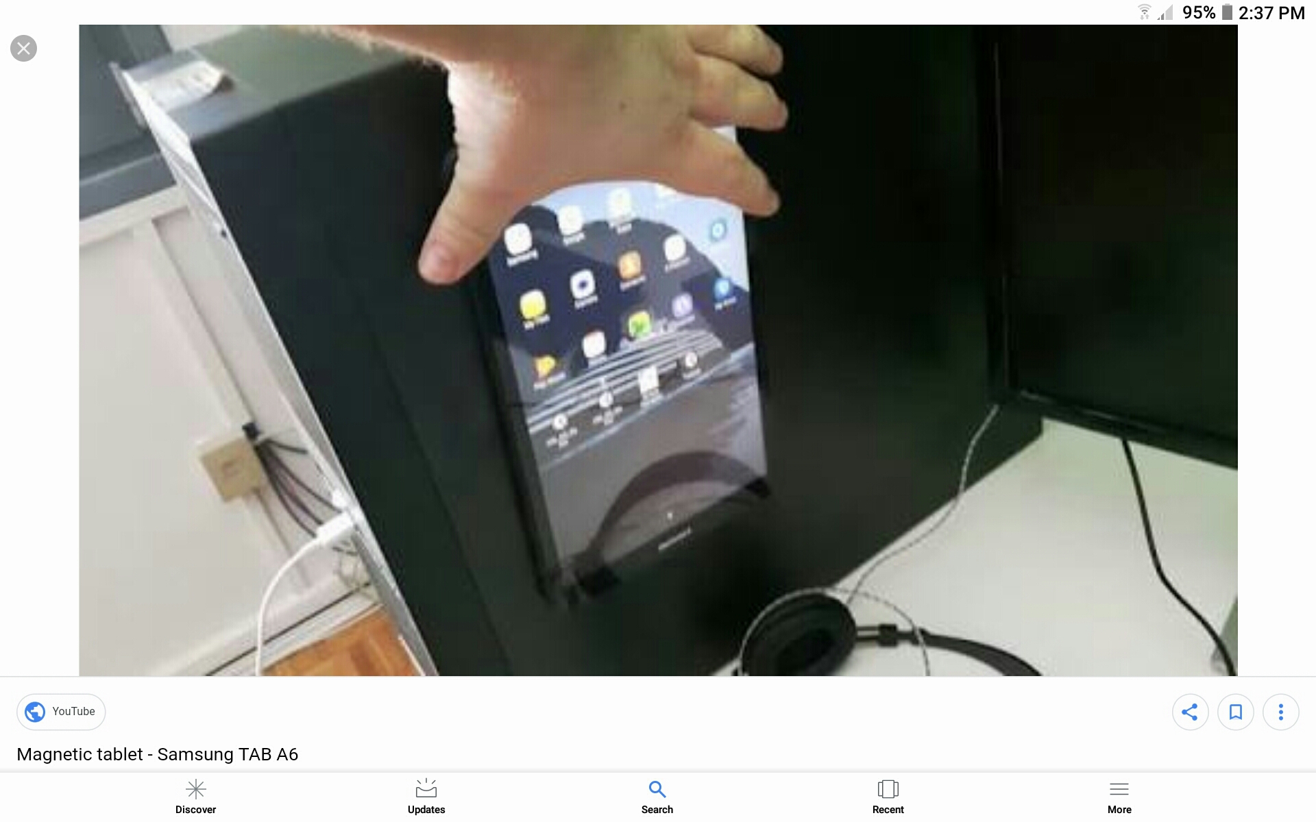

Yep there's a few magnetic devices around like this,I use tab A s pen 2016 10/1" and 8",,I fly with the 10/1 all the time and never a issue for me,I think they put those in cause it so heavy it get hard to hold,,holds my beer bottle opener on back good which comes handy but Yeh no issues for me,,I go find a post from past
Reactions: MotorCycle-Man
Can't find my previous post so this one tab a6 ,mine like this but no trouble with any app,or close to me drones
