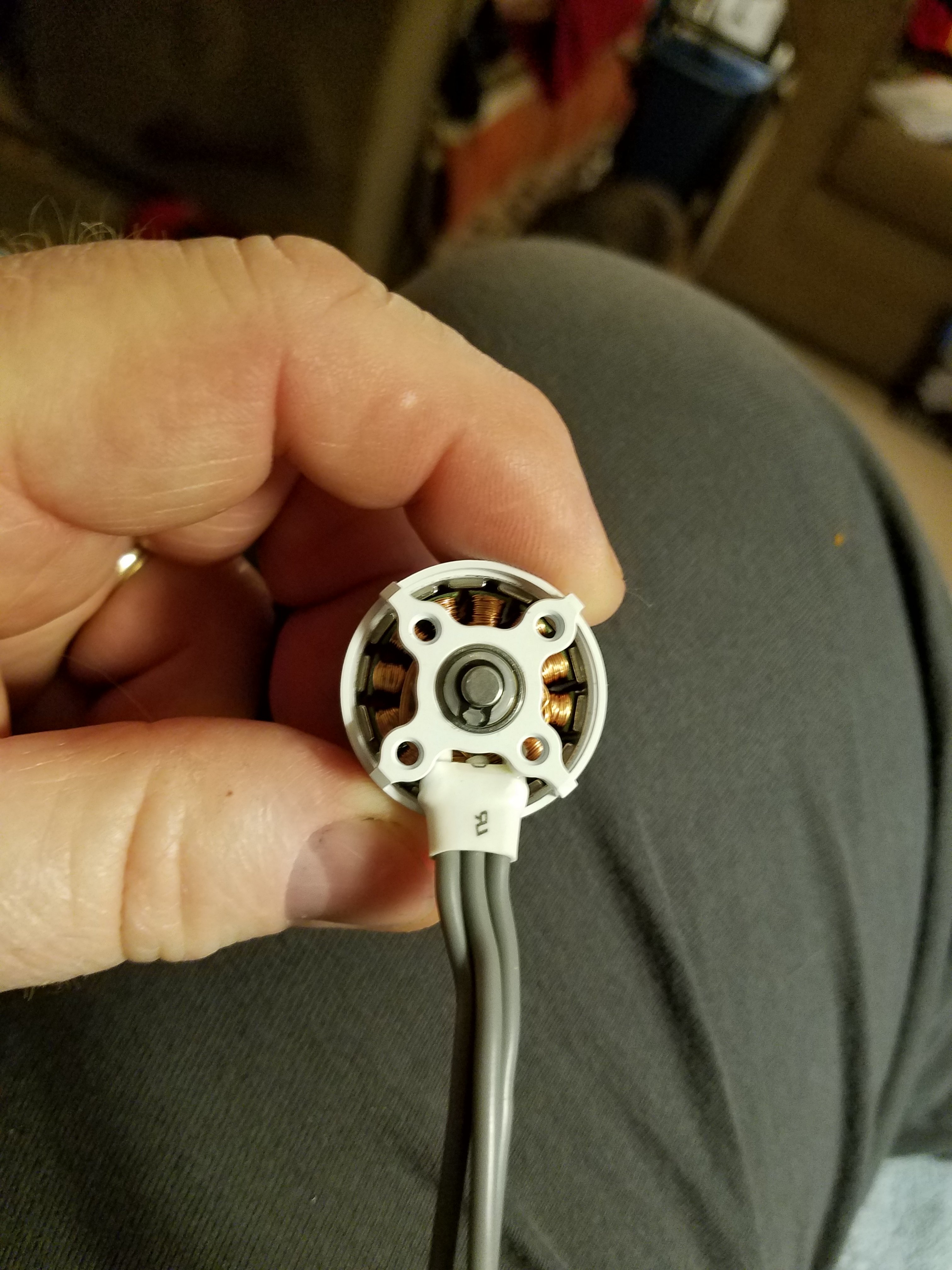

L lowoctane Joined Feb 4, 2018 Messages 17 Reaction score 2 Age 74 Mar 12, 2018 #1 Does anyone know the polarity of the 2214 motor? They are not color coded so it makes it a bit difficult to install them correctly
Florida Drone Supply Joined Dec 8, 2016 Messages 624 Reaction score 277 Location Southwest Florida Mar 12, 2018 #2 Just plug them in any order, if the motor spins the wrong way switch any 2 wires.
L lowoctane Joined Feb 4, 2018 Messages 17 Reaction score 2 Age 74 Mar 12, 2018 #3 Florida Drone Supply said: Just plug them in any order, if the motor spins the wrong way switch any 2 wires. Click to expand... Ok, thx! Reactions: Florida Drone Supply
