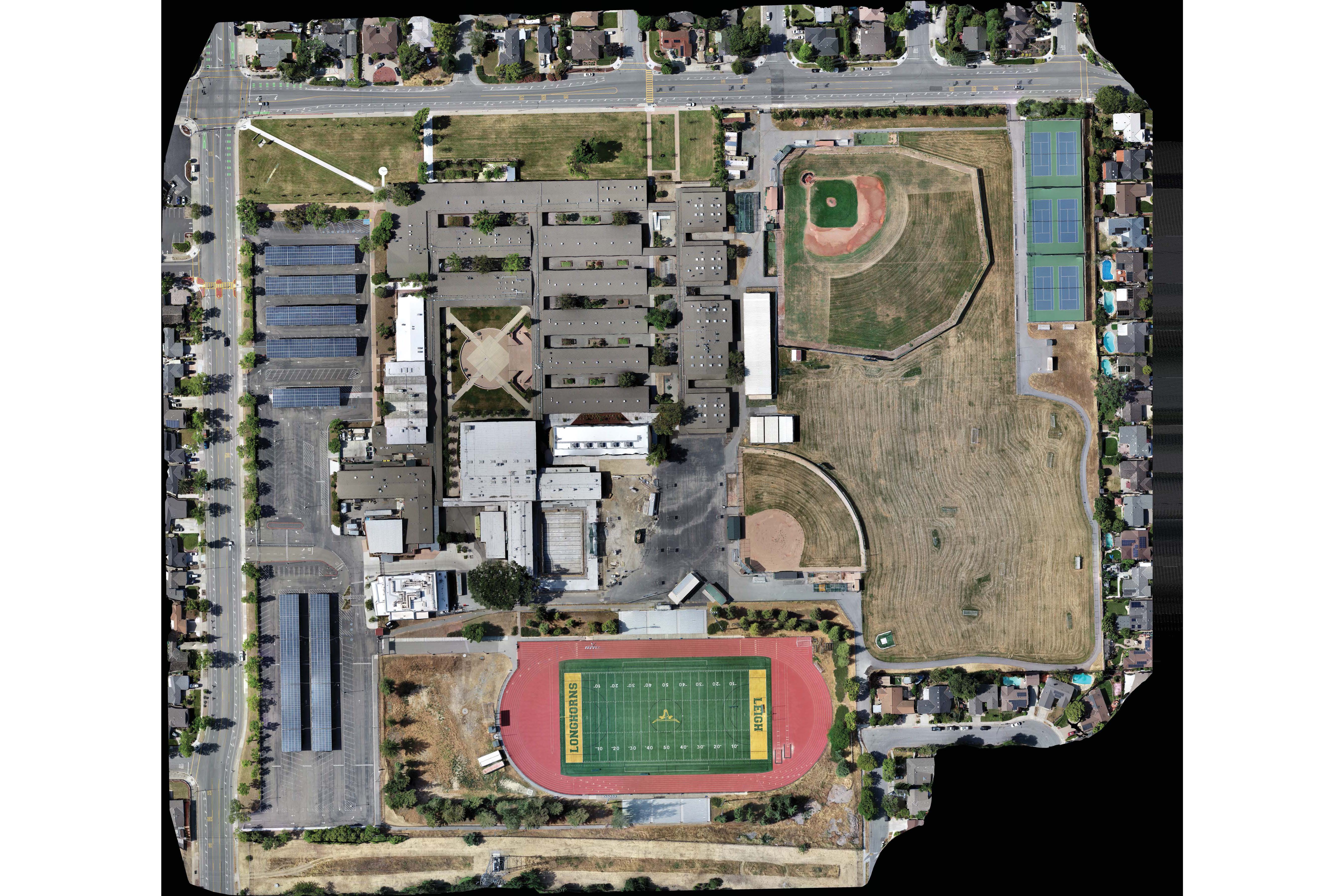

For one mapping job hire a drone pilot!
If you want to DIY then buy a drone, Phantom 4 ProV2 and accessories for $3000, or a Phantom RTK for $7000. Get your FAA Remote Pilot's License after studying for a month ($150). Then spend time and money on drone mapping software such as Drone Deploy = $300/mo + $50 per map with GCP's.
I would be glad to give further advice on mapping. I'd help you map it, if the quary was in the SF Bay Area.
