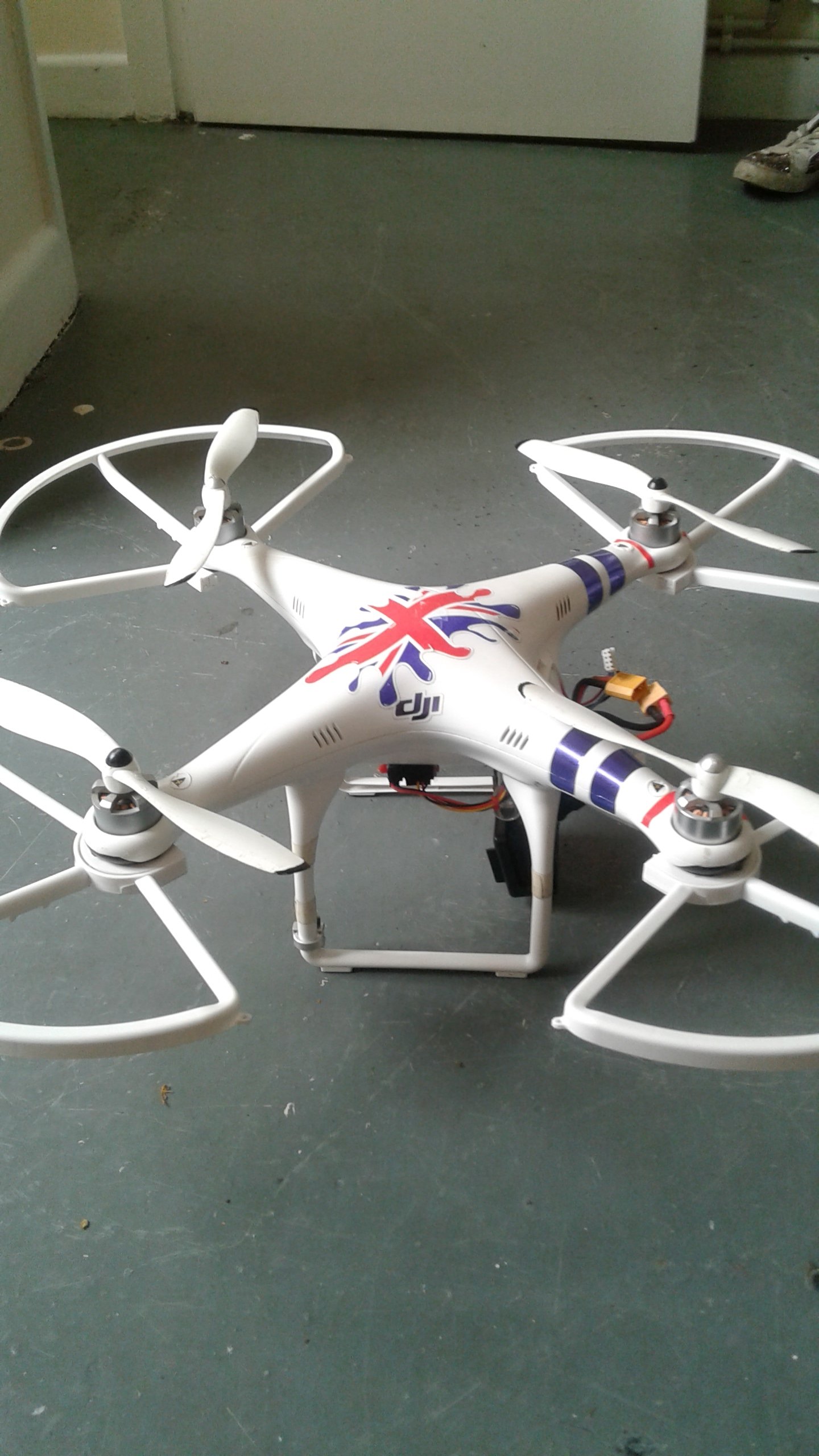

I have bought my hubby a drone and can't connect to remote as I don't know which one it is
The manual can be found on DJI's website HERE
Link Procedures
1. Power off transmitter and power on aircraft. You will see the link indicator blinking red.
2. Press link button and hold until the link indicator blinks yellow. Release the link button.
3. Power on transmitter and link indicator should switch off. This indicates that the link has been successfully established.
If I remember correctly the link button is located inside the battery compartment, It's been a few years since I had mine.
