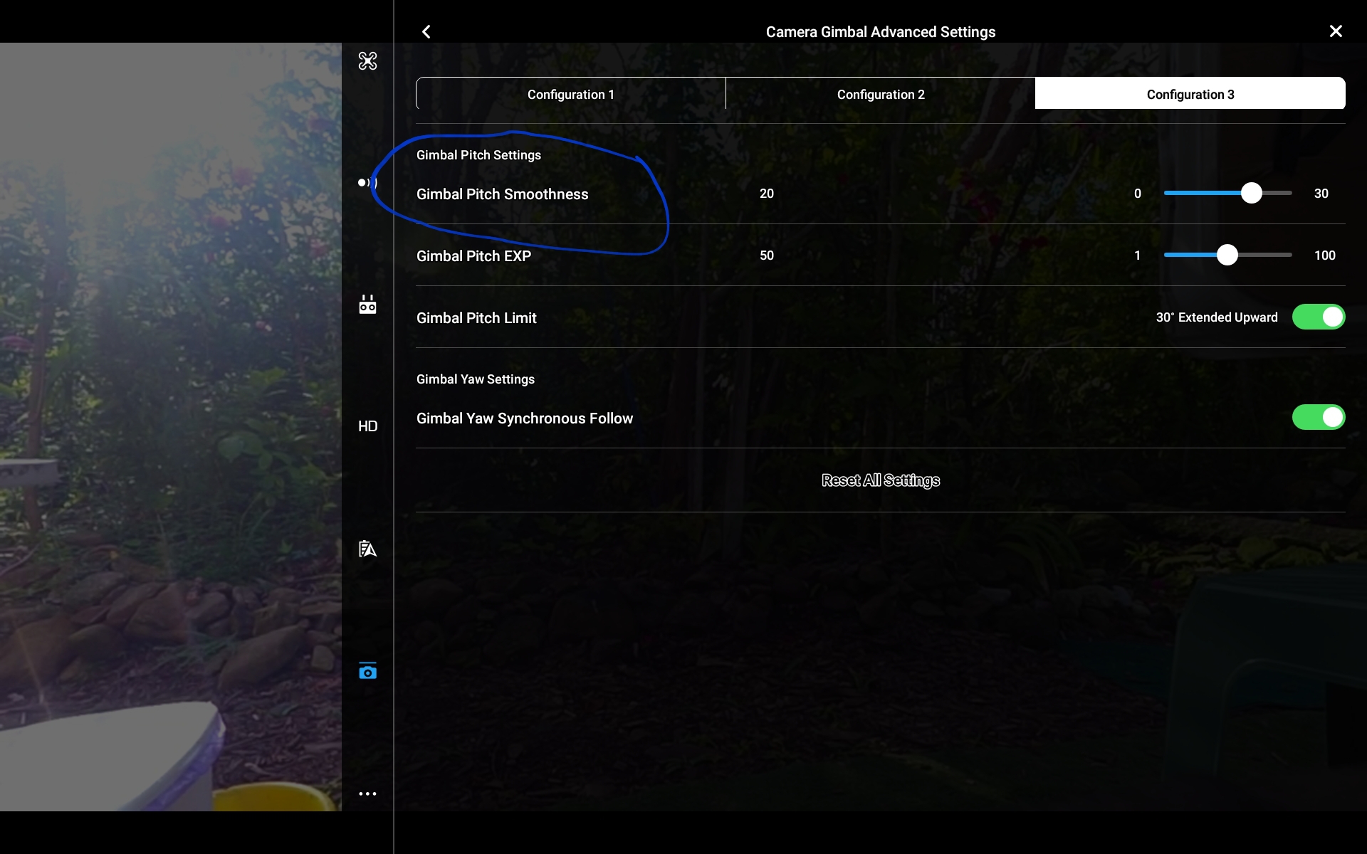

Hi Guys
Has anyone had issues with there camera having a sluggish response when raising and dipping using the left controller dial. The movement also continues for a second after the dial has been released. Is this a factory send off coming up??

Have a play with gimble buffer speed,this controls speed from when wheel turned to when cam stops,can make it work slow or fast,,might help
Reactions: Capt KO
Perfect will give this s try. Never knew the speed adjustment even existed.
