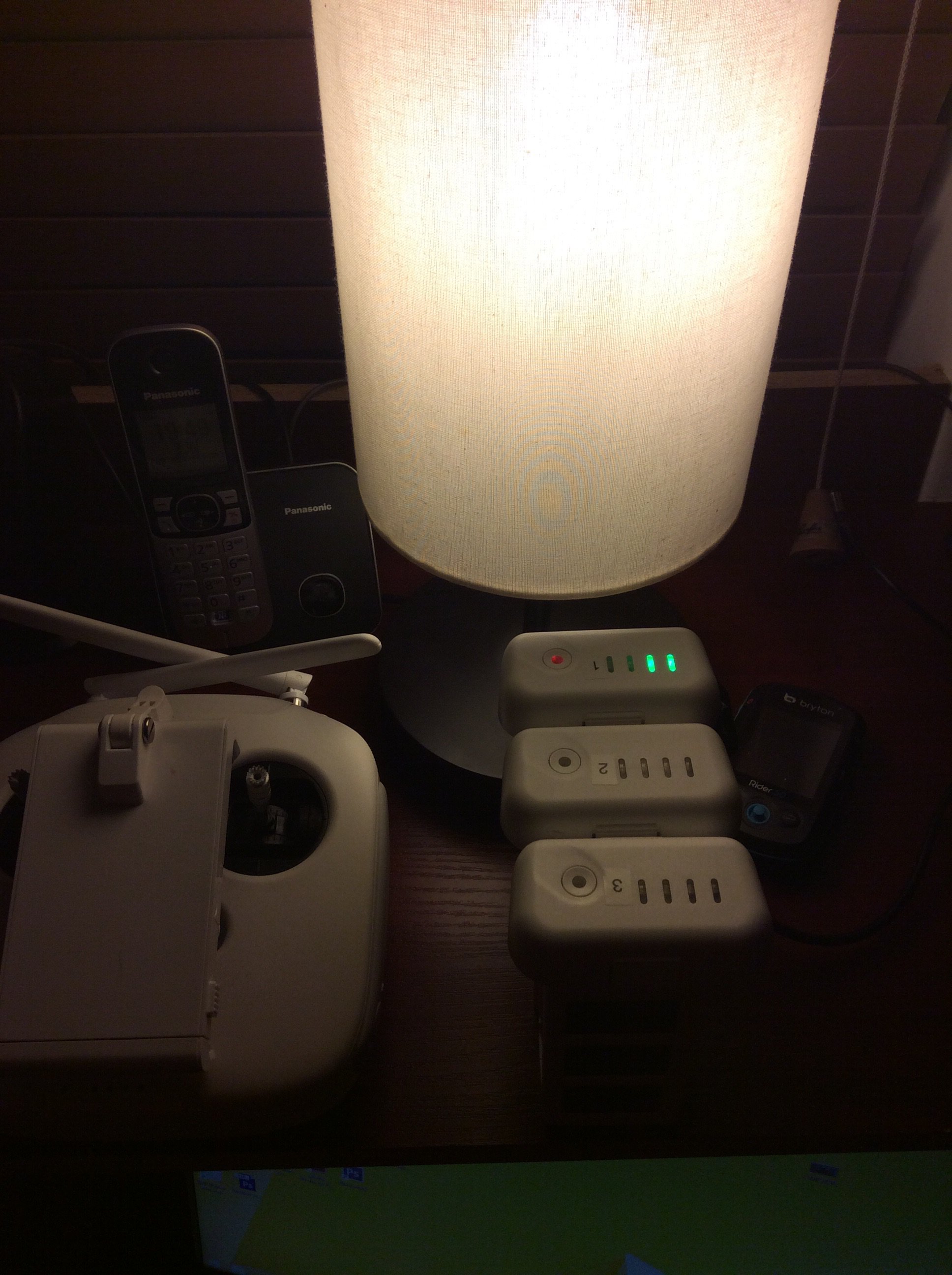

I have 4 batteries. When I finish first one - it needs like 15 min to cool down. So 4 batteries means 1 hr flying - not a "perpetual" flying. Needs to cool down or couple more batteries
Happily Picking up my four extra intelligent batteries on Monday... Oh yea!!
It's going to be so sweet to actually be able to spend some quality time in the field, instead of these short flying durations. Can hardly wait...
Charging them all with one 100w charger will be my second hobby. Fun.
I need to get some number stickers for them. Keep them rotating on a regular basis.
