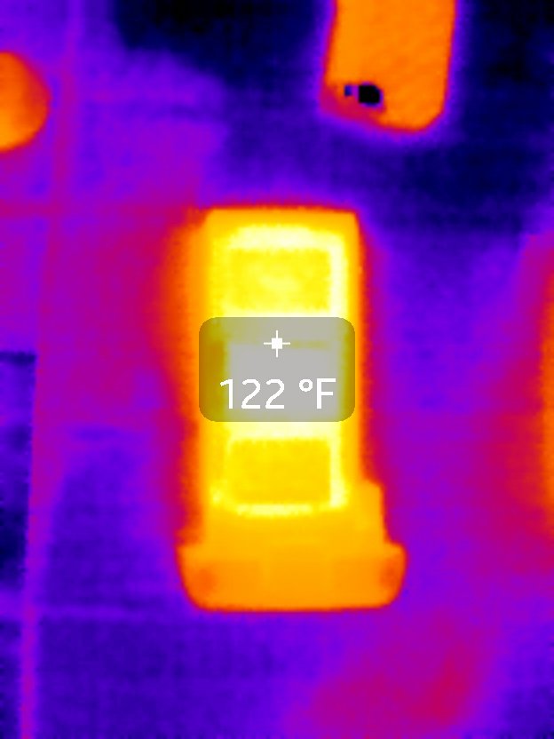

Checked out the whole thing. When you turn the battery on it will charge, regardless of temperature. Had one at 125F immediately start charging.
