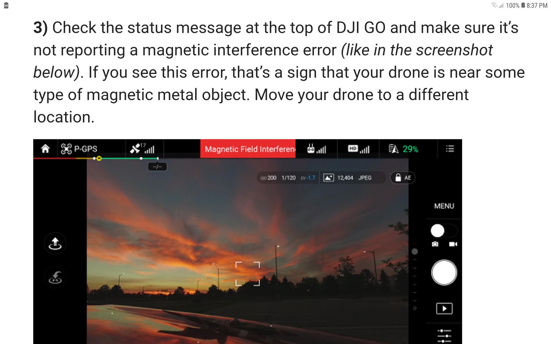

It looks like you've done the drone on the car roof test
The steel deflects the compass much more than the earth's magnetic field would and as a result, the compass warns you of a problem.
A bigger problem is when the drone is launched from close to a smaller steel item, it could just be a nail or screw in a wooden deck (if it's close enough to the compass) or something larger and further away.
It the deflection of the compass is of a similar strength to the earth's magnetic field but at a different direction, there will be no warning.
But the deflected compass reading will be used to initialise the mag_yaw values of the IMU gyro sensors.
When the drone launches and the compass is no longer affected by the steel, that's when the serious yaw error situation starts (and it usually ends badly).

Ok thank you for explaining that to me,,no not my picture(phantom help)just my example,,been driving me crazy for some reason so yes hope he comes back,,thanks again for that;)

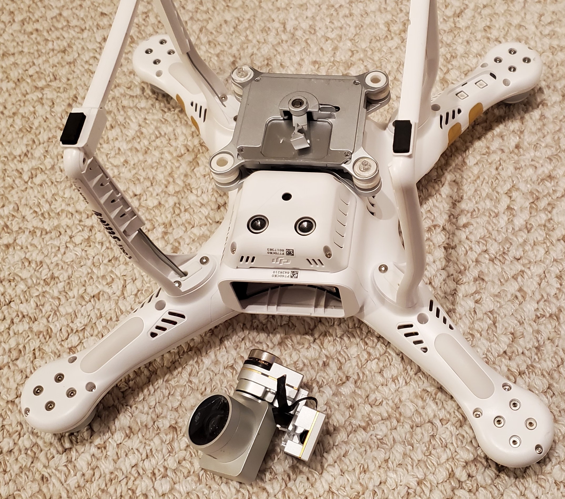

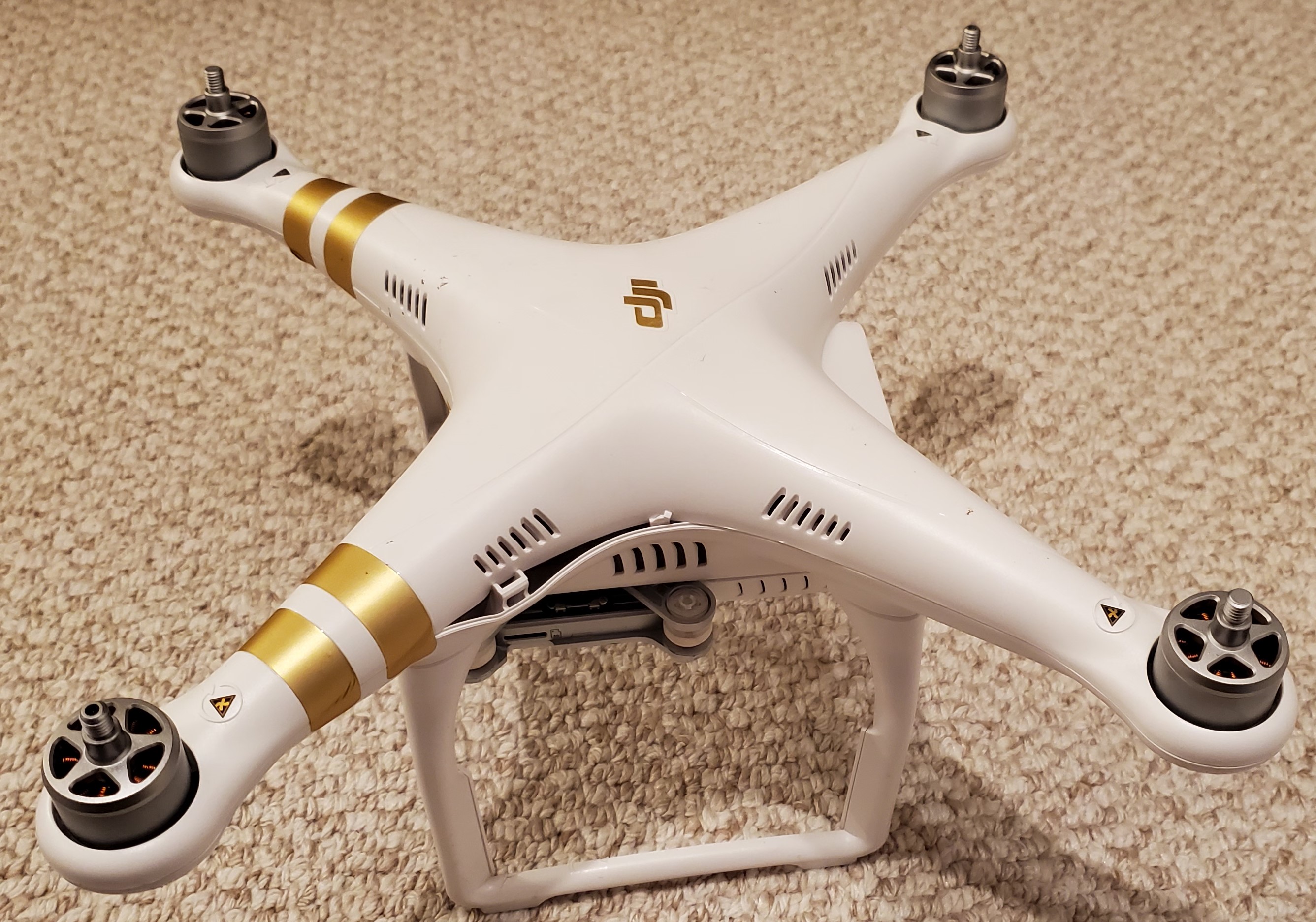

The driveway the P3P landed on was gravel, no rebar under it. Landing point was also higher then the take-off point which someone above speculated may have been the issue. The thing is that if I'm pressing down on the left stick and it senses that it's not decreasing in altitude then shouldn't it know that it's on the ground? Here are some damage photos and I'll upload the logs momentarily (reading how to do it now).
The lens from the camera is an easy replacement. I noticed one of the diffusers is gone but that's not a big deal. The ribbon cable is obviously ripped so that needs to be replaced. The part I'm most worried about is the gimbal arm, there's now friction between it and the lower silver housing so maybe the y-axis gimbal motor also needs replacement?

I landed the P3P in a few dozen feet from where it took off - on a more level part of my relatives' driveway instead of the street. As un-luck would have it, even thought it was on the ground and I was pushing down the throttle stick it initiated RTH home. I have no idea why it decided to do that when it was already on the ground for several seconds
