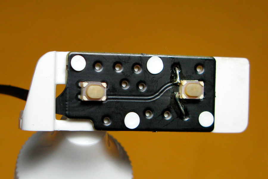

I've had my shutter button out of a P4 transmitter box. P3 might be about the same design.
The outside button itself is attached to the case on a flexible rubber piece. That rubber piece pushes on the small micro-swtich button on a screwed down circuit board where a flexible ribbon cable goes over to a connection jack on the main board and it clamps down by a flip lock like those used on the HDMI add-on unit. Could be the ribbon cable needs to be re-seated on the main board. It's only about 4-5mm wide. The "clicky part" when pressed comes from the micro-swtich part and mine had four terminals on it soldered to the circuit boar it rests on. Switch itself is about half the size of a pencil eraser and the four connections are very small too. I had to solder onto mine with a iron that has a tip about the size of a pencil lead that was meant for surface-mounted component work (Scratch brush it first, then use some flux, and then use a silver bearing solder in the smallest 30 gauge area if the connection is broken, and wash off flux with electrical cleaner.).
Photo below is the shutter switch itself and you can see where I re-soldered to it on the right. Ribbon cable exits on the left.
Good luck.
Good luck.
