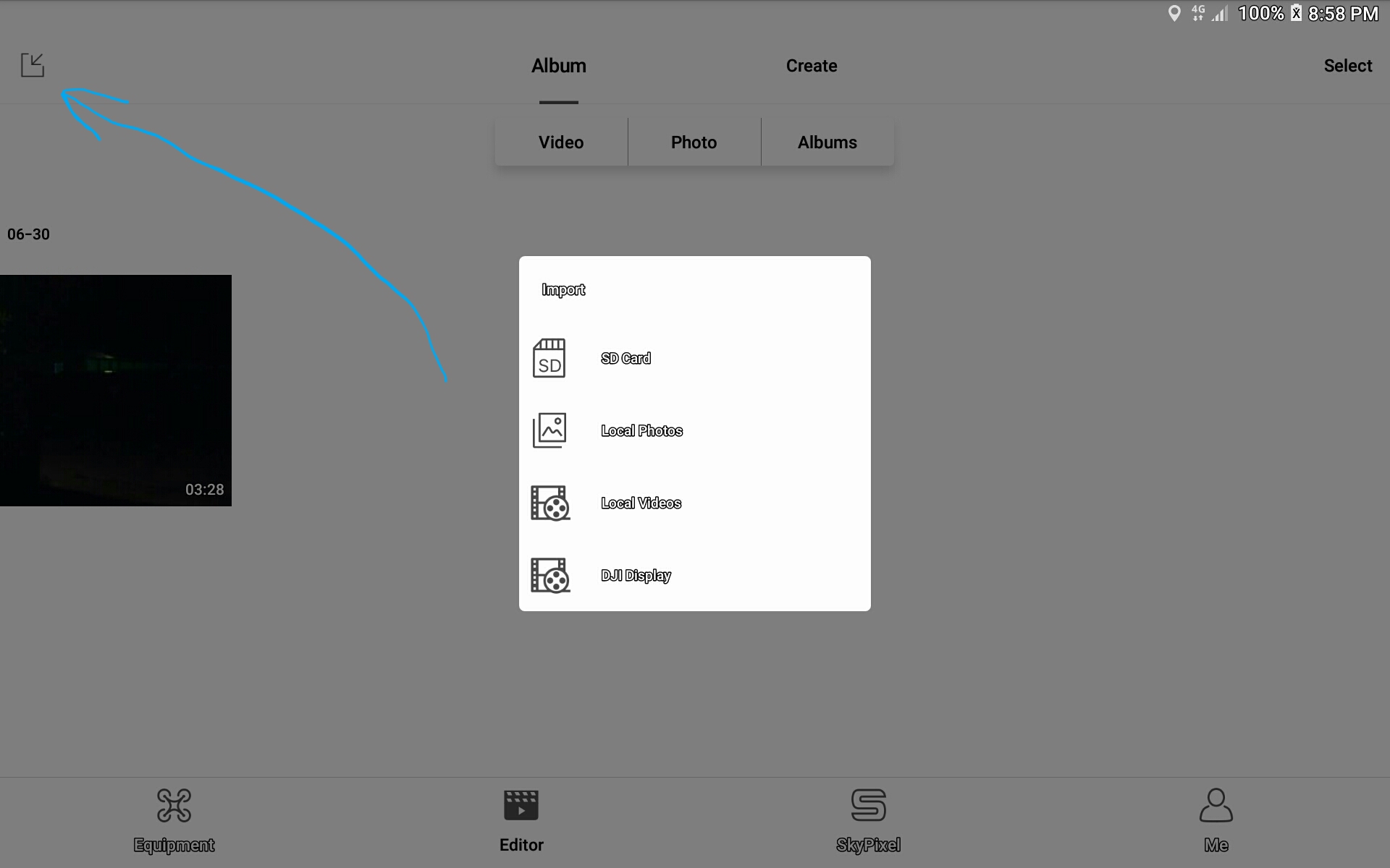

HI was just reading,I got similar issue where my photos don't go to the editor in djigo4 app,I have always had to return all back on and import them,which sounds crazy but that what I have to do,,I can live with it but I do it through here
,,my vidios go there ok but not the photos
