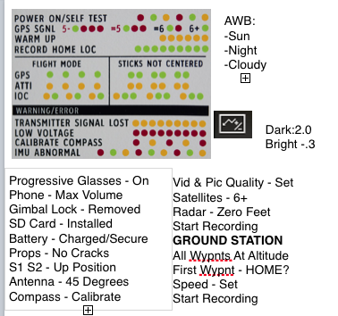

You should do many things before pressing the first button, my advice to you, is to do this every time before you pilot your P3:
No pilot, in his right mind, would ever take off without going through a preflight checklist. Start making it now. There are some examples out there. When you get your Phantom, tape your list to the back of your transmitter. I use clear packing tape (not Scotch tape). As time goes on, if you forget to do something, just add it to the list. After many revisions, here's mine:

CPhantom59,
Thank you very much. These are some of the absolutes I've been looking for. Will undoubtedly take in the manual as its revealed online and some of the flight suggestions duly noted.
