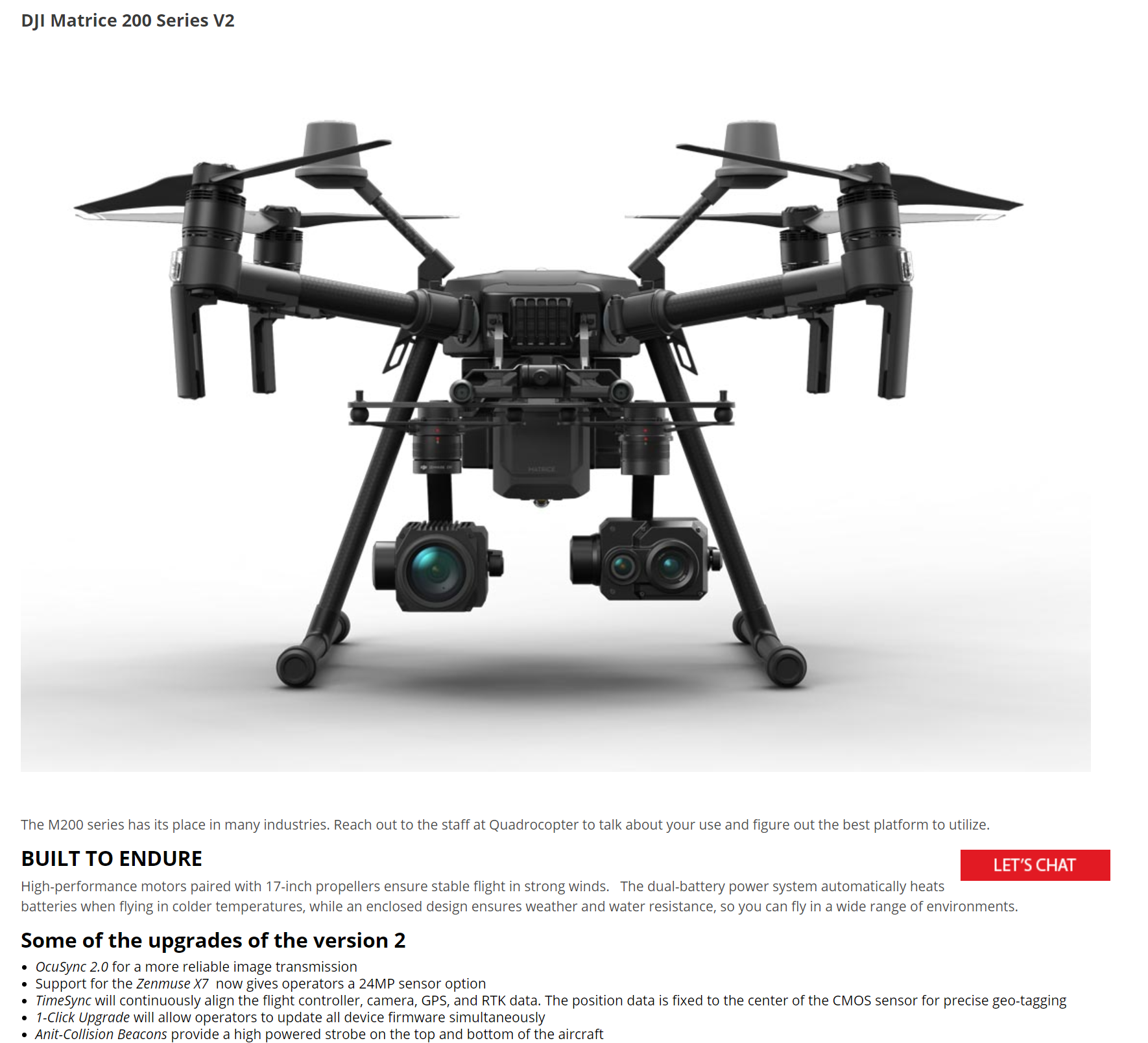

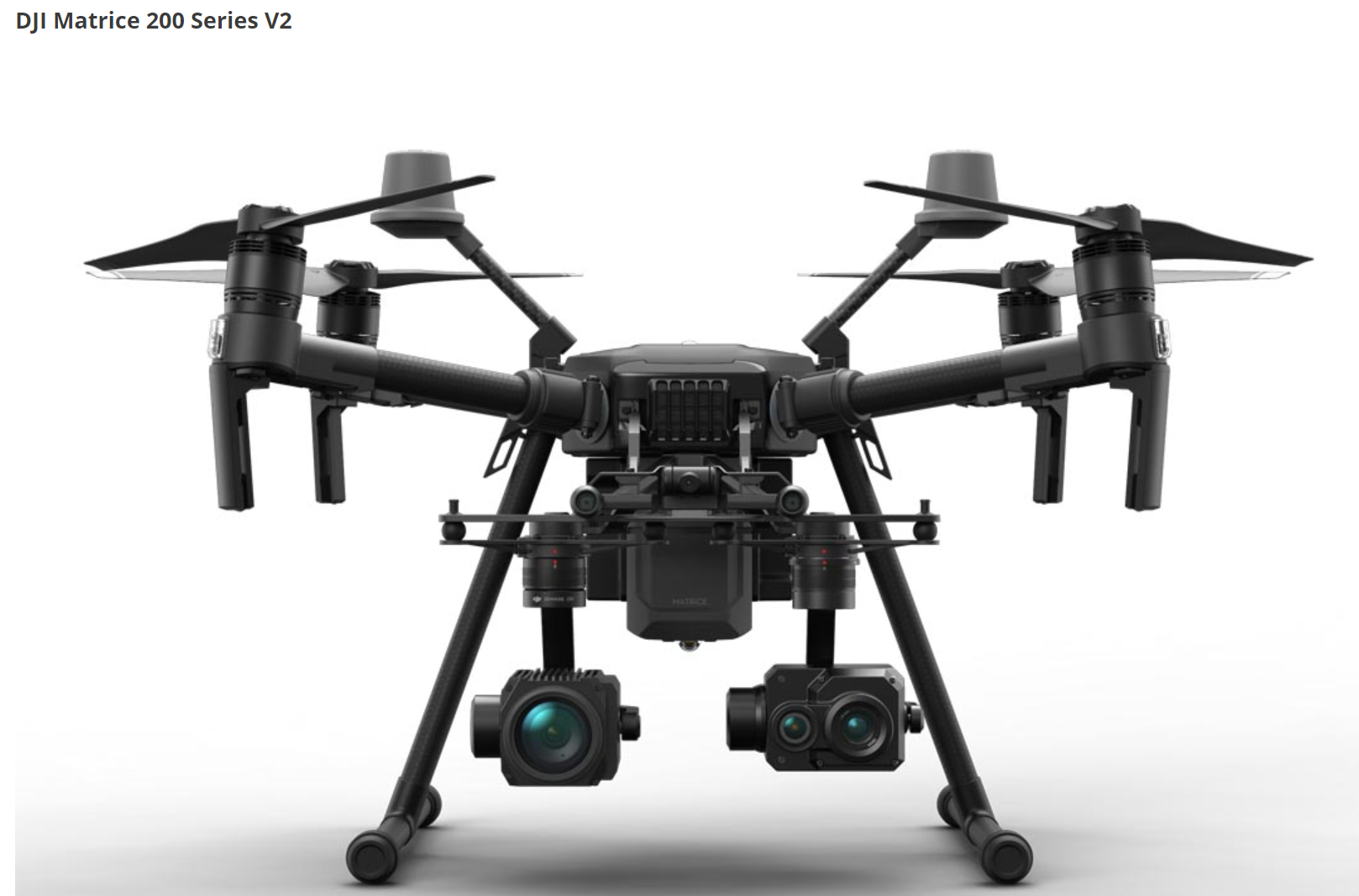

LOL your killing me, We did make our presence known in regards to making the Wet Suits for the Matrice 200 series of drones, however most People seemed to believe that these specific drones were in fact already capable of flying in the Rain so there was very little interest. It seems the same rules always apply you must protect those batteries and this might Inspire me to start making Wet Suits for these advanced units.

Technical Failure was the most likely the main reason as stated above and add to that aging batteries , but I doubt rain was part of the main equation despite the
1 incident they magnified in the rain.
