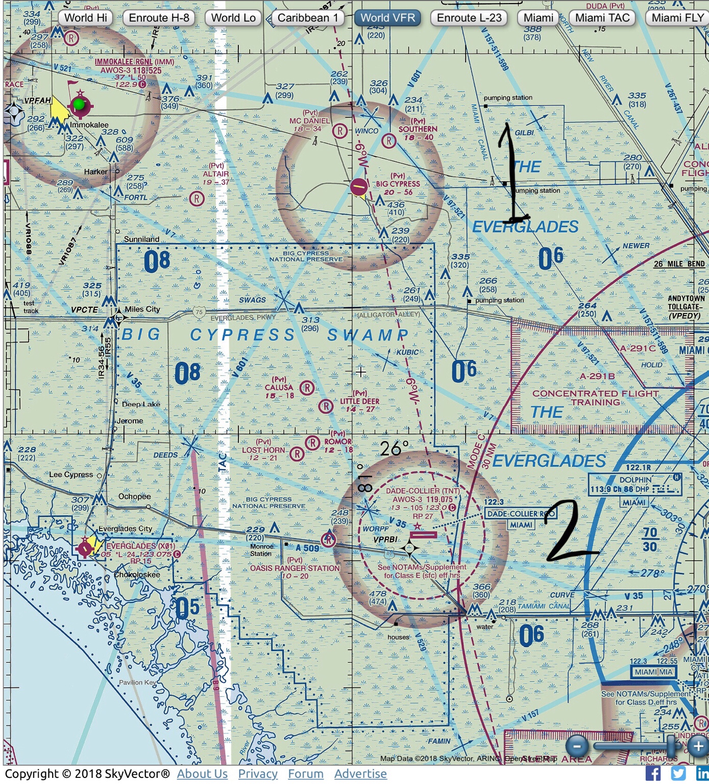

Why doesn't ALL Class E airspace extend to the surface? I am talking about the small airports, Class E, that have no dashed lines, that indicate the floor is the surface.
Class E floor starts at 700' AGL around small airports, 1200' AGL most other places, excluding B, C, E?
Below Class E is Class G, ceiling at 699' AGL or 1199' AGL depending on location?
Am I right in the fact that as 107 license holder you can fly within Class G, (under 400' AGL, or 400' above structures, obviously)???
This sounds stupid, does that mean I can just fly my UAV directly over the airport, staying under 400' AGL? Surely not, but I can't find anything that says otherwise.
Maybe there is something I have missed in all of the FAA alphabet soup I have been studying.
Please help me understand.... Thanks.
Airports that have no control tower are colored in magenta. Airport #1 Big Cypress has class G surface up to 699 ft class E starts at 700 within the magenta shading around airport. Outside of the magenta shading the class E starts at 1200 ft. In Airport #2 Dade Collier, the dashed magenta indicates class E starts at surface and on outside of dashed magenta line class E starts at 700 ft up to the magenta shading and outside of magenta shading class E starts at 1200 ft.

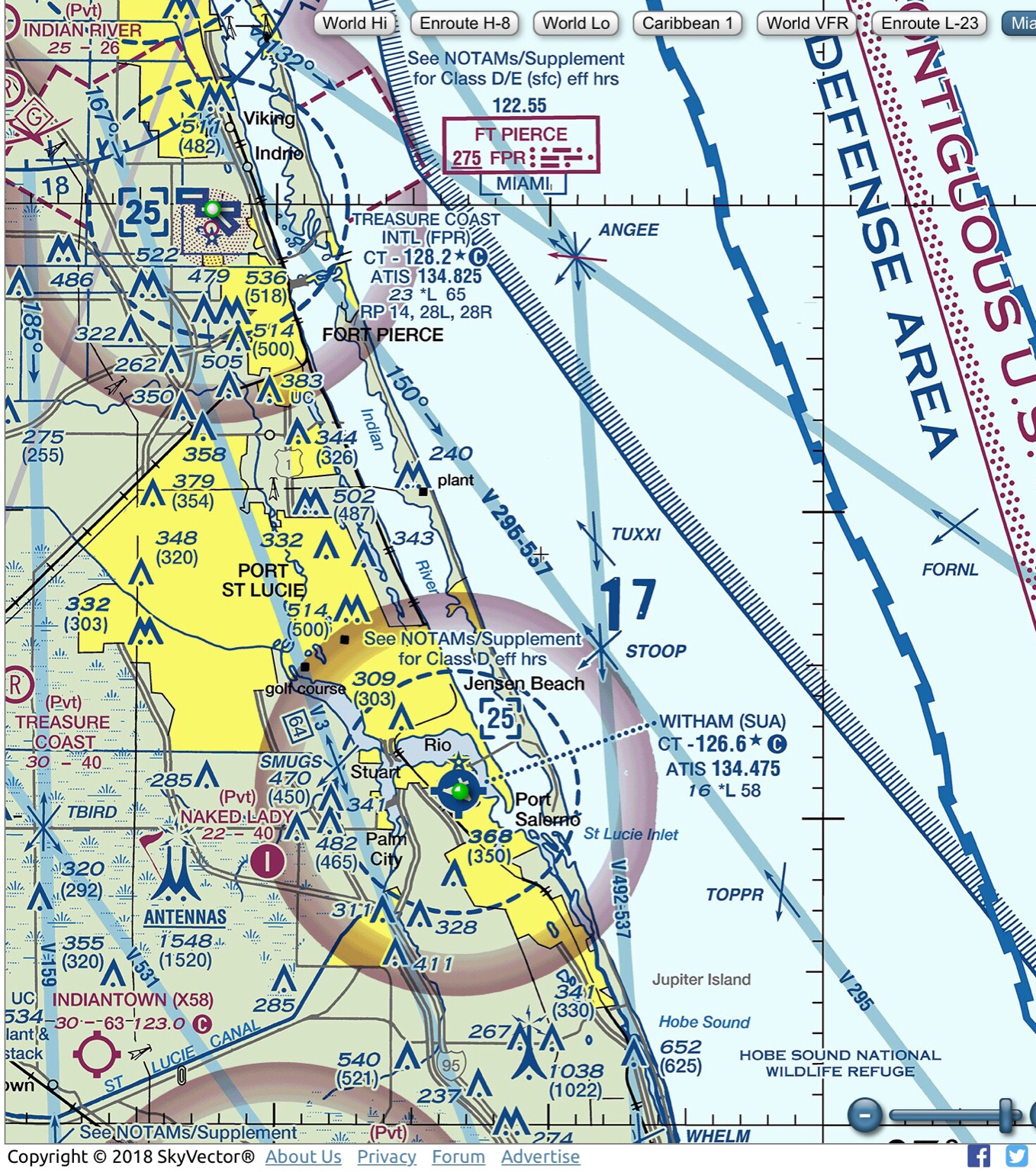

In Witham you have dashed blue line indicating class D airspace from surface, outside of dashed blue line you have class E starting at 700ft to the magenta shading, outside of magenta shading class E starts at 1200 ft.

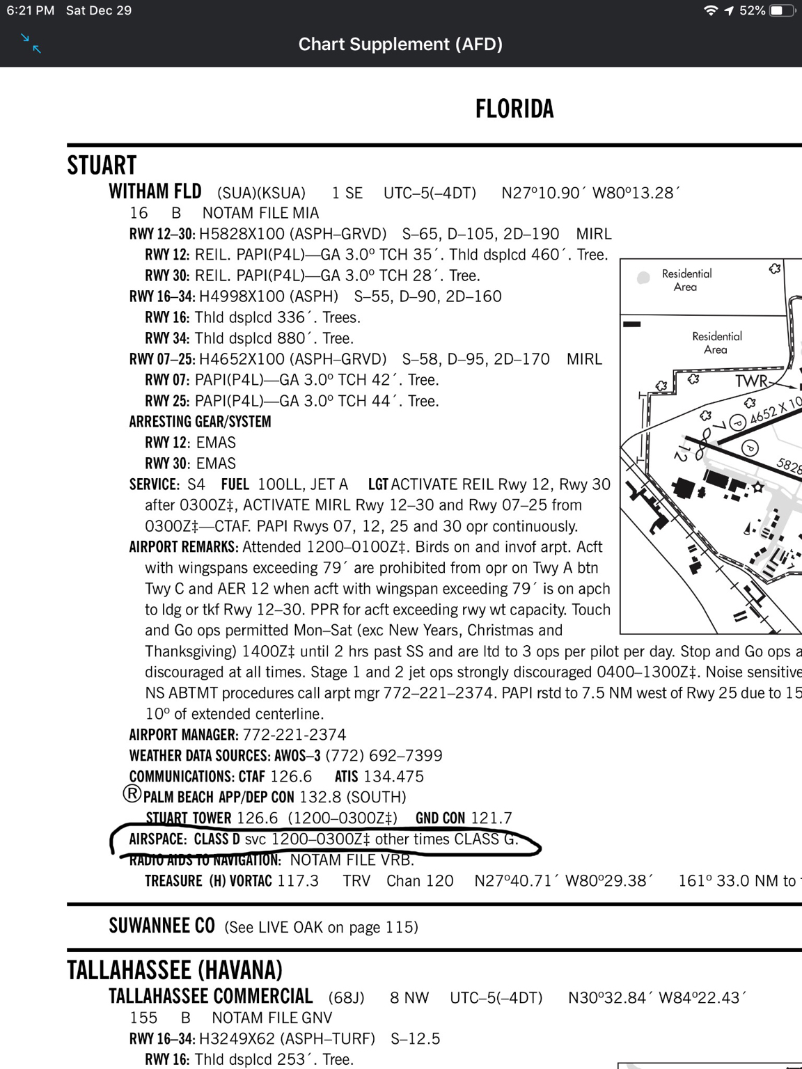

Class D airspace is part time as opposed to 24 hrs, so when the tower closes class D airspace turns either class E surface within the dashed line or class G surface within the dashed lines. Whitham in this example turns into class G surface within the blue dashed line.
To check airports in your area you can get this app ‎Airport Facility Dir -PilotPal
