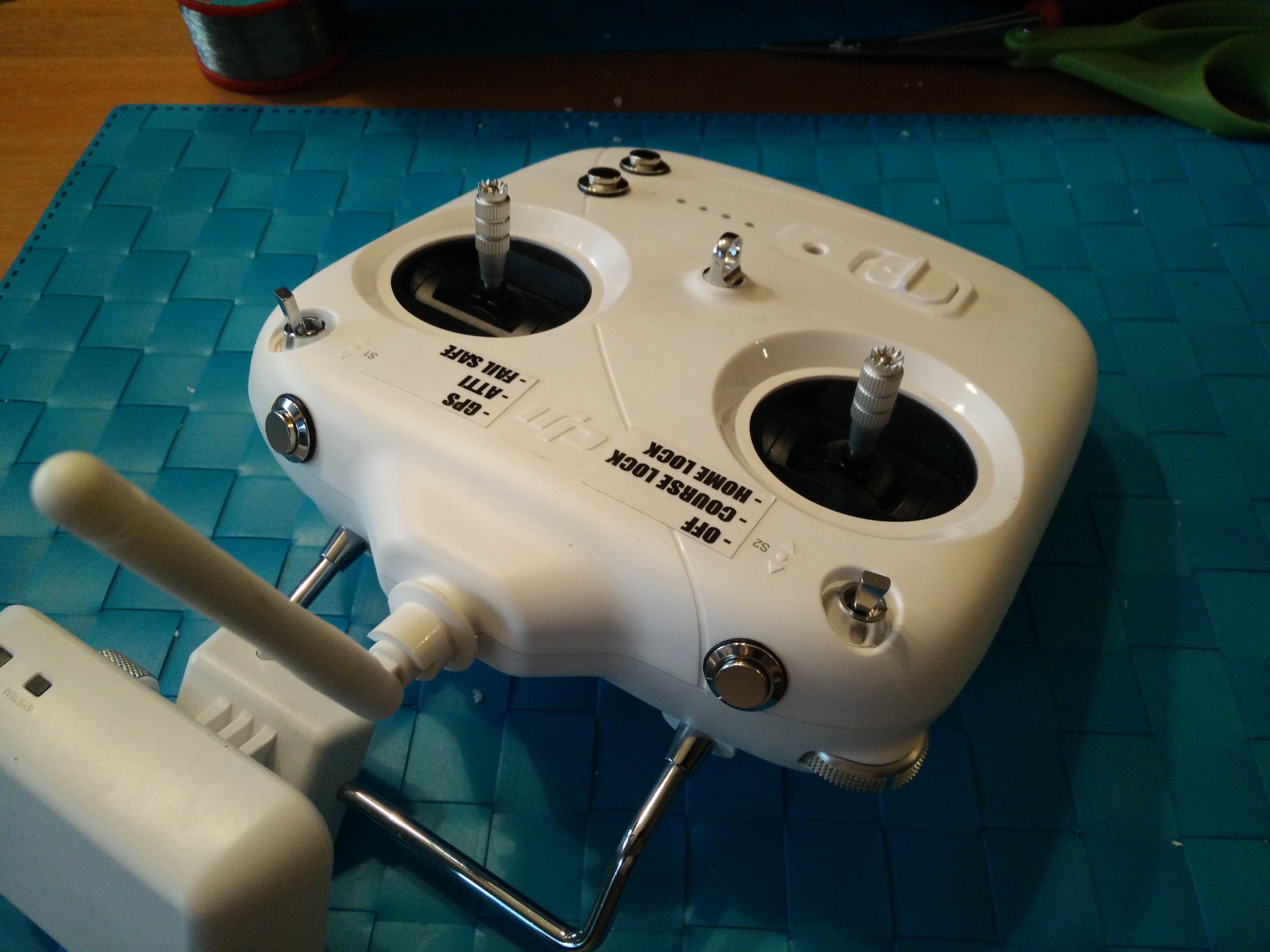

Had some spare time past weekend so I gave it a shot, this is the end result:
Works great, except for the screenshot action.
I don't think that app is supported by my ROM, and neither is any other screenshotapp with an overlay icon feature.
The workaround is a macrofunction app that performs several actions in one step when the button is pressed.
Thank you for the awesome idea @DBS!

Yes it doesn't really show that much on the outside, does it? That's why I guess I went a little overboard on the exterior [emoji15]
I guess we have the same good taste then! [emoji1]
Next project will be going for that range so I can compete with you guys!
And now I know who I'm gonna reach out to for that extra length of range and ideas! :P
