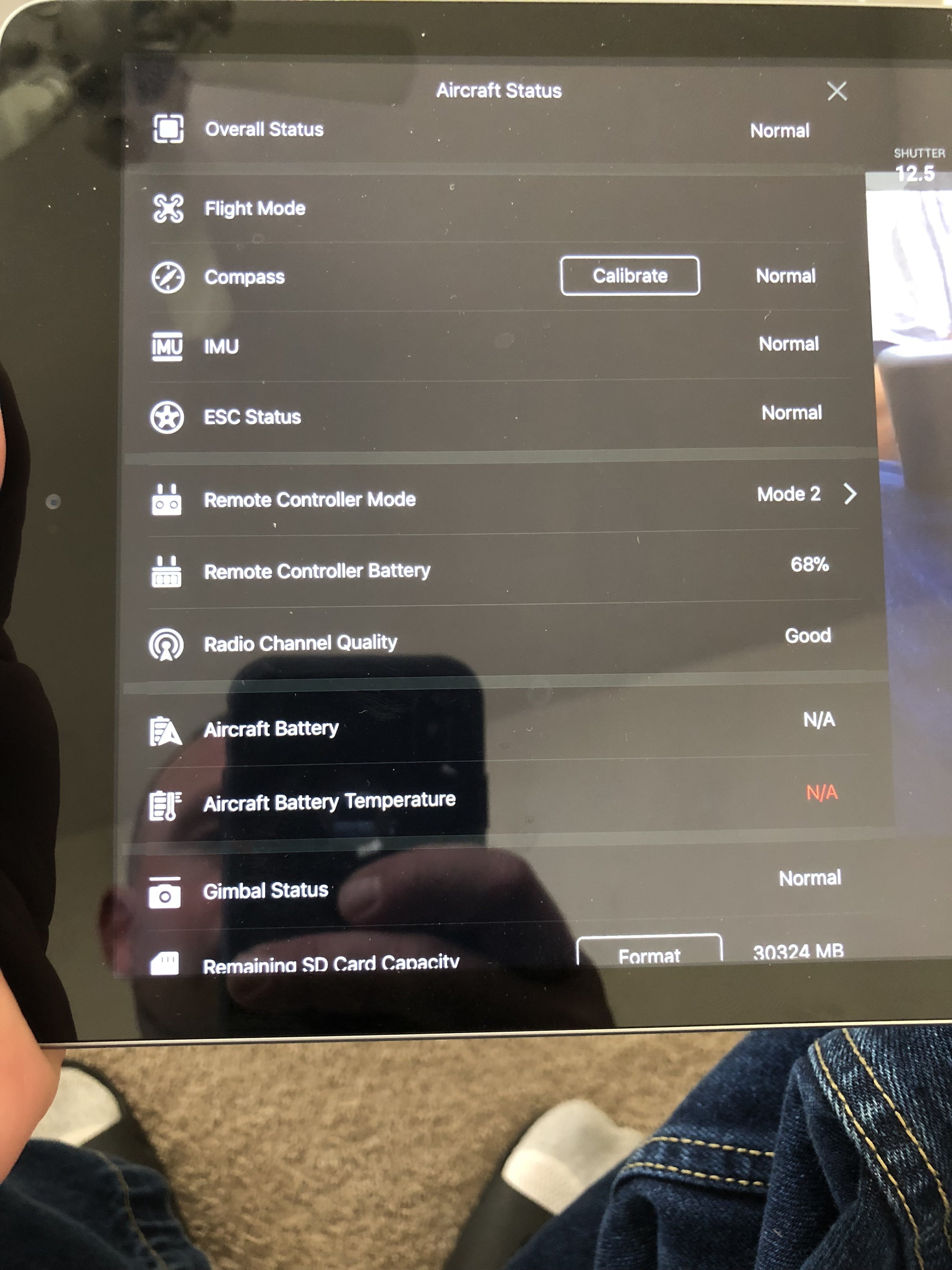

New here and new to the phantom drones. I bought it used for $80 just the drone. Bought a battery and charger for $50 and a controller for $40. Got it all set up and linked and firmware updated. Upon turning it on, it makes the initial start up noise, and gimble does it’s thing. Then no nothing from the drone. The gimble light is solid green but beeps 2 beeps continuously. App says everything is good, but try auto takeoff and nothing. Gimble will calibrate, but when I try to calibrate the compass or imu it says disconnected. Any suggestions would be greatly appreciated.
Here’s a photo of the app. Tried to upload an 8 sec vid of the drone but it said file was too large

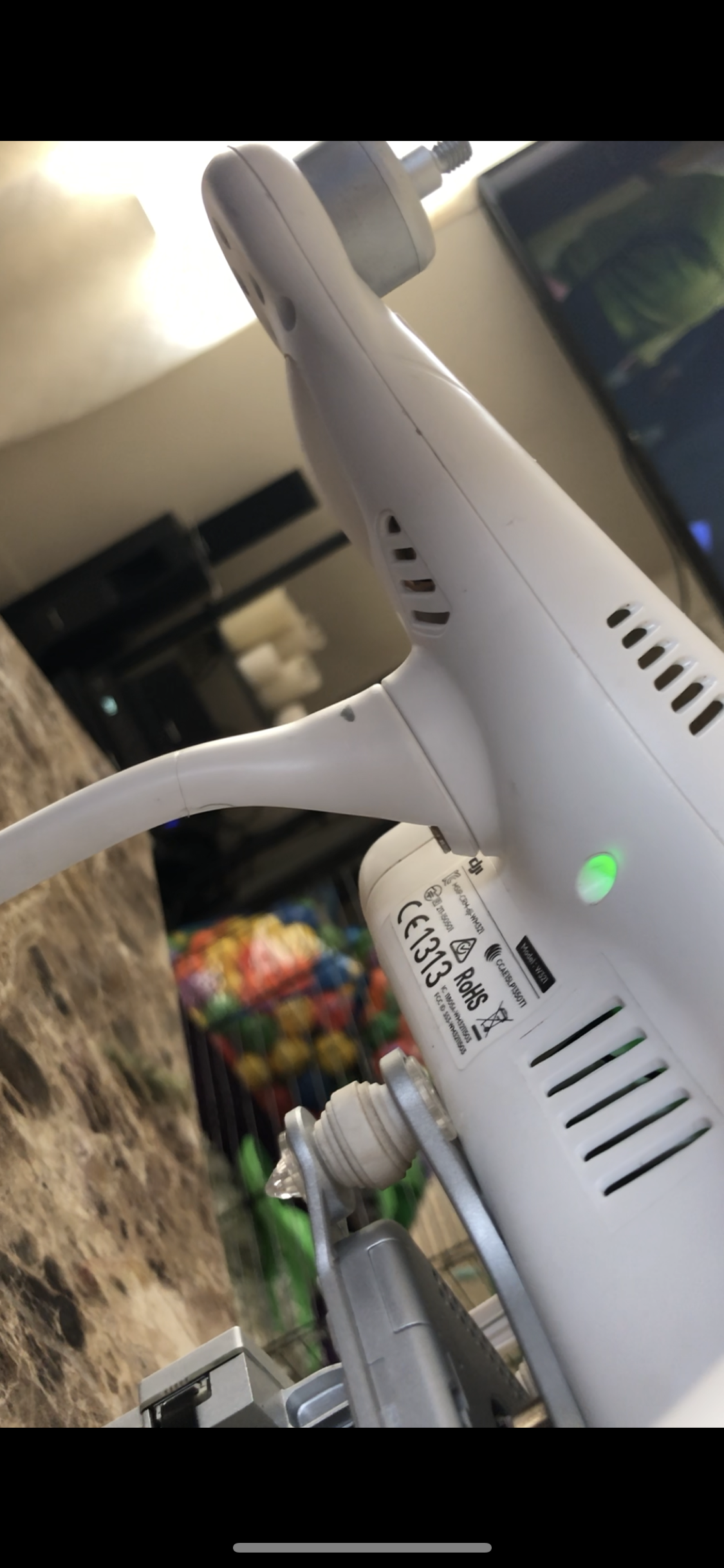

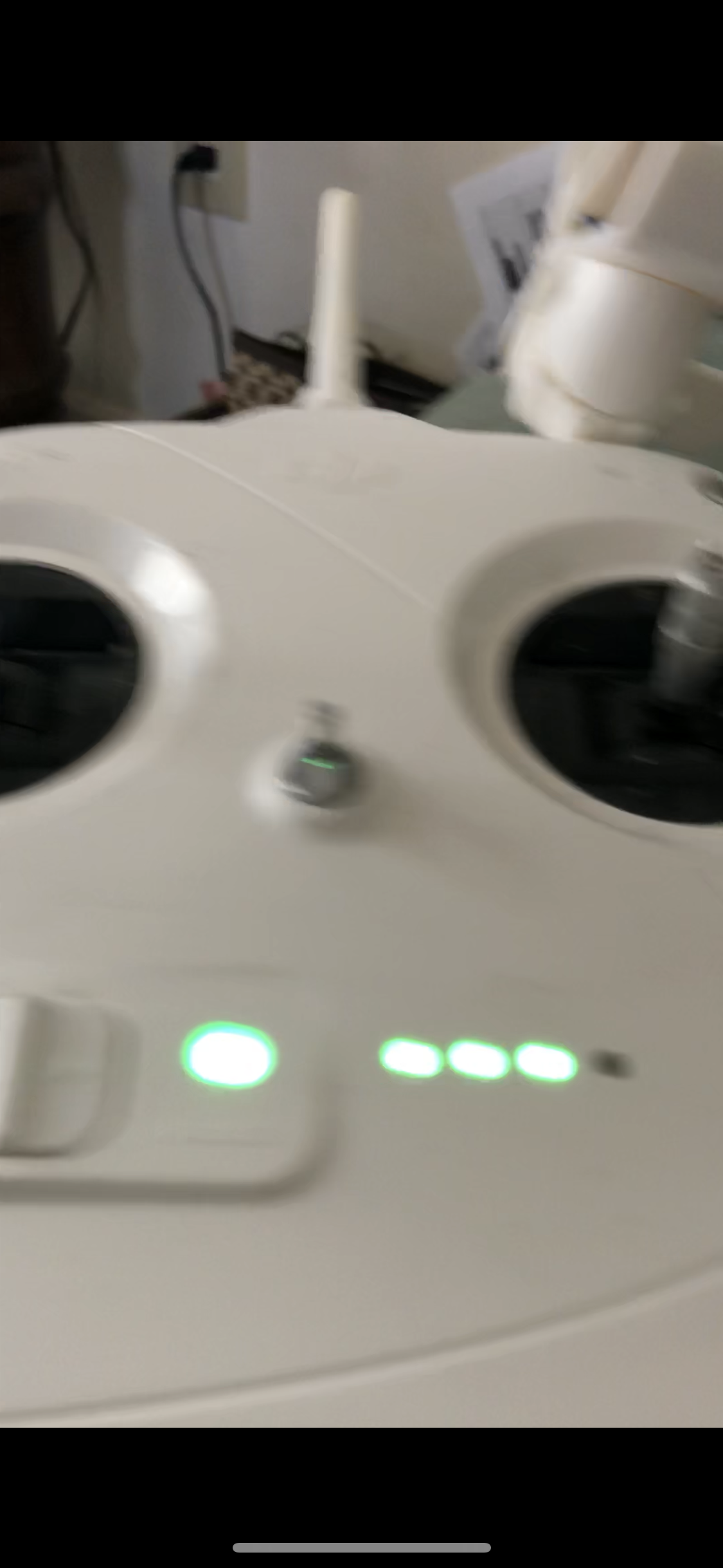

Status light on the controller is solid green as well as the link light on the drone and gimble. The leds do nothing on the drone arms.
Never?, these are the lights on the rear where you can see the battery.
They should always be doing something when its powered on.
The fronts should be solid red, but they can be turned off.

They do nothing ever. I get an image on the app and the gimble moves if I pick the drone up and move it around. The app says connected and ready. Is it possible someone may have taken the guts out? Would the gimble and camera still work if they did?

App says connected and ready. "Ready to Fly" ?
Does the app show number of satellites?
Have you tried a normal start motors with the sticks? Make sure you have the props off. :eek:
Rod
Not on my iPad or iPhone. It says connected on the home screen, but when I go into the flight screen it says diconnected in red at the top left, but camera and everything still works. Which I read that there were issues with the app and Apple products. On my wife’s galaxy it says connected in green and everything looks just like when I fly my spark. But when I do auto take off, it does nothing and gives a warning. I don’t have props on it. The controller doesn’t make it do anything either

Both lights being green Phantom, Remote and even on the gimbal, and it don't work?

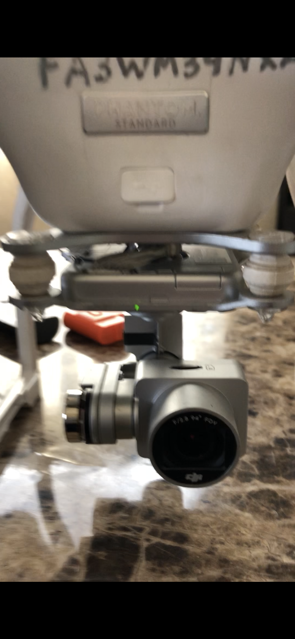

The spark has lights, I was using the flight stays of the app for reference. All three of the lights are solid green. No lights whatsoever on the drone though. And the gimble beeps 2 beeps constantly. I know the beeps aren’t from the drone because the drone makes a much louder sound on startup
Does it make four different beeps on start up? That is each motor (self check).
Other beeps come from gimbal / camera.
