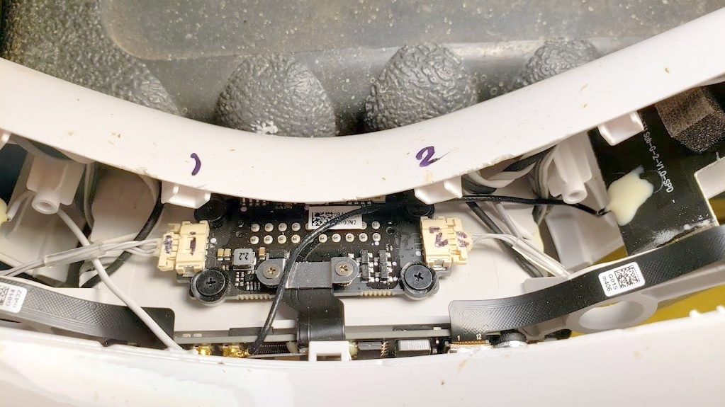

Trying to replace bottom shell on my P4P but cannot figure out how to disconnect the 4wire sensor connectors labeled 1 and 2 on the picture. They don't come apart easily with moderate pressue. what is the trick?
I just replaced both top an bottom. Gently pry with a small flat screwdriver a little back an fourth on each side.
Use tweezers clamp both spots.and jiggle it out. Very brittle these connectors
