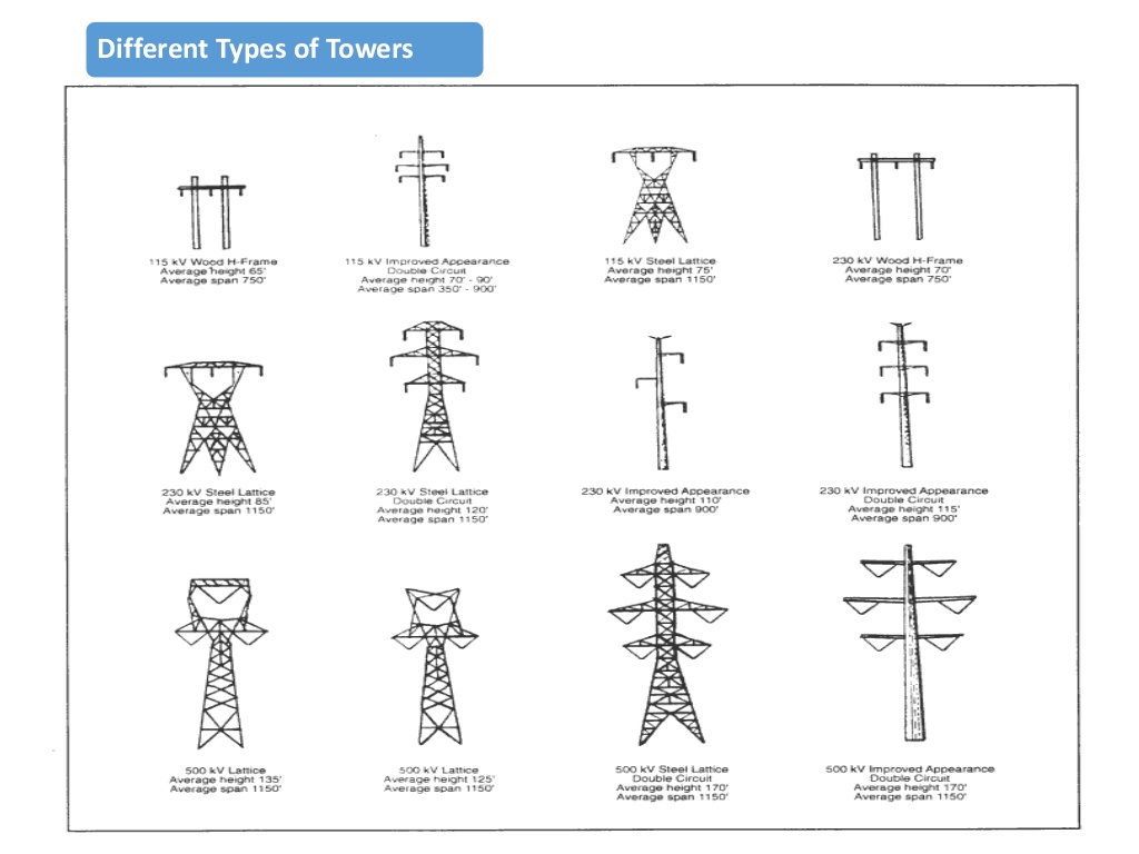

I've flown 160' from a transmission tower (first image) and had zero issues.

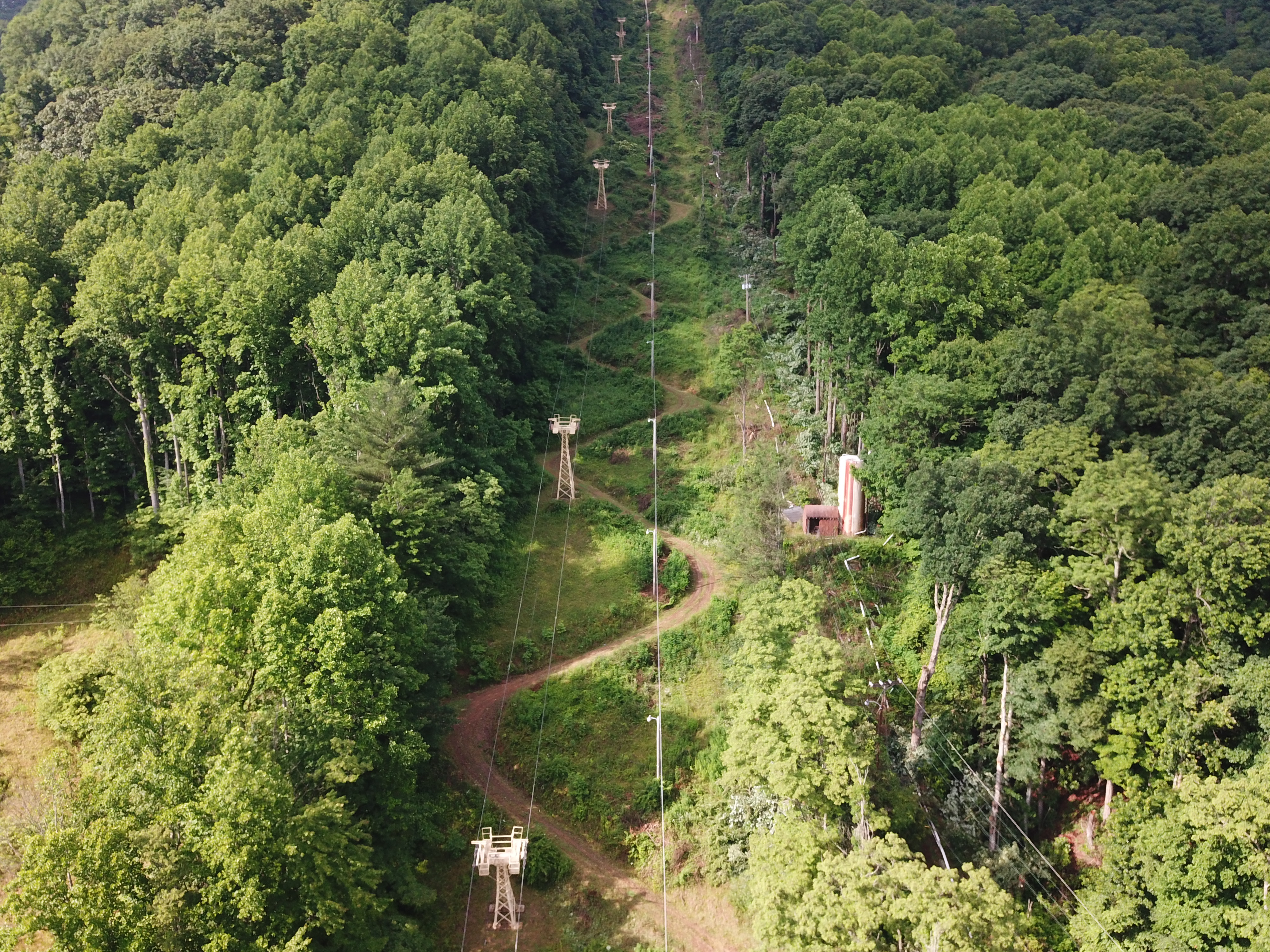

We flew a Powerline Inspection for a client this weekend and flew directly over the lines at about 20' up a mountain for about 1.5 miles. The client is needing to get pictures and video of each tower, pole, connection and the access road that switches back & forth up and down the mountain. (see attached)
On the right side was the transmission lines supplying power from the base of the mountain up to the amusement park at the top. Up the center of the lane was simple "illumination" wiring going from one light post to another. On the far left are chairlift towers that we documented but they are off-topic for this thread since they carry no current what so ever.
Absolutely zero interference to our DJI Mavic Platinum after 3+ hours of close flying.
