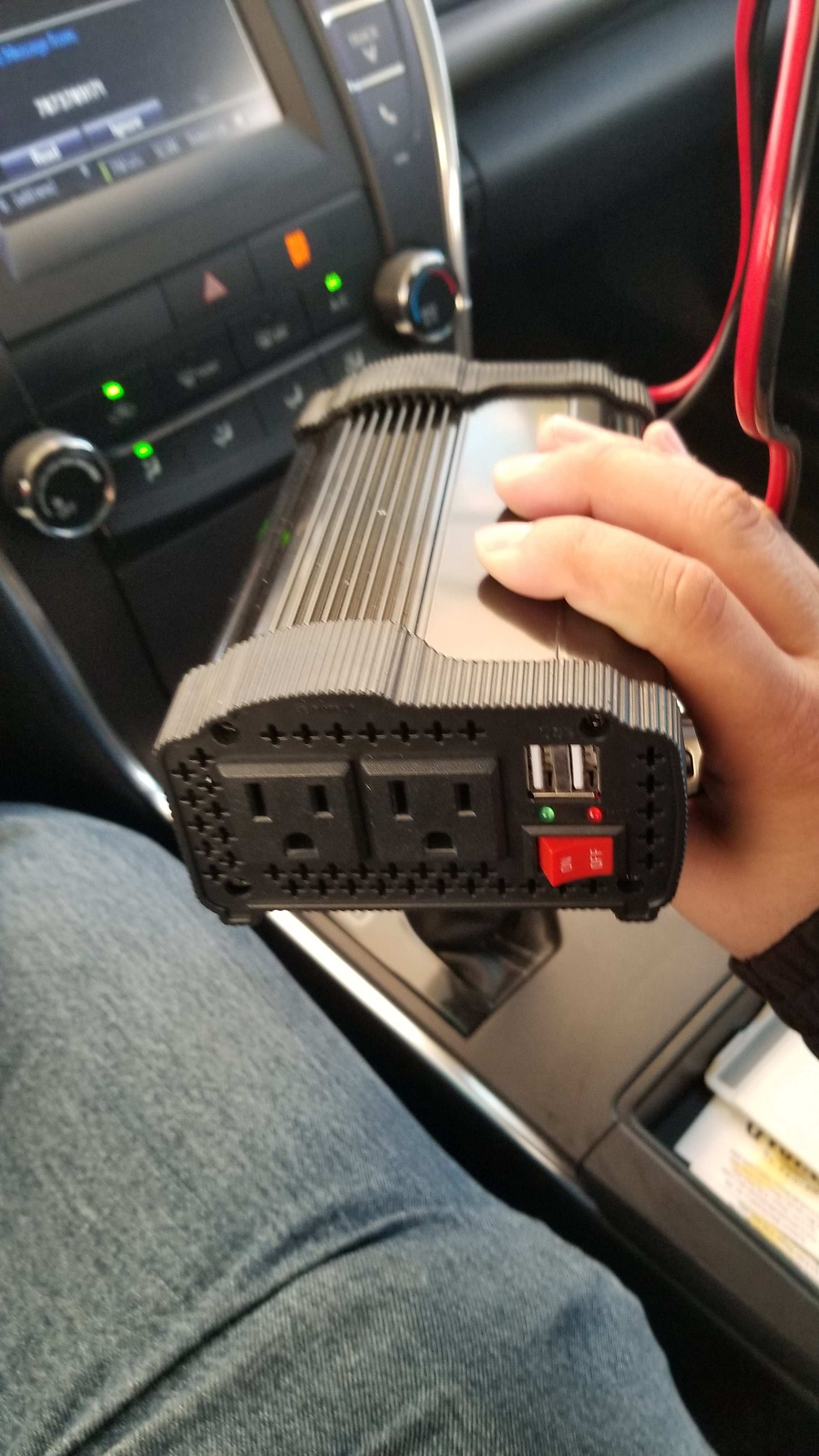

I use a 400w power inverter. You can only draw 150w from the car lighter, if you want more, you have to connect it directly to the battery.
Reactions: White Shadow

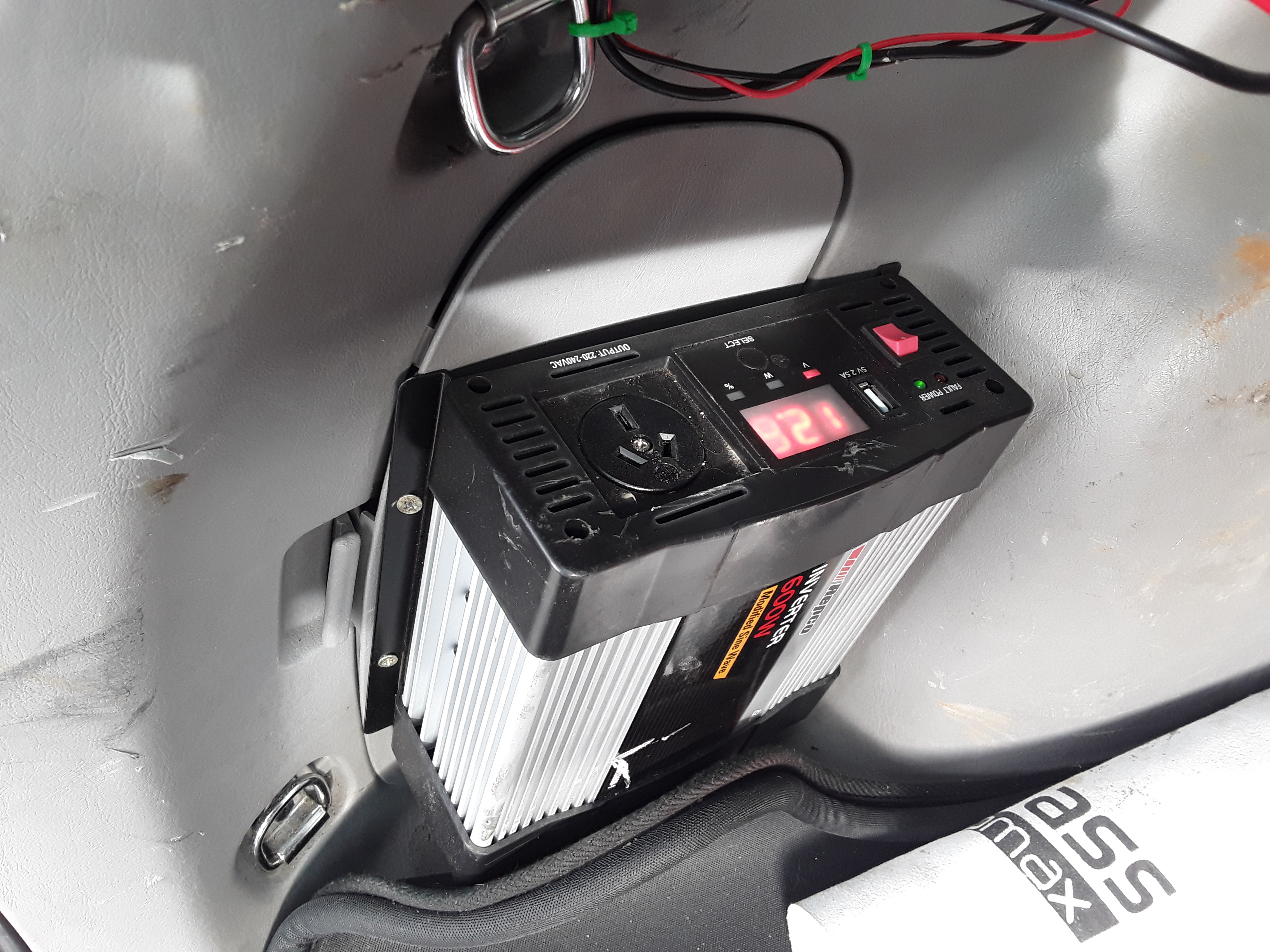

I use this one 600w ,,direct to battery (visible wires for car cam) this works good for me,I only charge while driving as to not kill me car battery,boils the jug,runs tv for my viewing my drone in flight,32".good investment

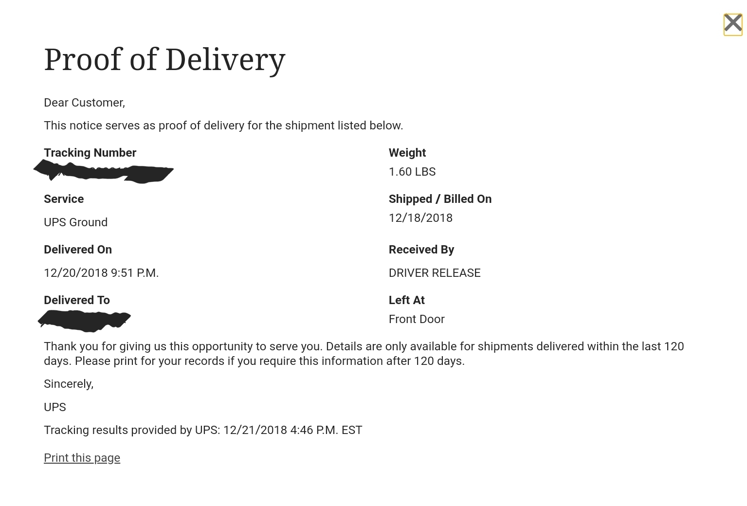

I'm confused. You said that your security footage shows that FEDEX never arrived. If that is so, then the package never made it to your porch. FEDEX probably dropped it at the wrong house and the guy kept the package. What does the tracking history show when you look it up on FEDEX's webpage? I paid for a package with signature required from UPS. Got it last night, but the driver did not get anyone's signature. Here is what the webpage shows. I got my package, but I plan on letting hell loose for this mishap. What if it gotten stolen? Who would have reimbursed me? Heck no!
