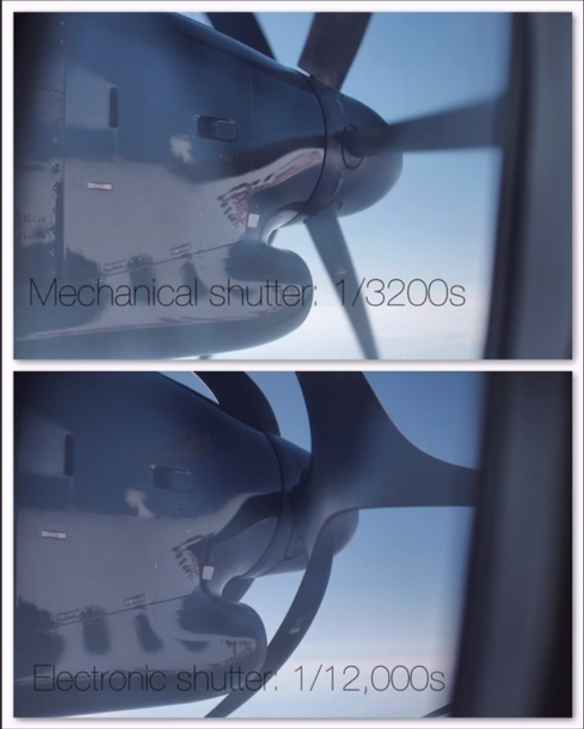

Here is a great example of an electronic shutter vs. a mechanical one:
As you can see, the bottom image barely even looks like a propeller. It's very distorted. Conversely, the top image is CLEARLY a propeller. Now imagine trying to stitch together 500 photos, all with distortion in them. Can you say, "Nightmare?"
