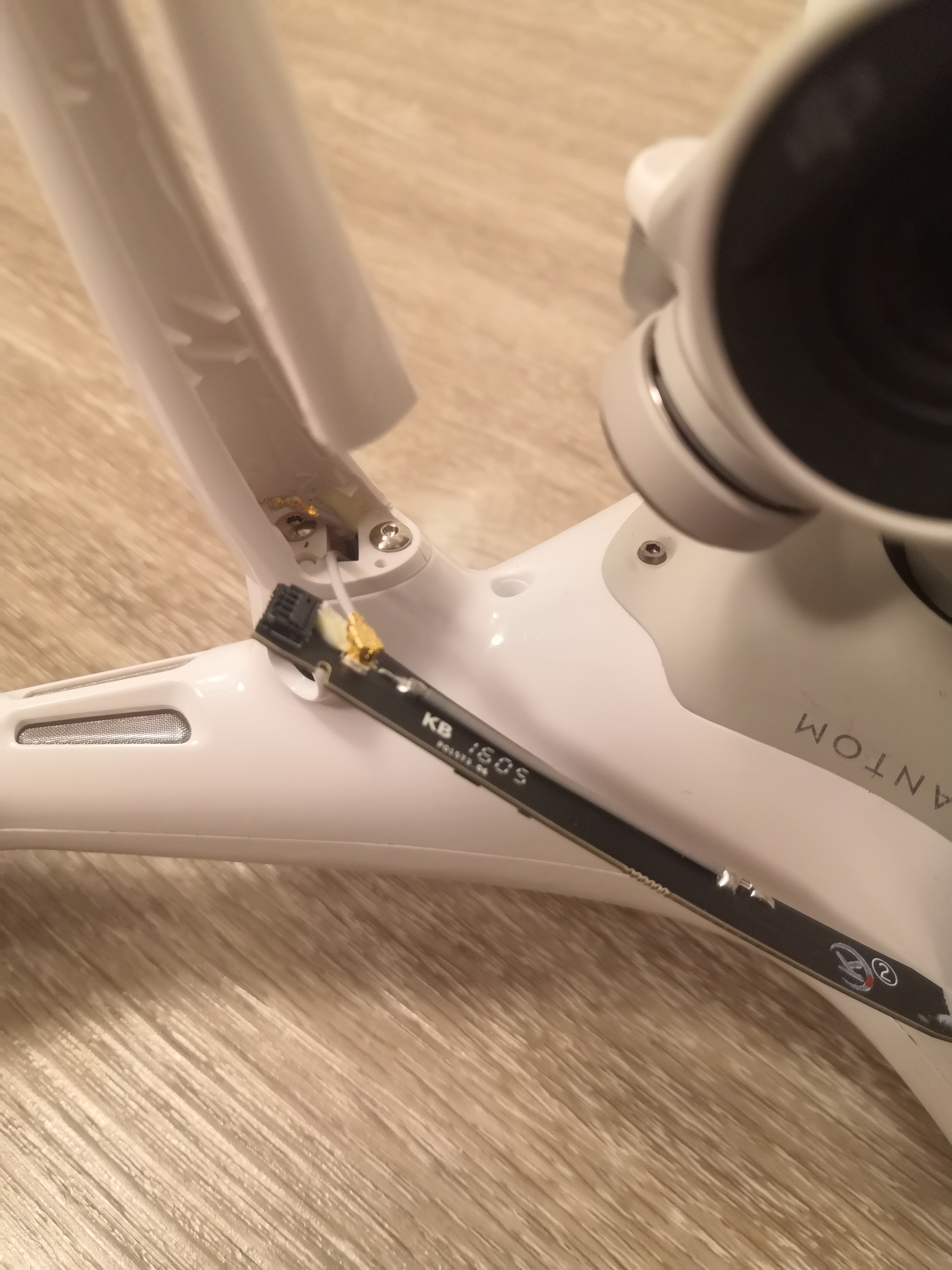

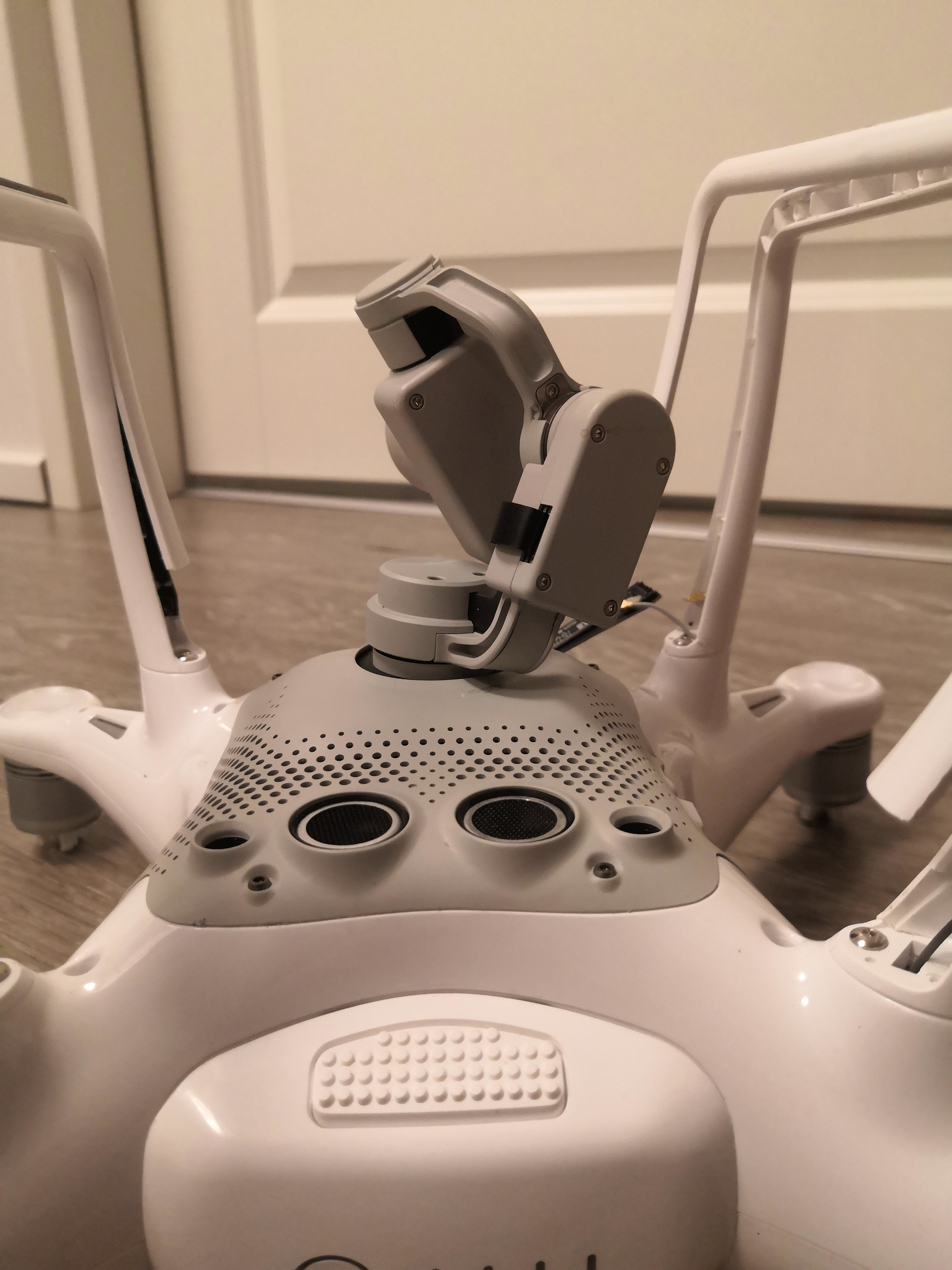

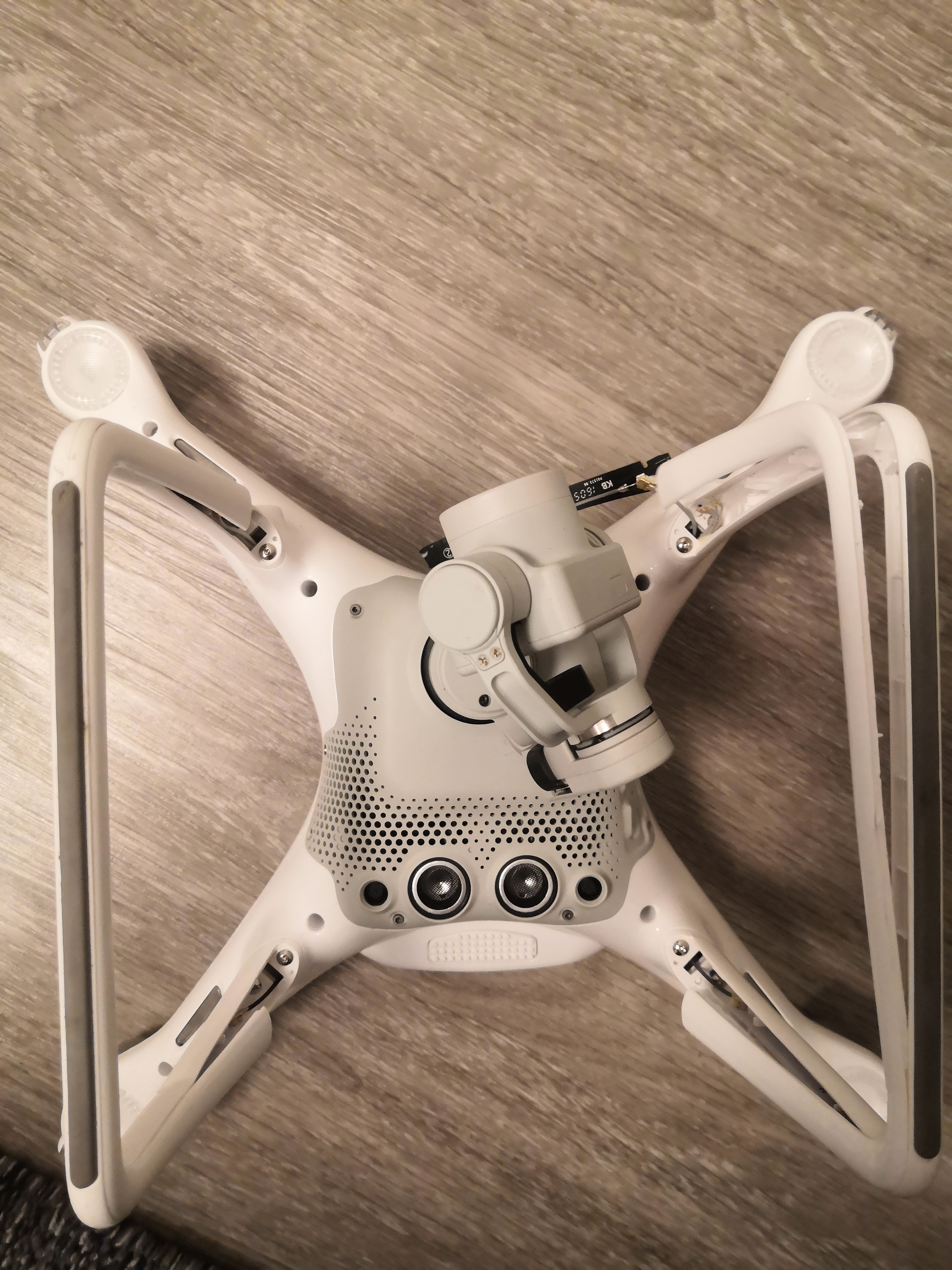

Hello everybody, Im finnish so first I have to apologize my english.
I buyed Phantom 4 used and it have been crashed from 5meters to ground. It was drones first flight and last. I buyed this drone for 50euros=55$.
I dont know what to do first. Where I gonna start to repair.
Here in Finland isnt spare parts, so I looked on ebay and aliexpress but I dont know right parts. Landing gear and yaw arm is for sure what I need.
Drone blinks Red Light and controller blinks Green Light. No link. I looked on YouTube.
Gimbal turns around at start and heats lot of back of yaw arms cover.
Gimbal moves left to right and up and down with fingers, dont need to use any force.
Wire on landing gear has been broken.
If you guys can help, ill be happy.

What is inside of landing gear? Compass? In another leg is wire cut of, Is this reason why I dont get link to drone?

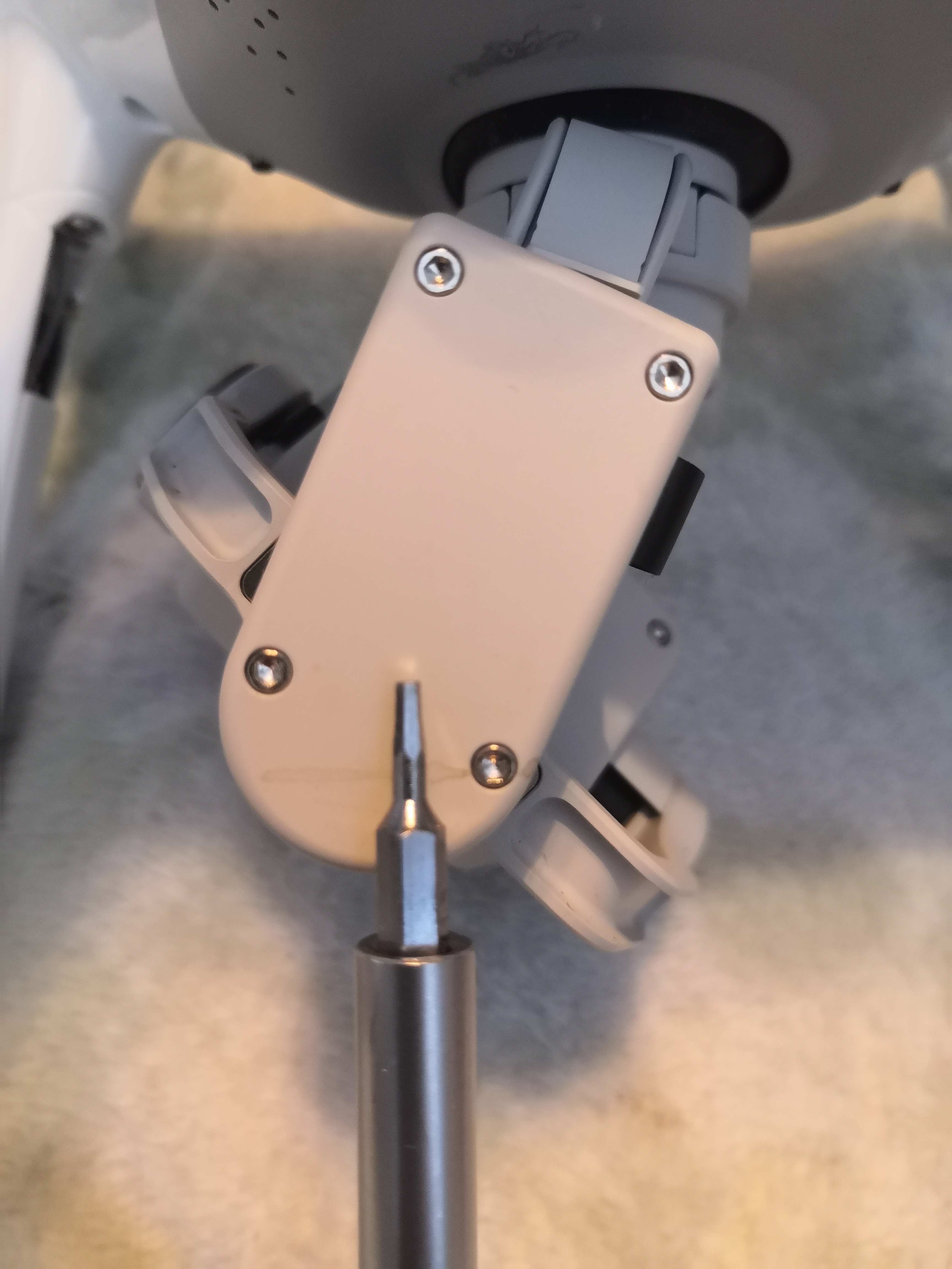

When I power ph4 on table, its get warmer/heat in that place where screwdriver is.
Is that normal?
Yaw arm is wrong position is that causing this warm up? Roll motor is doing stabiliation hole time.

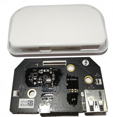

I have made several things to get image on my dji go 4 app. But always disconnected. 3 different usb cables, another Phone and New app. No, always disconnected, remote charges both phones. Is my usb board on remote malfunctioning?
Remote appears on win10, when I plug RC to my laptops usb port.

I ordered two usb board, from china and russia. I cant get connection remote to app, always disconnected. No I must wait for parts.

Yesterday I got new usb-board from Russia and same thing, "disconnected".

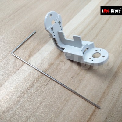

First Yaw motor was broken when it came, so ihot store sended me new one. Firsts delivery time was 44 days. So I fly now with broken yaw motor.

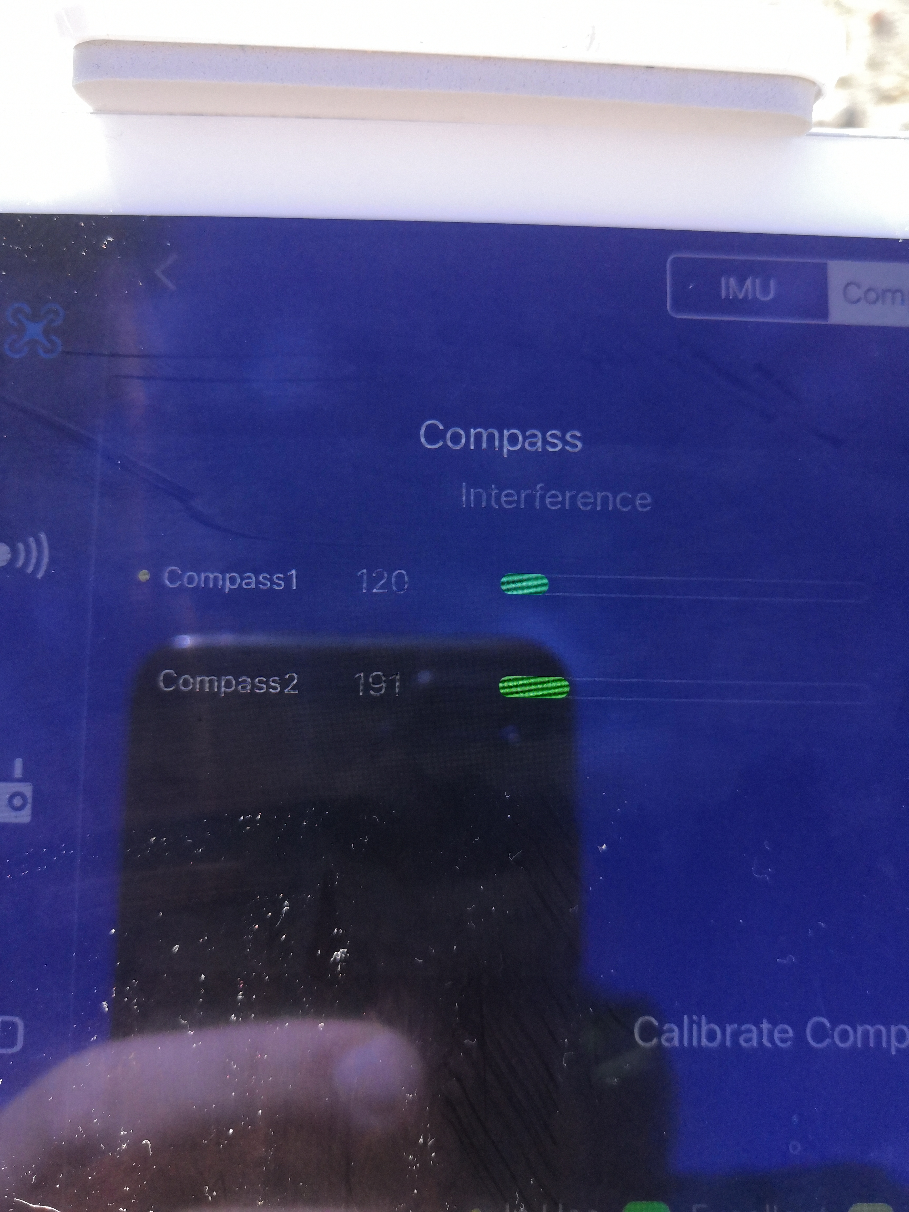

Combass error. I cant calibrate it.
Is this because I have broken yaw motor?

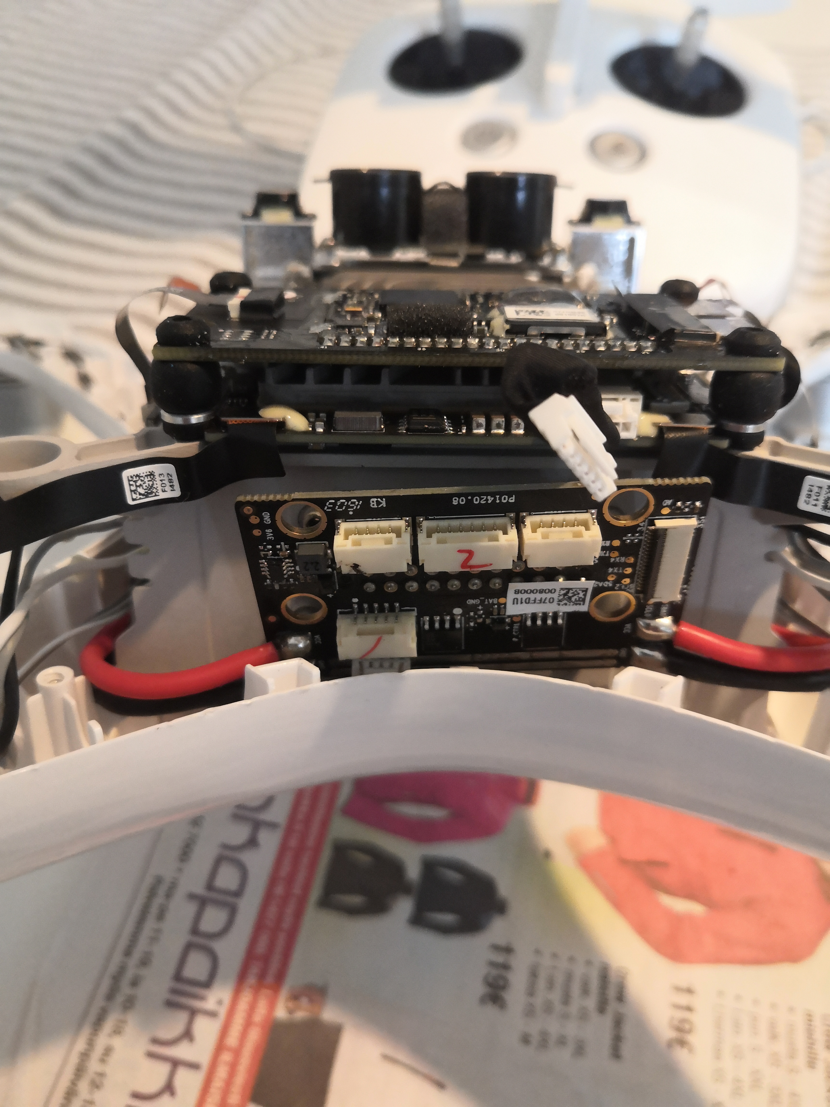

When I changed legs, another combass has malfunction. Combass 1 doesnt work.
With Droneted help, I tried to figure out what is wrong.
First I changed wire. If you have new legs and they are malfunction it probably is with wires. So I changed wire, china wire out and old phantom wire back. No combass.
Next I tried to switch left combass to right, I got it working. So, malfunction was on power coard left port. In right port both combasses work.
So now I have to order power coard. Clad that would not be expensive.

Today I got new power module and yes, malfunction was on this module.
Both compasses work now.
Now drone waits yaw motor.
