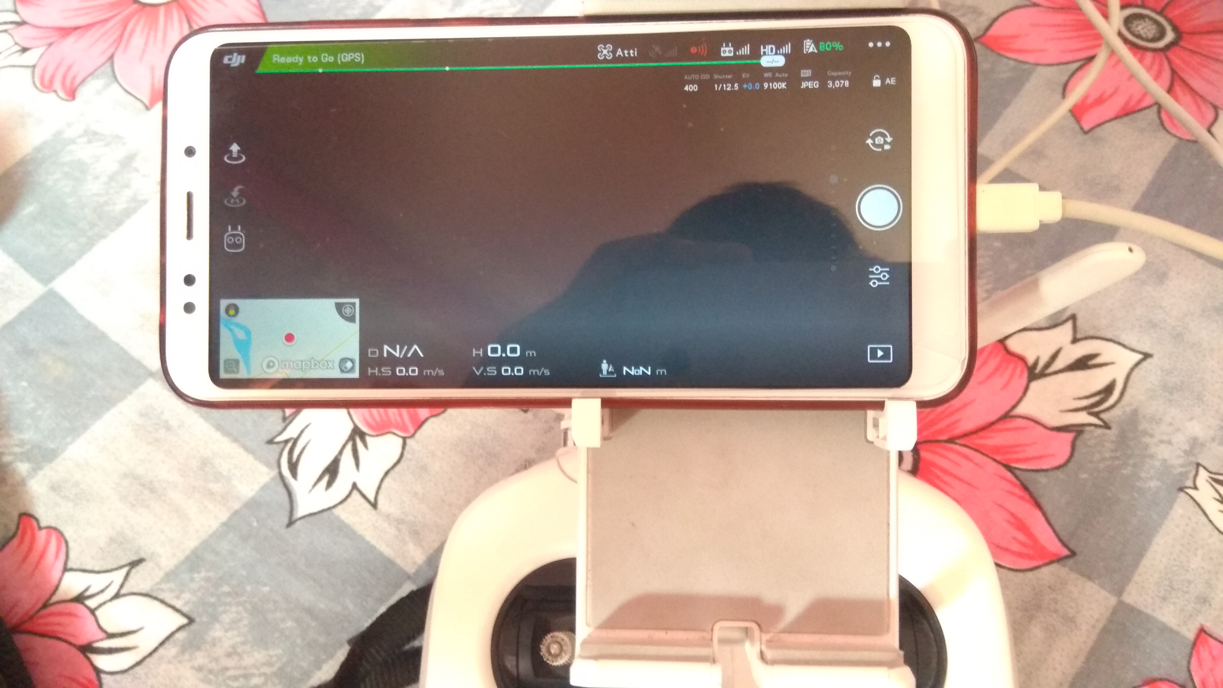

I update firmware phantom4 after updating camera view not seen my android mobile device.camera status button is blinking red and green. What I can do it. I use other mobile but problem is not solve. I use Dji assistant 2 for downgrade firmware but no show any downgrade firmware update. I reset factory default but not solve the problem. Camera is fuuly working and recording the video and photo it's video playback in pc.
Please help me
Ok me try
This what we tried. Relinking,uninstall app,gimble calibration, imu calibration,another device,
Rc lights green

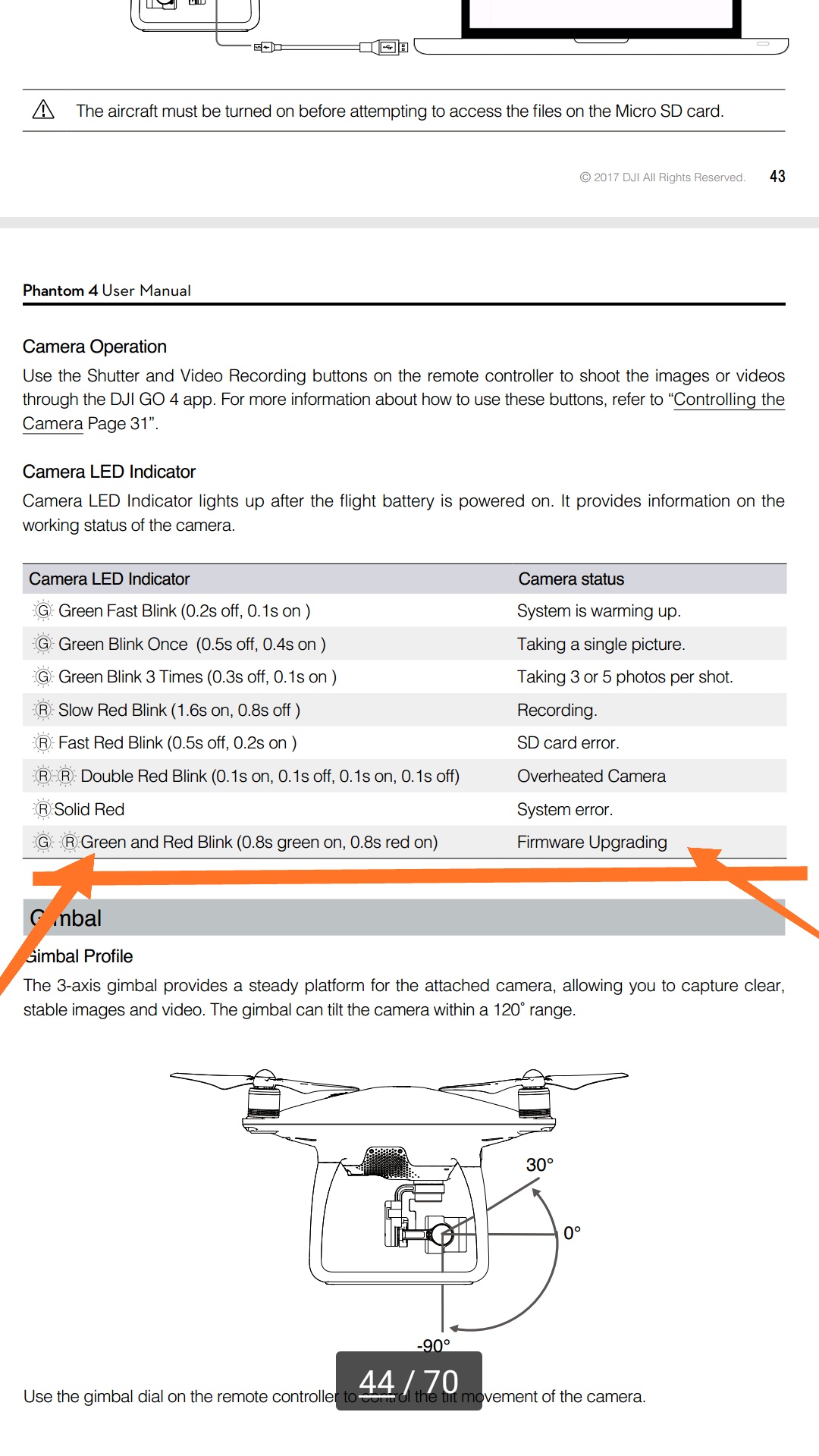

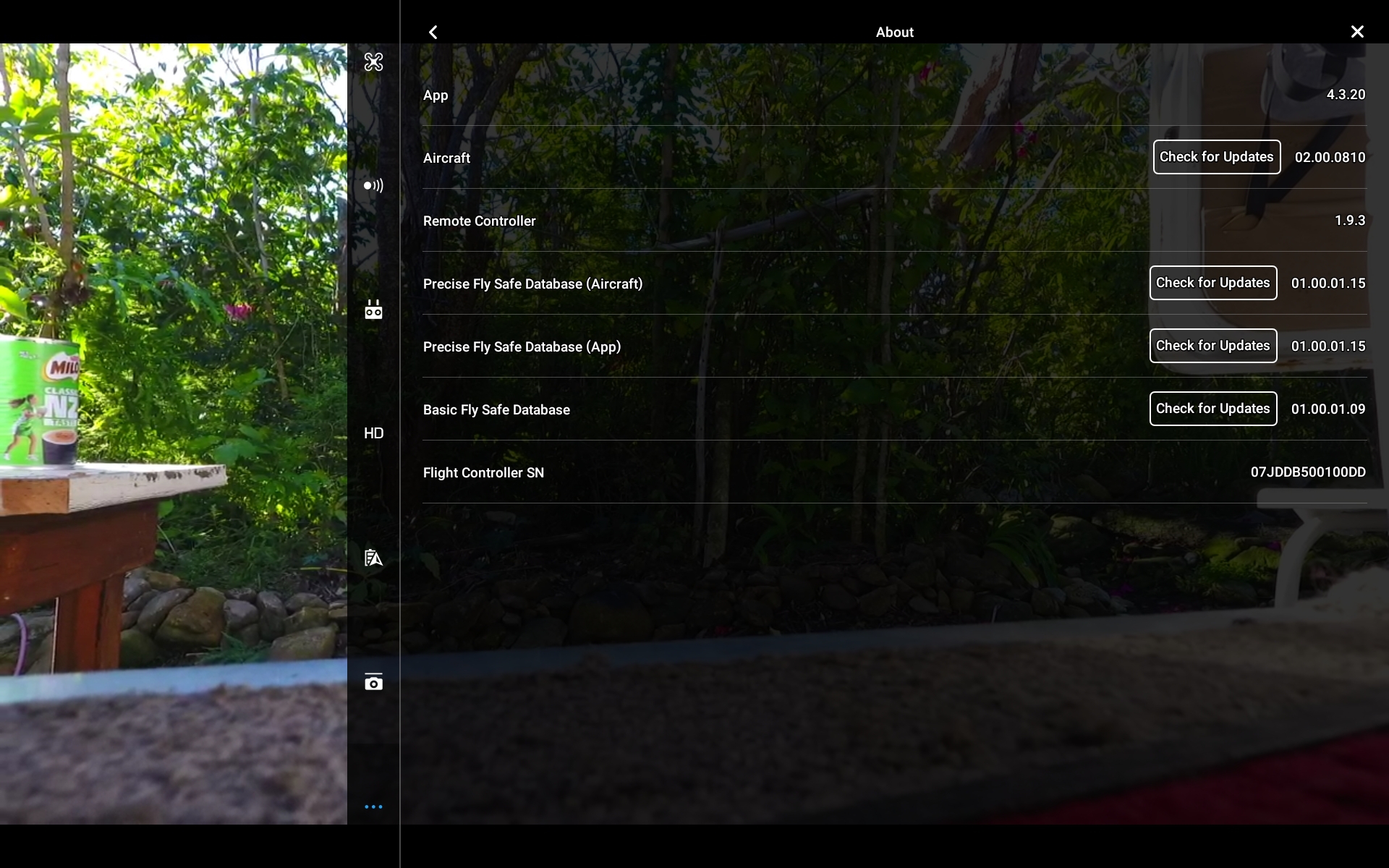

Gimble flash red and green about firmware,do you know which firmware installed, you could say latest but it seems to be mismatch somewhere,me just get pic of mine so we got some version numbers to go by,..when you click on ABOUT you should get this come up,,these correct firmware numbers,,is yours like this......

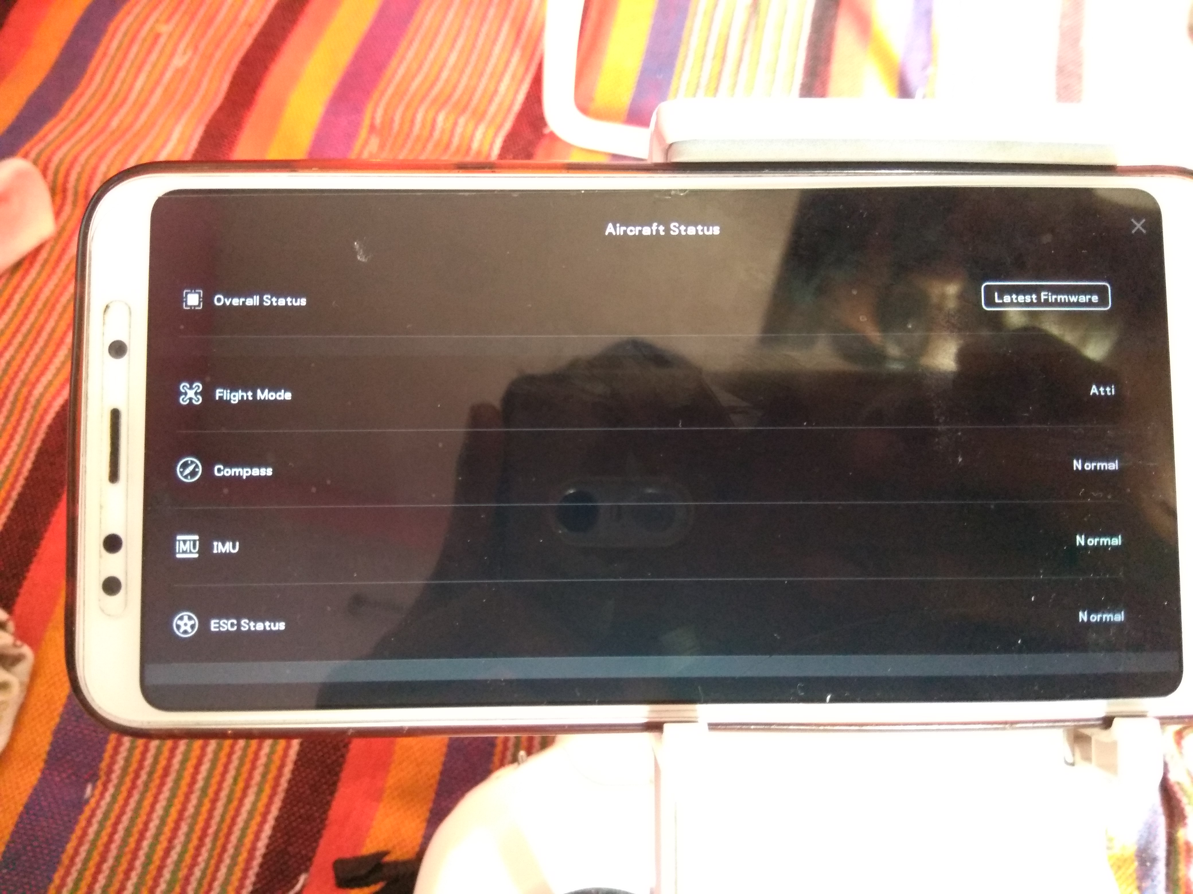

No show any warning.
I check aircraft update but no show any update.
