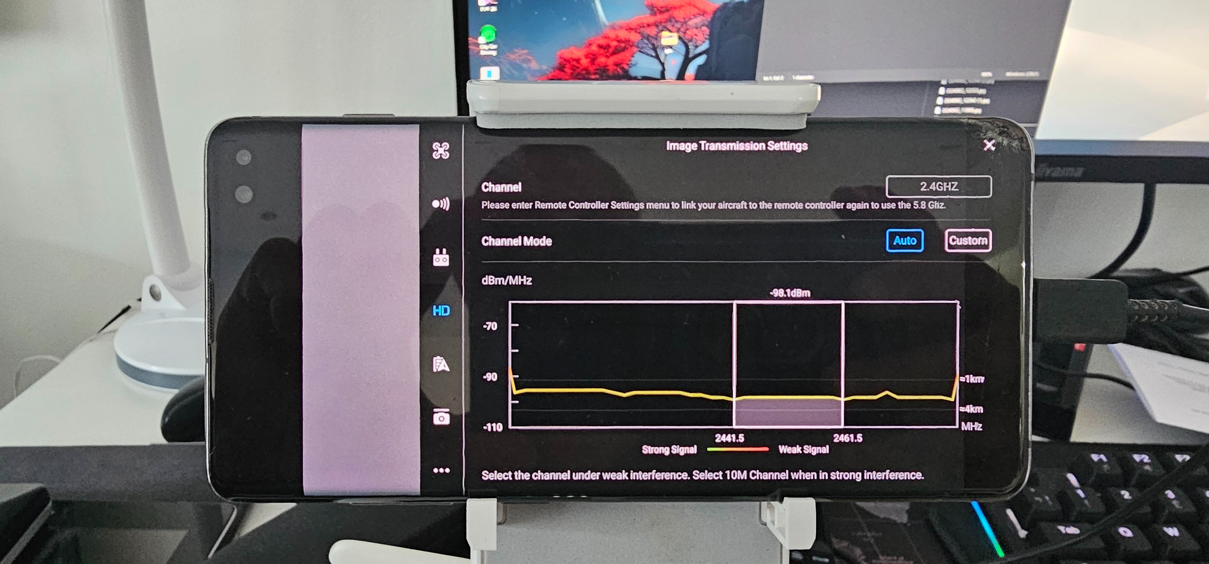

yes but what is the standard procedure then??
Does the dual-band option not return when goggles are disconnected?
i have no goggles and can not switch bands any more.
after trying to pair controller to drone -my mistake i shouldn't event do this- my bands gone grey and now i have 2.4Ghz
i have spoke to dji support and they advised me to refresh softwear for controller and drone which i have done and did not help at all.
