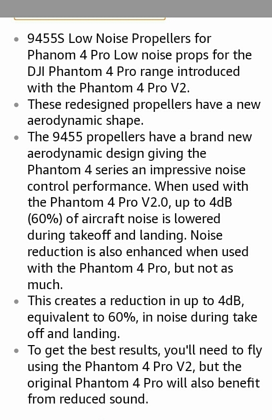

,,24x13.97 = 9.4x5.5 inchs
My box just say 9455s 9.4x5.5 inches 11.7 grams,,,4db quieter so not a lot of difference,one thing I did notice was props were very cold to touch after landing ,,again they make good leaf blowers
,,,,,have to add aswell makes flying in the wind very unsteady

With greater pitch thrust variation will be coarser with lower rpm change and greater torque required from the propulsion system.
