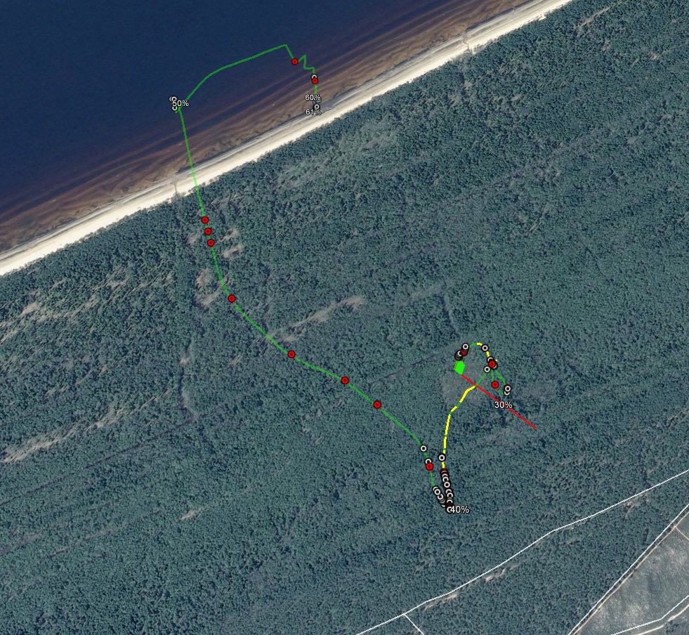

fuzzylogic, as Meta4 explained above, there are two possible outcomes. Your Phantom either continued to drift further away from the home point and auto landed or it switched back to P mode at some point and tried to fly back to the home point.
Assuming the Phantom stayed in ATTI until it landed, I'd recommended you search between the following points:
59.549439, 28.106388 (last point in your flight log)
59.550014, 28.110642
The red line in the image below is the path between those two points.
After your remote controller disconnected from your Phantom, it would have started to auto land after 3 seconds. Since the wind was strong (or at least gusty at the end of the flight log), your Phantom would have been moving further away from the home point (along that red line if the direction of the wind did not change) as it auto landed.

Wow, thanks! It will help me a lot!
