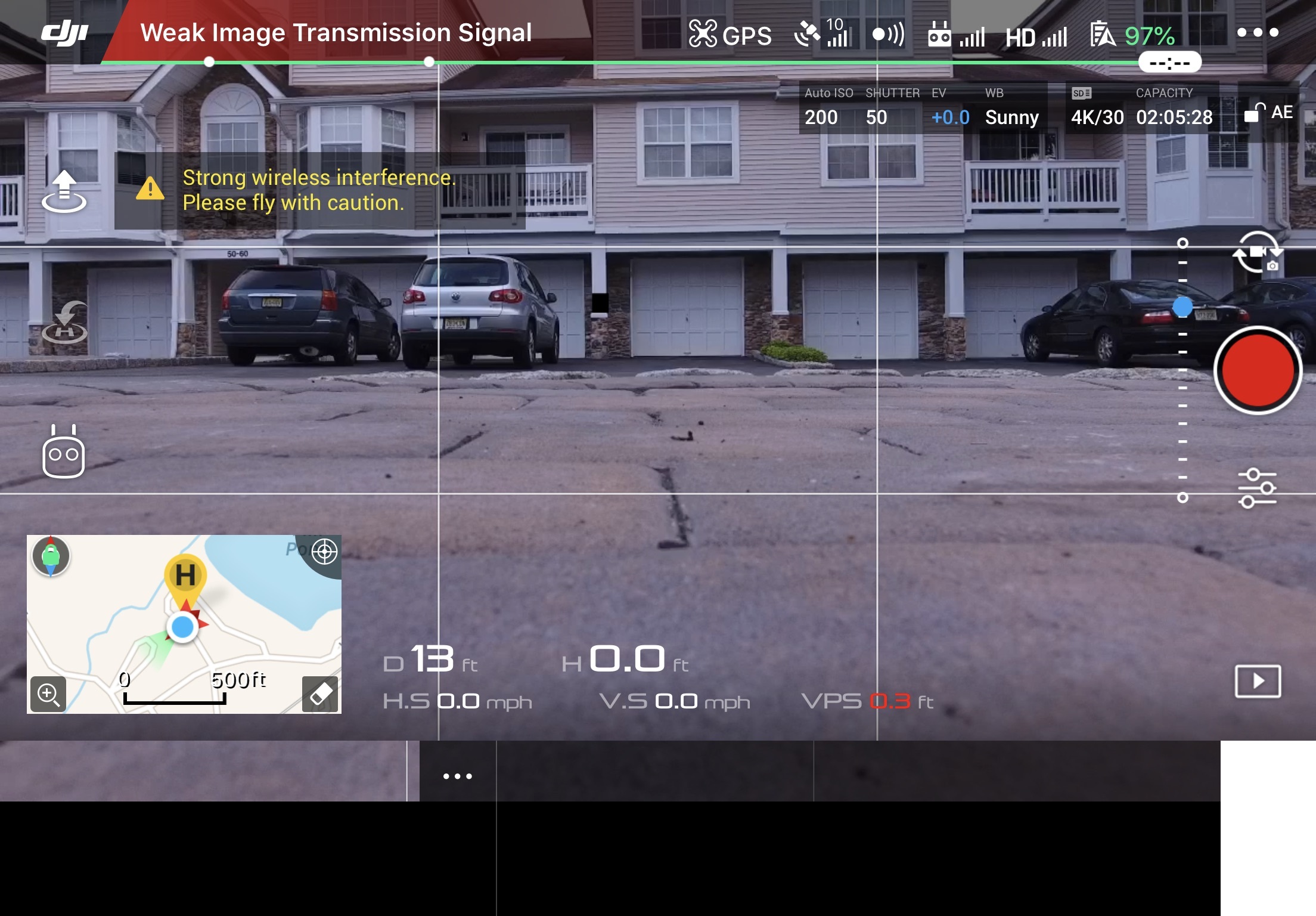

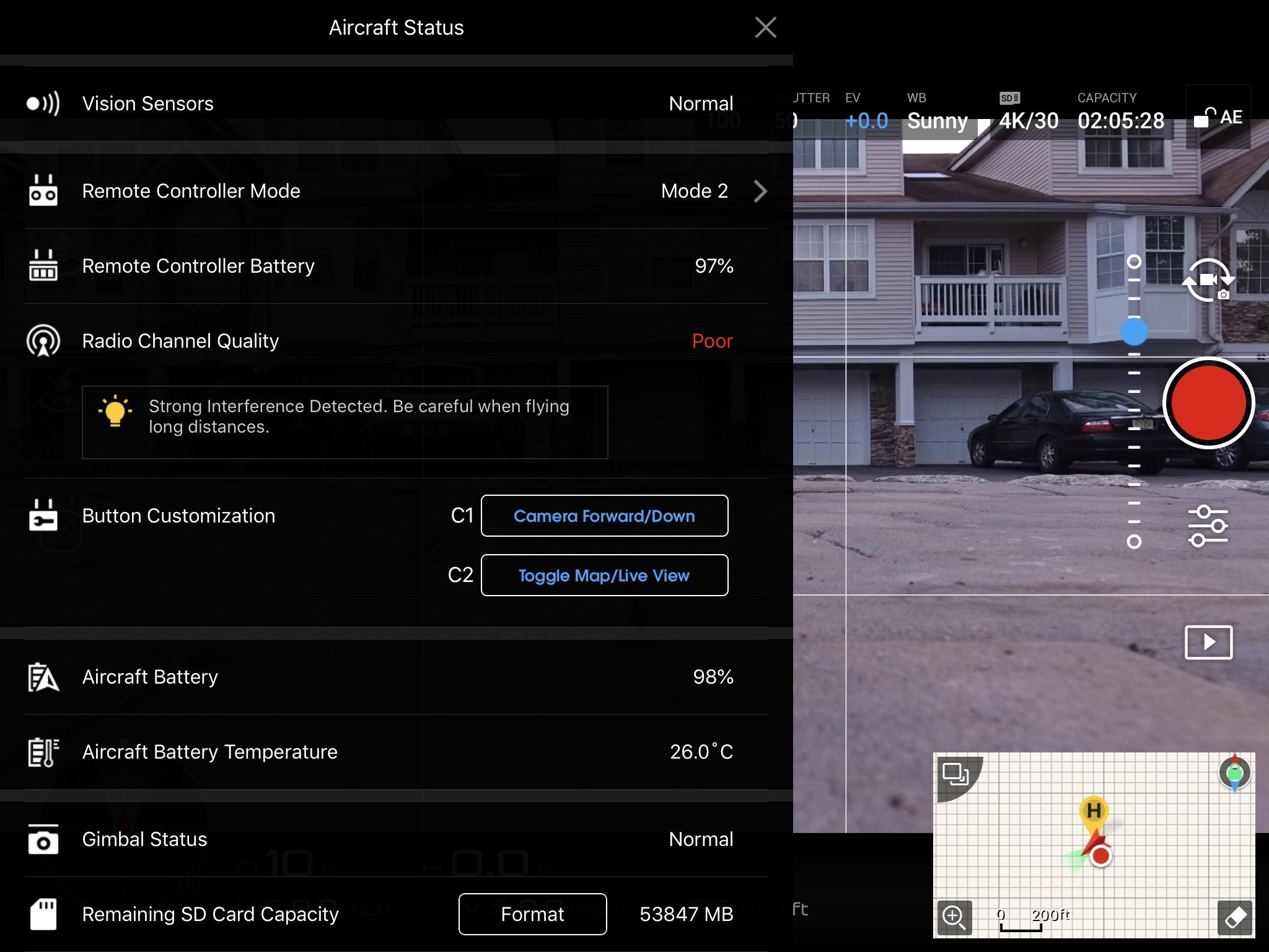

The *real* issue I started having after getting my drone back from DJI was that I started experiencing "poor radio channel quality" in areas that I had always frequently flown in without problems in the past. It would state "poor radio channel quality" and "strong interference detected. Be careful when flying long distances." This caused me to not be able to fly more than a few hundred feet without losing connection to my drone. I also tried flying my DJI Spark in the same location, and was able to do so without issues.

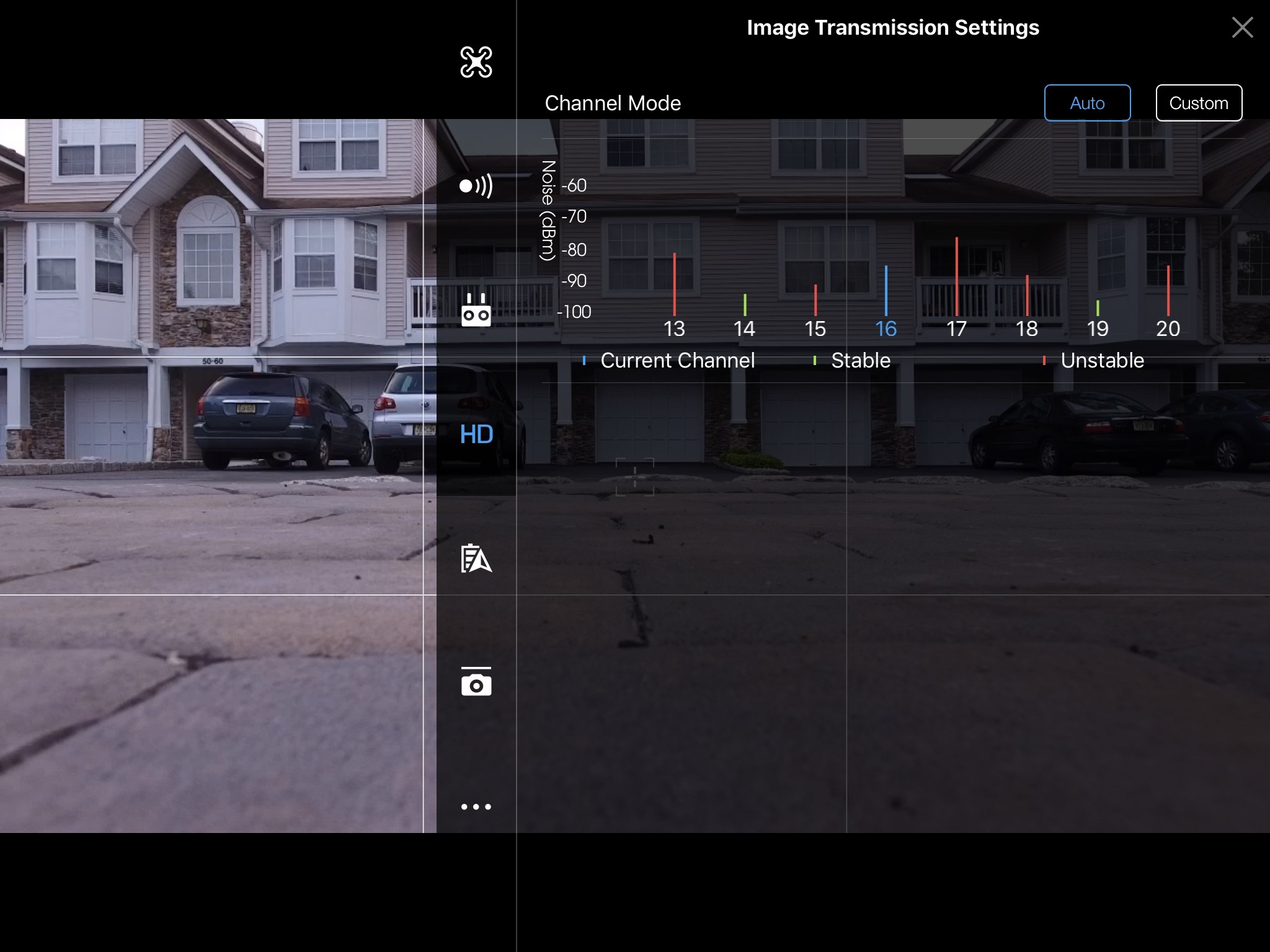

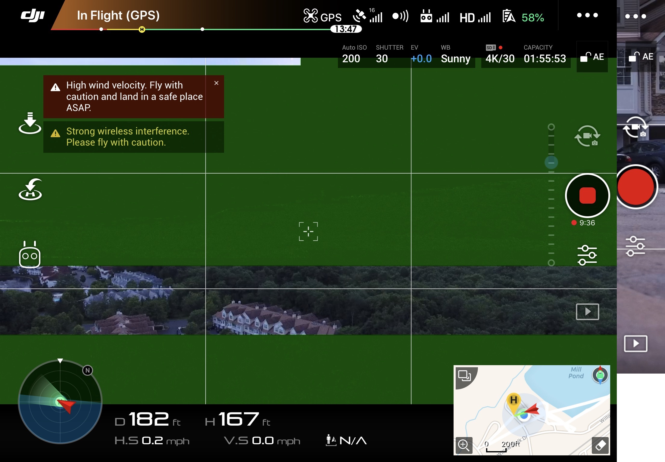

I initially used my iPad Pro 9.7" and then switched over to my iPhone 7 Plus, to see if both gave me the same issues, and they both did. Then, I flew my DJI Spark in the same exact spot to see if it had the same problem, but it did not. I also received "high wind" warnings, when it was a nice calm day, even when I was flying it at a low altitude. I do understand that there may be stronger winds the higher up you go, but it showed it at low altitudes, too. Please see the attached pictures of the Phantom 4 screen issue/radio transmission issue etc., and then the Spark one for comparison.
To fix it, I tried clearing the cache from within the app, tried going from auto channel control mode, to custom/manual, back to auto... Deleted items from my actual device to create more room... I switched from my iPad Pro 9.7' to my iPhone 7 Plus... I also made sure that the antennas were facing the correct way, per instructions given on a DJI instructional video on YouTube and in the owner's manual. This was flown by my house, in an area that I have flown in the past without any issues. I also flew at a park that I have flown in the past without issues. None of it helped. Thank you.

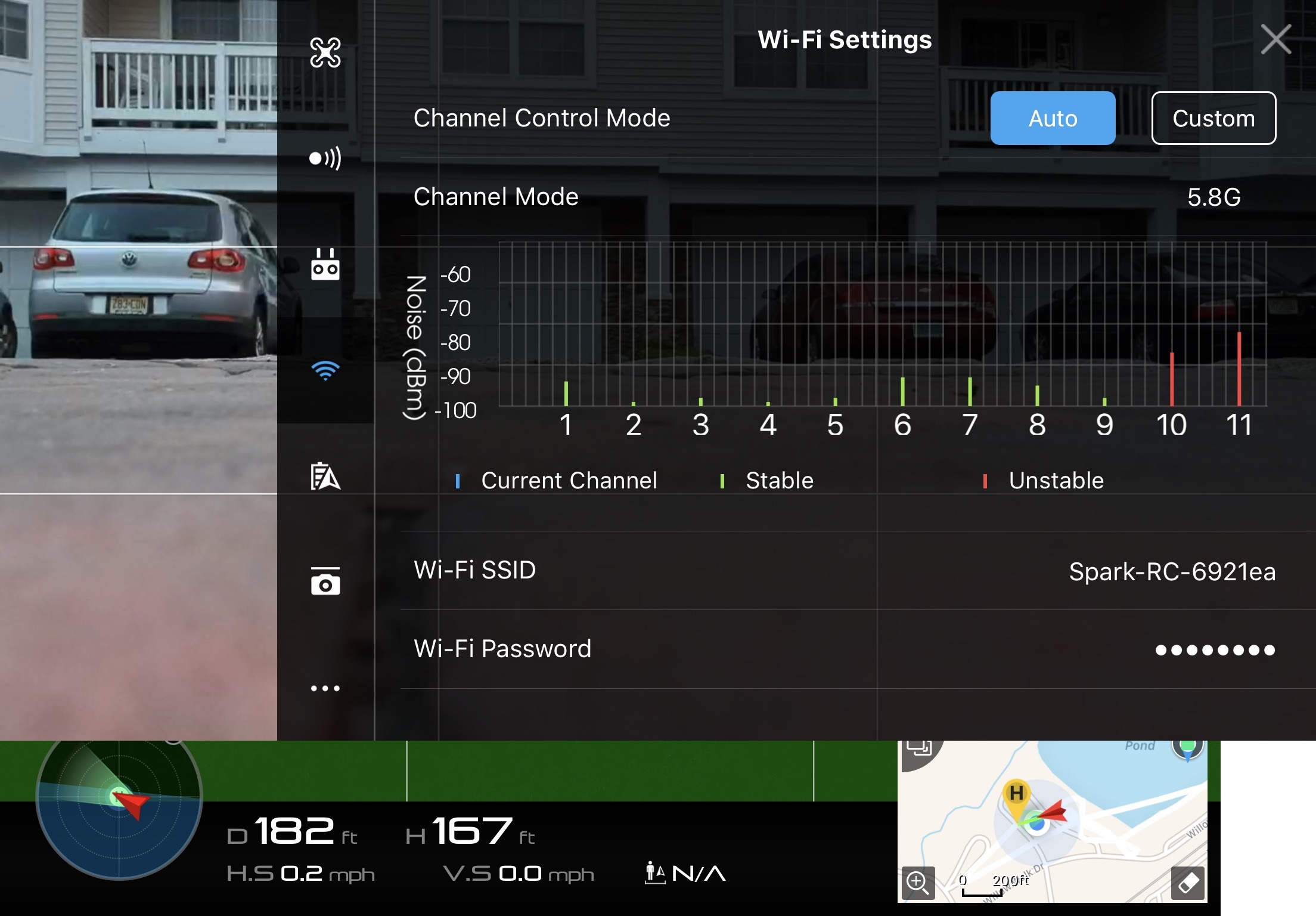

This last picture is my Spark, showing stable channels, compared to the Phantom 4

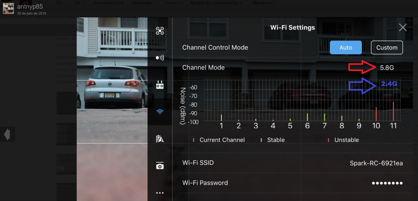

disculpa, las letras nada ...... mira la foto ....... Ok
