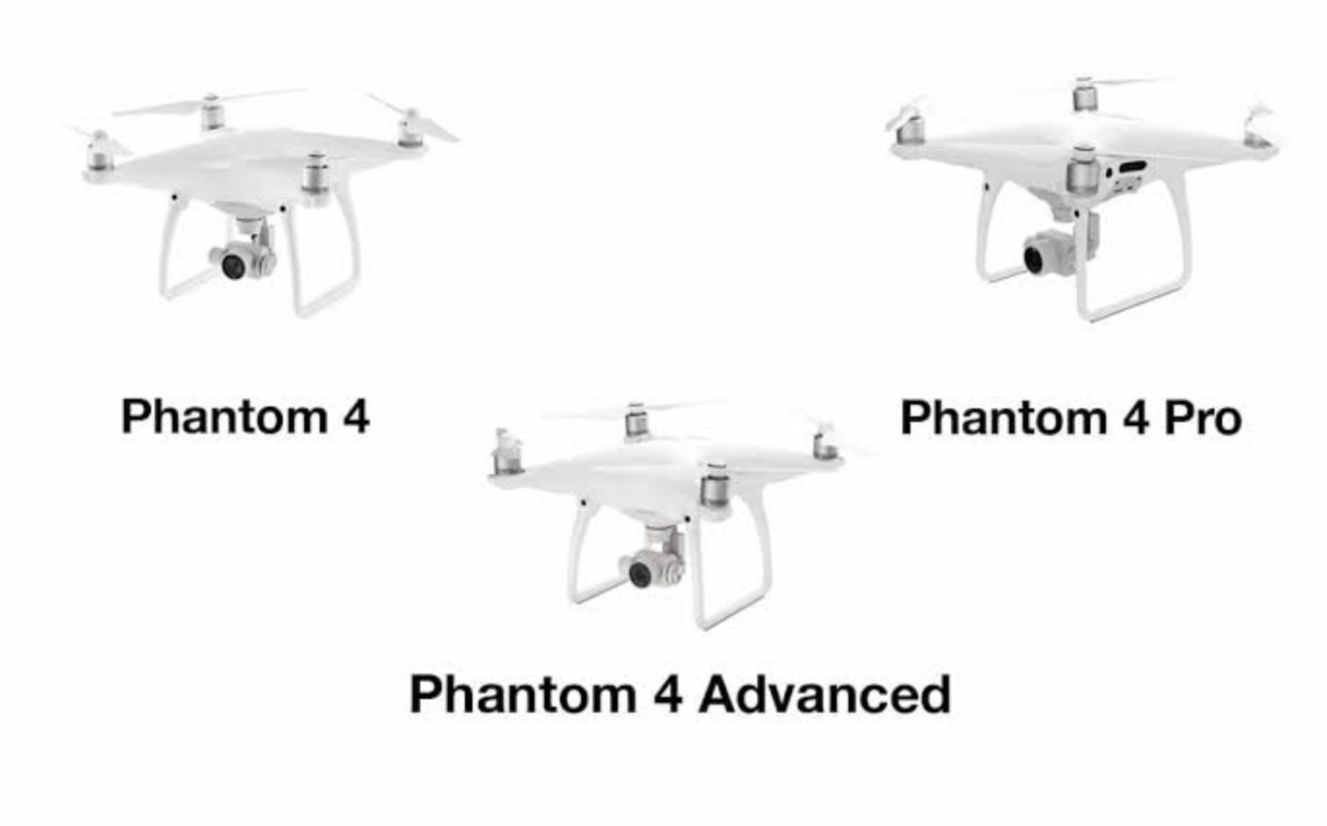

Hi everyone - I'm not a drone pilot but found a DJI Phantom on the street after the neighbors moved out. Its just the drone with battery and gimbal camera (no controller or other accessories). First question is - how do I know what series Phantom I have and second: without a controller I dont know if it flies - looking for suggestions as to how to ascertain that it does/doent. The battery says "phantom 4" but I dont know if batteries for 3 and 4 series are interchangeable. Thanks in advance pilots!
Battery says phantom 4,,its a phantom 4,,no battery from other drones wont fit ,,you could add serial number from inside batt box ,location found and if any rego numbers incase its bein looked for..you could check sd card for any familiar areas on film,check lost and found columns,,pilots dont give up on drone if lost and sure they be looking,,might get reward if lucky,it be someone's pride and joy,,dont just buy remote and try fly,it dont work like that,lots to know and since your not the owner,try do the right thing,even post some pictures of it,someone here might be looking,,
If it has side sensors it's a p4p,,if not it's a p4s
Forgot to add search dji serial decoder and enter serial number and it should tell you what it is

Yeh could do but by your comment it might not be lost,strange to leave drone behind unless it's very dead,any power from battery, takes a double press to turn on and off,,also the p4p is more streamlined than the p4s with is larger shell and landing gear,,yes can get remote and relink remote to drone but that's if it works,,any visable damage,,inside the drone are boards with ribbon cables on grommets and only move so far before breaking,,this is where the fun begins,,,you can replace these but depending if anything else wrong some repairs can add up

Look in the battery compartment. There is a sticker with the model number on it.
