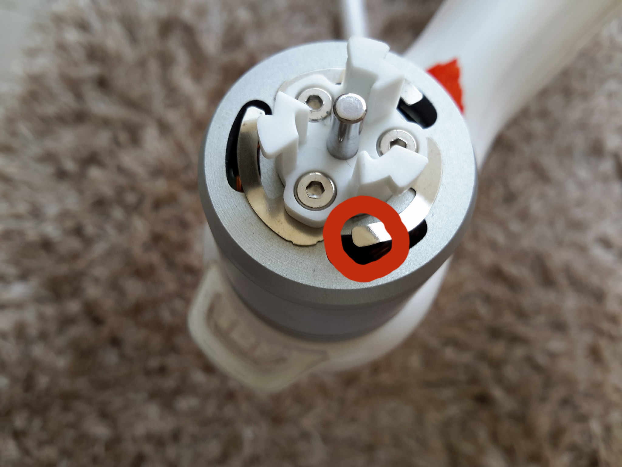

You can also use clear nail polish to lock the screw and provide a visual mark. I suppose you could also use a glitter polish - however you roll. One thing that does bother me looking at the picture is what appears to be metal fatigue on the bottom metal spring. That's the kind of metal fatigue that eventually breaks....
That's not fatigue... that's a relief bend so that when you remove the props, the edge of the spring does not catch on the prop. When the prop is attached, the edge of the leaf spring will be pointing slightly downward to prevent it.
If that's a factory bend, it sure looks like they did it wrong. You can see wrinkles in the metal plating. Might be the picture but it looks pretty wonky.
Chopstix is correct, I have a brand new set for spares and the end is turned down and inward. Besides, fatigue is going to occur at the bend where the spring comes up from the flat part of the plate. They seem to be made from a good quality spring steel so the number of fatigue cycles is probably pretty high. Also, the deflection experienced by the spring during prop install doesn't look that much. It's just a wild guess but I would think the posts that lock the prop experiences more stress and would be subject to failure before the springs.
Bottom line, I think it would be very good practice to replace the prop mounts after so many hours of flight... The number of hours is the million dollar question.
Looks like that spring would chew up the motors or jam it up outright if it broke off and fell into the stator area.
Of course it's factory bent, nobody it saying the "bend" isn't intentional. When you "cold work" steel it tends to get brittle, stronger but more brittle. It's the artifacts in the picture that make it look like stress fatigue
That's a good catch, it LOOKs like fatigue to me also, I doubt if it fails it would be an aircraft part failure though, meaning that tiny piece may fall away without injuring another part, and the force from cold working, or tension, would still be applied when that piece comes off, still, I may order a set of these they're cheap and available.
Thanks lads, have given a thorough check and dont see any issues at the moment on the spring load appearing on my picture, anyways have a few extras ordered just in case.
