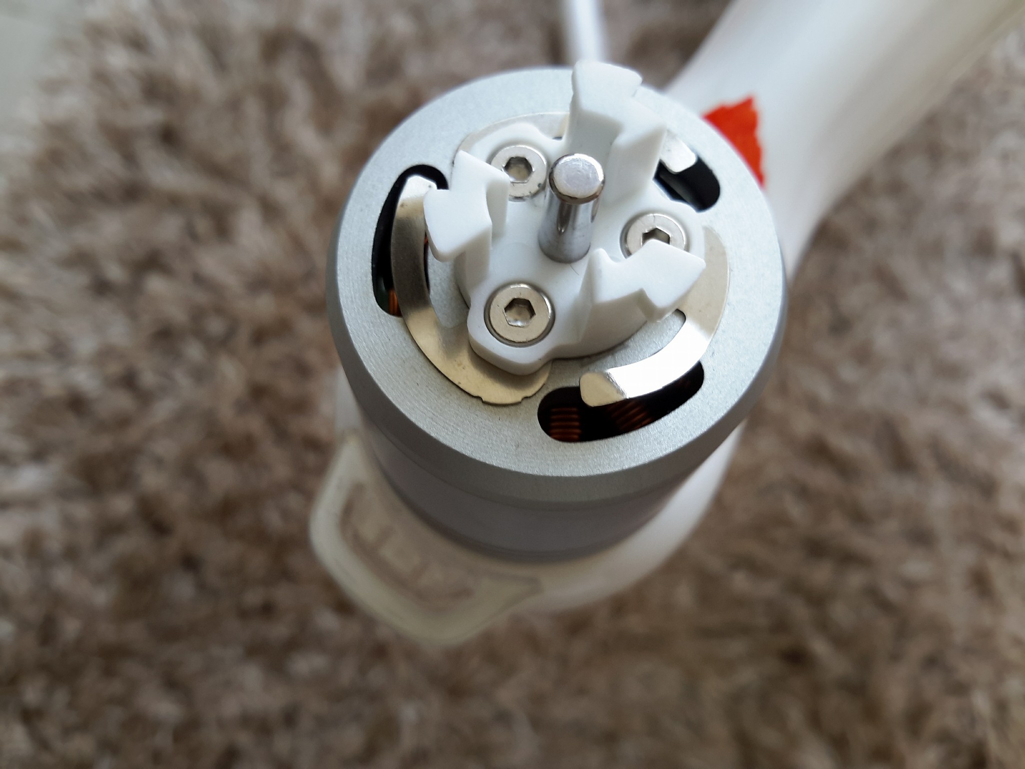

I see a small crack on THE foto, from THE middel pointing to right under (south-east). Very alarming!
Had a good look at the same prop pictured for about 5 mins with a torch light and cant see a crack, probably was a strand of hair..... phewww..

1. Inspect the prop clamps on the motor, the white plastic that holds your props, check them for any wiggle, even a slightest wiggle, tighten the screws using a 1.5mm hex allen key
2. Some of the screws on mine did not have the blue threadlocker compound applied, you can do them now, search for threadlocker in google, its a gel or a stick, it makes your thread tight and prevents them from coming loose due to vibrations.

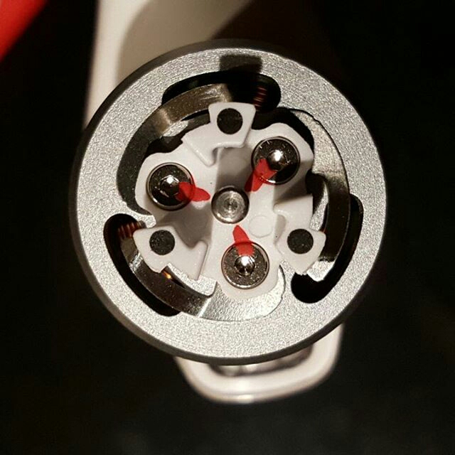

3. A very quick inspection trick is to mark the screws using torque striping method, use a sharpie (a permanent marker) and draw a line on the white plastic and the screw, if the line is mis-aligned, you can easily tell a screw has come loose.
NOTE: Use a tiny bit of threadlocker on the screws only, not on the plastics.

Here's what I did. Some red Testors model paint applied with a thin paper clip. Same concept they use for the lug nuts on school buses and large trucks so you can visually identify any that may have come loose.

You can also use clear nail polish to lock the screw and provide a visual mark. I suppose you could also use a glitter polish - however you roll. One thing that does bother me looking at the picture is what appears to be metal fatigue on the bottom metal spring. That's the kind of metal fatigue that eventually breaks....
That's a good catch, it LOOKs like fatigue to me also, I doubt if it fails it would be an aircraft part failure though, meaning that tiny piece may fall away without injuring another part, and the force from cold working, or tension, would still be applied when that piece comes off, still, I may order a set of these they're cheap and available.
