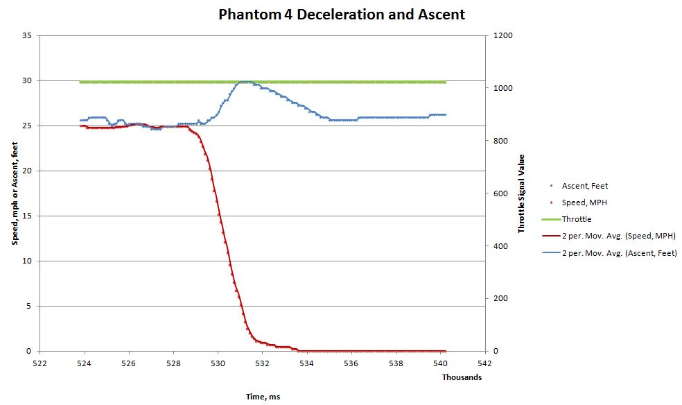

I have noticed the drop issue with my P4. However, when I look at the flight log data and compare the altitude prior to deceleration; when the P4 comes to rest the altitude is essentially the same. Looking a little closer at the data I am consistently seeing the behavior shown in the graph below when I come to a stop... This may not be the explanation for everyone. However, the early post by Tripc may be on to something.
I just tested today for the first time since the app update. No difference in P-GPS mode; but in sports mode, it rises several feet during braking, then settles a few feet lower than it was while cruising--then slowly raises itself to about a foot or two below the initial altitude.
