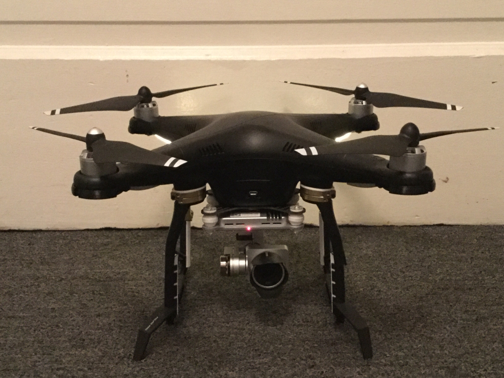

For those who were curious, I've finally gotten around to weighing my P3P.
A bone stock P3P weighs in at 2.8lbs
My P3P with all of it's aftermarket parts comes in at 3lbs, which is only a 3.2oz difference!

30four, what effect does this have on landing gear strength for hand catching your P3?
The retracts, combined with the landing gear extenders, cushion the landing every time. They act as shock absorbers/stabilizers. I have a much wider stance now and I never have any tip overs. I can even land on an incline.
One time I was coming in for a hard/fast landing and wasn't paying attention to where I was coming down and landed on something uneven. The retracts moved and kept the phantom level.
A picture as an extreme example.
