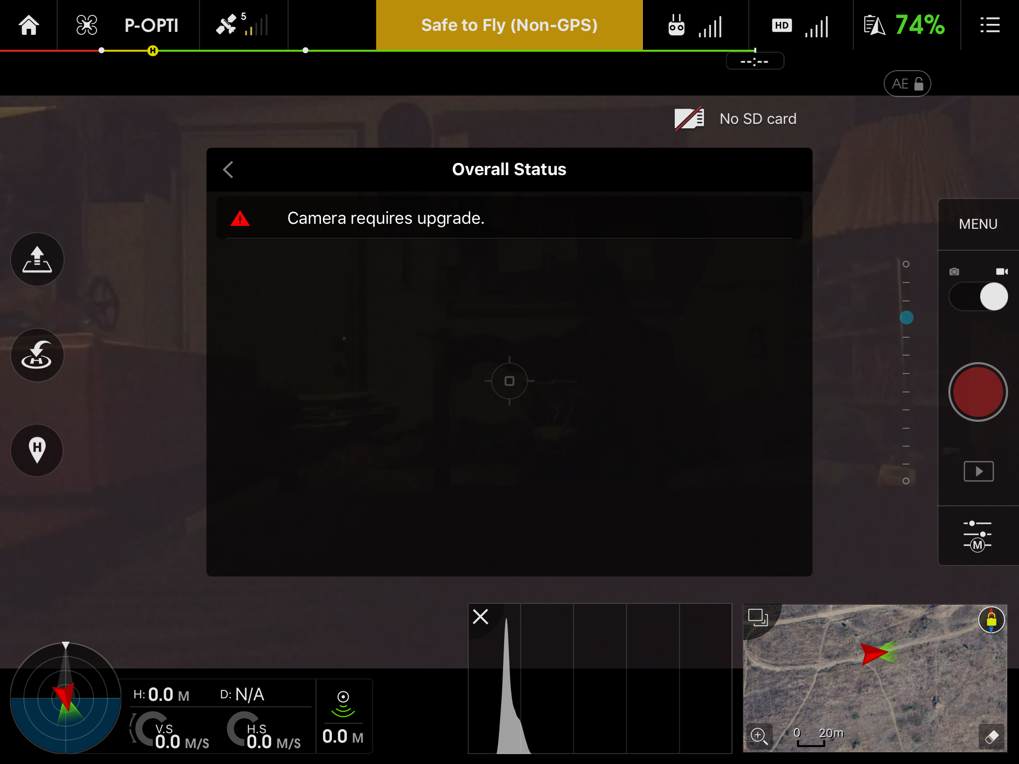

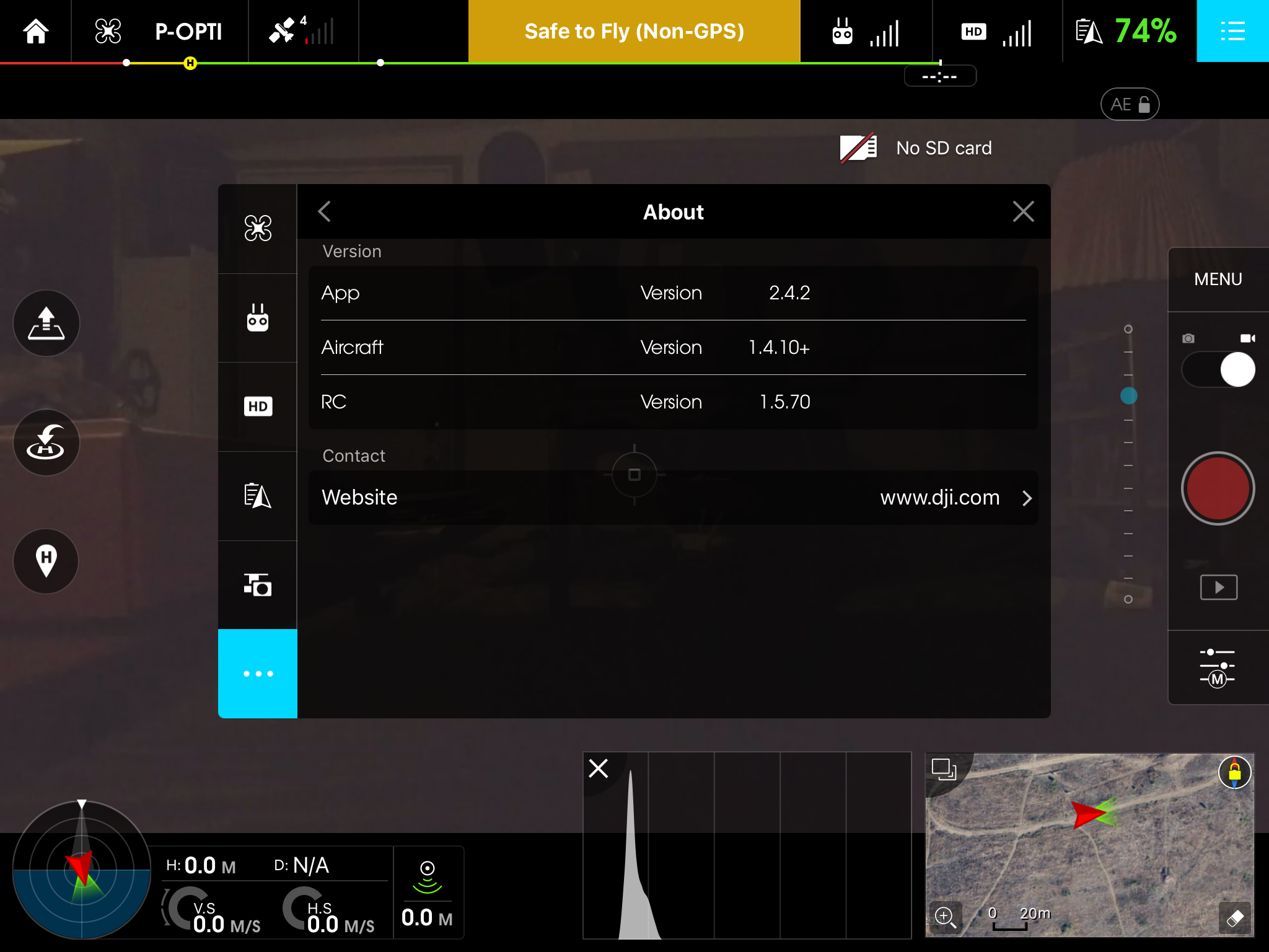

Hi all. Having an unusual problem with the new f/w upgrade. At least I haven't come across anyone having the same issue here or on DJI's forum after checking all the update threads.
I have a P3A which was on the latest f/w version before 1.5. Downloaded the update from DJI site, extracted the .bin file. Reformatted the sd card while it was in the quad, shut down the P3A, then transferred the .bin file to the root directory on the sd card, making sure it was the only file on the card. Plugged it back into the P3, and turned it on. Update started fine and continued for about 15 minutes, at which point the gimbal light turned solid red, with a continuous tone. Tried all the usual work-arounds - re-format card, use a different card, re-download update, make sure I have the correct update for adanced (P3S, not P3X), make sure bin is rooted, glare menecingly at P3 while it's updating - all to no avail.
The log files show that the update failed and the LOG_AB.txt file shows a specific item that needed an upgrade that wouldn't do so. (see attached text file)
Now here's the unusual part. I decided to update the GO app (using Ipad mini2) and controller, which happened with no problems, and connect up to my P3 to see what would happen. Everything connected fine, and everything works as it should - all camera control functions work, motors stop and start as they should, etc. But now, the Go app is saying I need an update for my camera. (see screenshot) Also, under "about", I'm showing latest version numbers for GO and TX, but the quad update is showing 1.4+, not 1.5. (see screenshot). Haven't had a chance to fly since updating so I can't be sure if everything is working properly. I didn't think there was any changes for P3A camera, so why do I need a camera update? Any suggestions would be welcome. Thanks in advance.IMG_0024.PNG IMG_0025.PNG

I did experience the drifting problem when trying to come straight down. I was looking forward to testing this today but when I turned it on I had no video image. I attempted to upgrade the firmware and it failed with an 08 and 15 in the advanced error log which apparently are devices regarding the camera and something else. It looks like a hardware failure.
When I go to HELP and ABOUT it shows the latest firmware version but again two of the devices are listed in the error log as not detected.
Attempted to roll back to 1.4 and 1.3 but same error. The bird only had five hours of flight time on it so I'm kind of annoyed.
I did have B&H Square trade insurance so I'm going to try to get an RMA and get a brand-new one.
Now here's the unusual part. I decided to update the GO app (using Ipad mini2) and controller, which happened with no problems, and connect up to my P3 to see what would happen. Everything connected fine, and everything works as it should - all camera control functions work, motors stop and start as they should, etc. But now, the Go app is saying I need an update for my camera. (see screenshot) Also, under "about", I'm showing latest version numbers for GO and TX, but the quad update is showing 1.4+, not 1.5. (see screenshot). Haven't had a chance to fly since updating so I can't be sure if everything is working properly. I didn't think there was any changes for P3A camera, so why do I need a camera update? Any suggestions would be welcome. Thanks in advance.View attachment 36705 View attachment 36706
Have exactly the same problem. The only difference is my camera now doesn't work and there is no connection from cam to phone - i don't see any video feed at all.
If you have connection issues re-linking won't hurt
