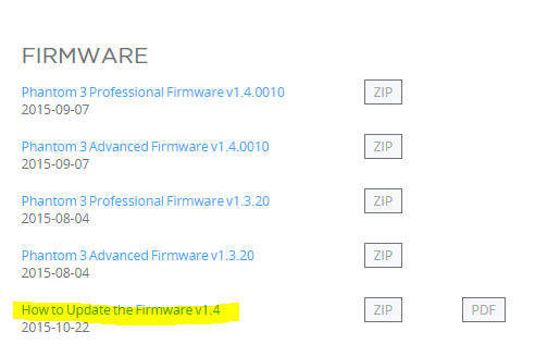

The naming is exactly the same now as it was when the Pro and Advanced were release
The naming convention most certainly did change. Last update I did, the firmware download file for Advanced was named "Phantom_3_Advanced_Firmware_v1.4.0010_en.zip". This time it is "P3S_FW_V01.05.0030.zip". Given DJI's lack of attention to detail in the past & the fact that they released a model designated as "Standard", the "S" in the filename gave me reason to pause.
In fact, if you go to the dji site and hover over the previous release, you'll see that the link says http://dl.djicdn.com/downloads/phantom_3/en/Phantom_3_Advanced_Firmware_v1.3.20__en.zip
