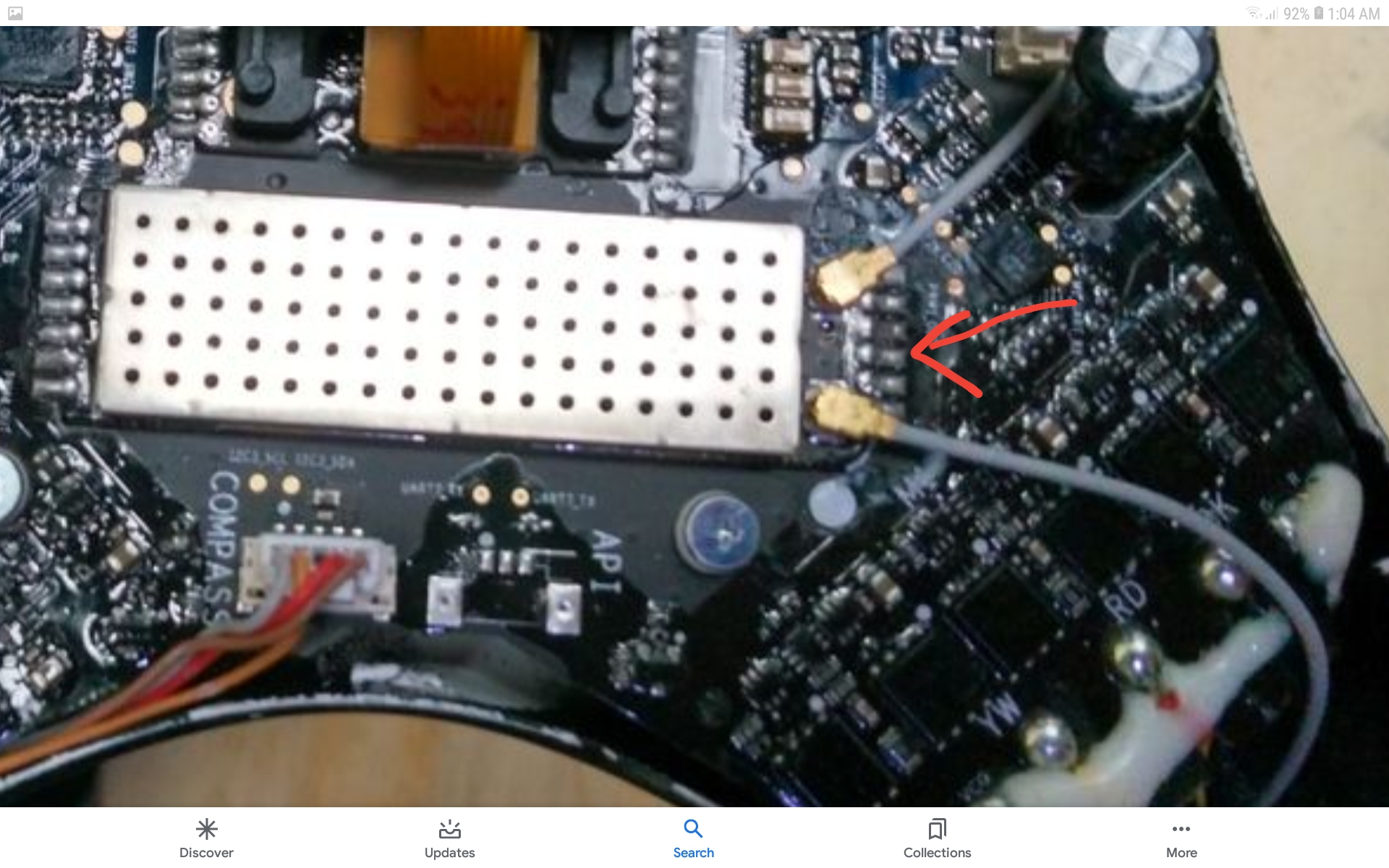

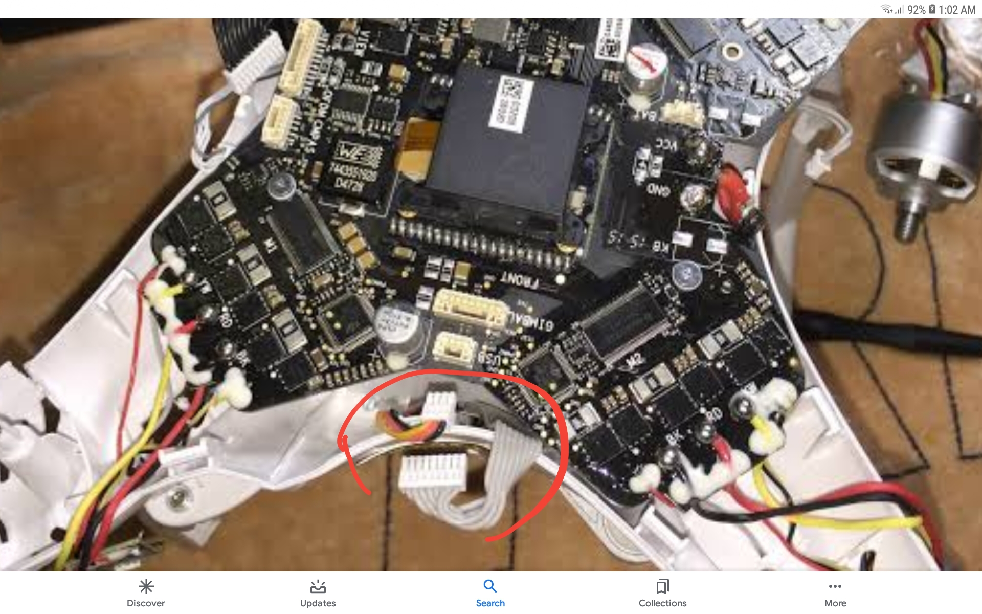

Do you know if ribbon was original part cause some cheap ones dont work,,I presume the gimble dont move at start up,,it should go through start up sequence,,any light showing on the gimble,,? As for the loss of conection it could be inside the drone,almost sounds like its unclipped from the board where anttennas clip in or it's a broken wire,,
Couple pictures of where I think might be fault,,the white plug might have pulled free or the antenna in the other picture ....yeh it sort of depends how hard the impact was and from what direction, hard jarring more than enough to make them pop out if they got bit of glue holding them,,there's no real grommets inside to absorb the impact which sometimes things pop out

The ribbon cable that goes from the top of the gimbal to the drone body, is the power supply to the gimbal. The other 2 wires are your antennas. They give telemetry, information and video to your screen. The ribbon cable that runs the length of your gimbal feeds the power to the motors, camera and the camera feed. If all that is ok, then it could be the main board at the top of the gimbal.
