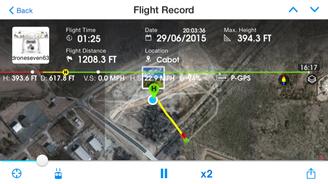

Oh man that sucks! I would definitely contact DJI and hopefully you can figure this out and get it resolved. I noticed on your flight data screen you posted it's not showing the battery level, GPS,ATTI Mode in other words the green, yellow, red bar that's above the middle of the screen. The reason I'm asking is because mine does and it's not showing on yours. Maybe it's a setting or something, just curious?
Oh man that sucks! I would definitely contact DJI and hopefully you can figure this out and get it resolved. I noticed on your flight data screen you posted it's not showing the battery level, GPS,ATTI Mode in other words the green, yellow, red bar that's above the middle of the screen. The reason I'm asking is because mine does and it's not showing on yours. Maybe it's a setting or something, just curious?View attachment 23737
That's odd. None of my flight records shows it.

On this video can you show the controller stick position? You should have a controller icon on bottom. Like this ...
[/QUOTE]
The video I posted us just the screen capture recording of the playback of the flight data from DJI Pilot.
The video I posted us just the screen capture recording of the playback of the flight data from DJI Pilot.[/QUOTE]
yes, replay it again but click the controller icon.
Yes that would be really good to look at, very useful information, especially on a fly away issue!
I think I might have just noticed something. When I play back the flight record in DJI Pilot and click on the little crosshairs icon, I click on the little arrow symbol and it shows where the drone is. When I click on the little Home symbol, it takes me all the way back to my house.
I think when the drone started up and initiated and locked in on the satellites, etc, it didn't pick a new home area which is where I was. At least that's what I'm thinking.
This is odd because it's never failed on establishing home from where I started off. It's always come back on its own and landed beside me when I push the home button in the past. I'm not saying that I push the home button this time, as there was no need to since I was just starting a flight.
