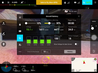

I don't understand the corolation between percentage of batt life & voltage. Today I did a deep discharge by ideling the Phantom w/o props. The voltage remained good (not in the red) all the way down to 8%. The other day I did a short flight with the batt starting at 64%. I was surprised when the voltage started going into the red within 1-2 minutes but went up while I was landing?
It will go into the red briefly under full load after the p3 gets down to about 50%--- no worry unless there is a big disparity in volt readings per cell-- on that is .10 or more lower than the next highest. With good balance all four will probably be red under full load.

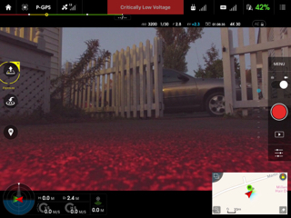

This happened to me a few weeks ago. There was a nice sunset...had 65% battery left. In my mind that should be enough to get up for a couple of shots and land. I took off, got up about 60m then I got Critical Battery Error and it went in to Land mode. I was able to get it back to me as it descended, but if i was out a little further, that may not have been possible. Dji should address this. I made multiple flights off 1 charge with my P2 many, many times. Also....blackouts..i'm getting tons. C'mon Dji...git your crap together!!
The battery may have not been all the way in-- this is a known issue and there are several threads on the forum regarding this issue. Happened to me once-- and I swore that the battery was in and locked. But got it on the ground and much to my surprise the battery had backed out about 1 to 2 mm and the small pins that read the cell voltages lost contact and caused the error. Just make sure the battery in fully in and lock-- no gap between the cap and the housing.
