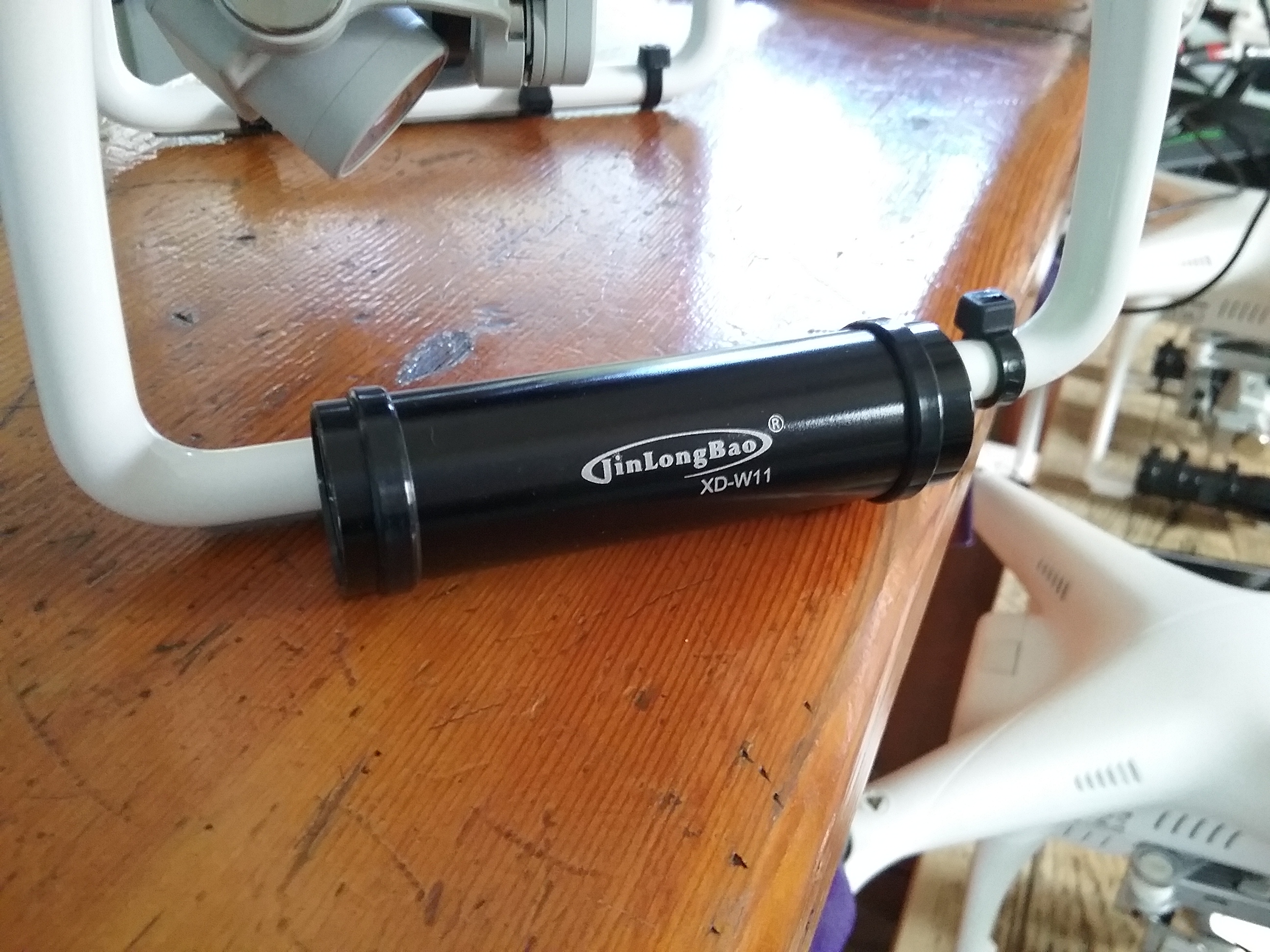

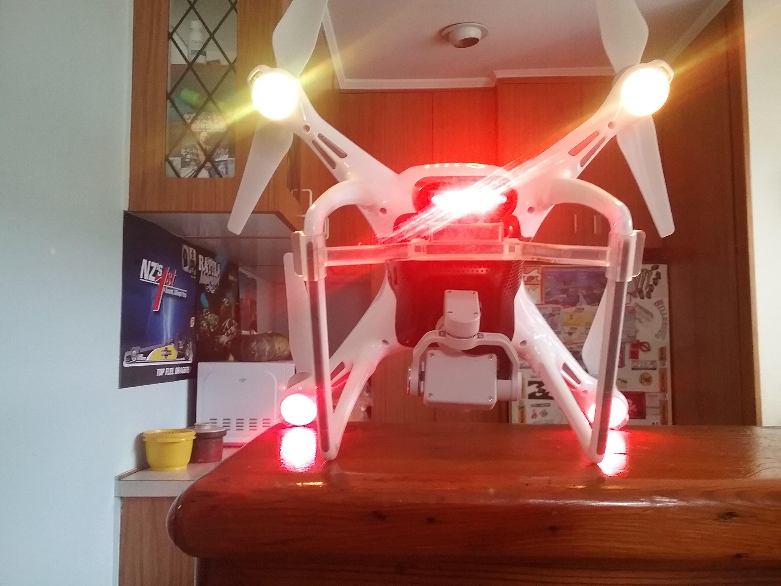

Just a pic of mine,STILL waitin 4 strobe light off ebay so i got this cheap lightweight pushbike light,,and very effective,,glued it to camera lock that came with drone just clips on and off landin gear and far back enough not to anoy the vpsView attachment 78772

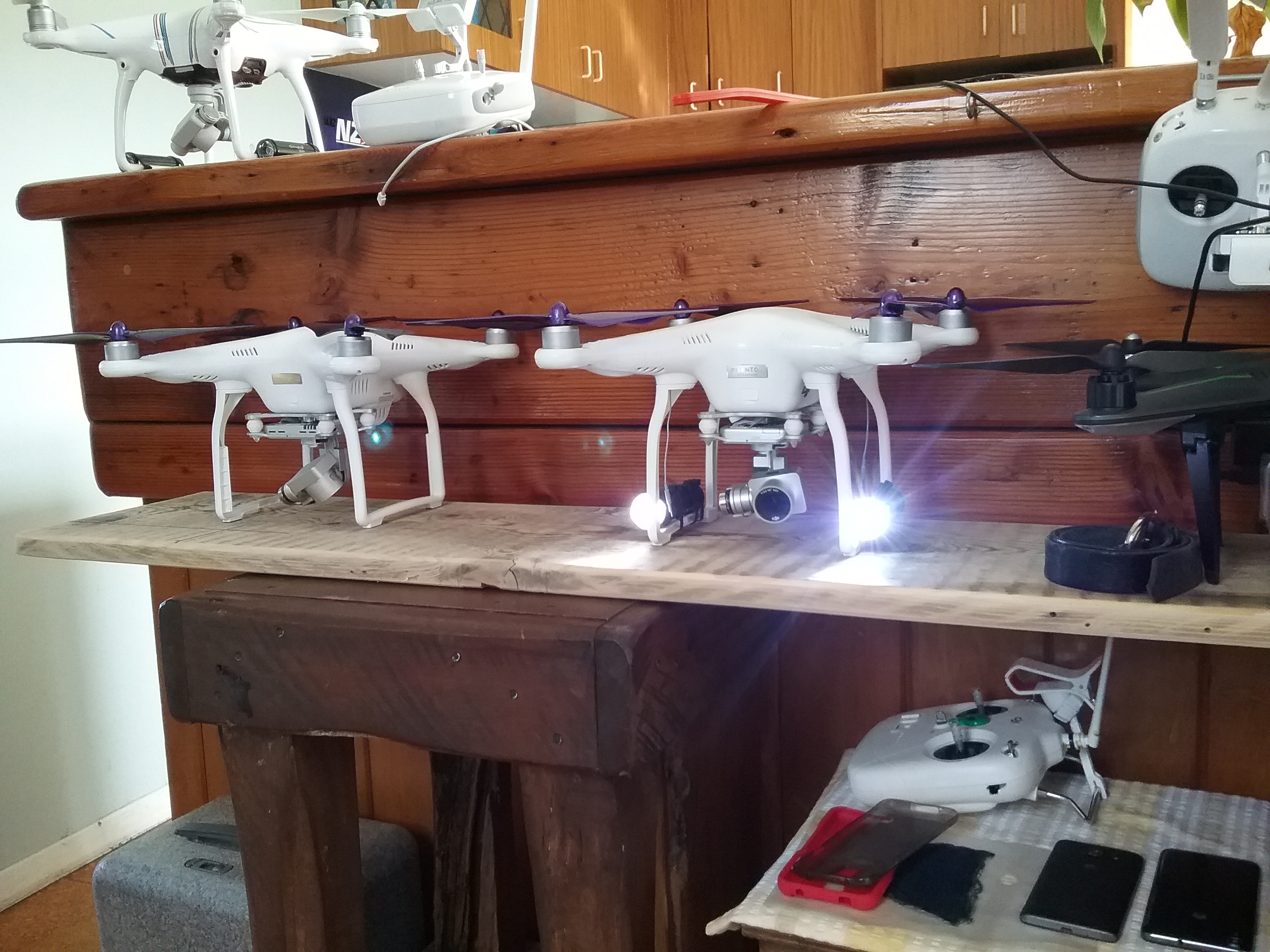

Hi i got these from $$2 shop very liteweight and bright,,never had to change batt yet,,2x1:5 aaa batts,,couple cable ties to secure,,still waitin on proper strobes from ebay,,:)

Sorry 4 delay doin 10 things at once got 4 phantoms but 3 still go and couple others,,i got mine which havent arived yet from ebay nz,,have a look there is so many to choose from,,
