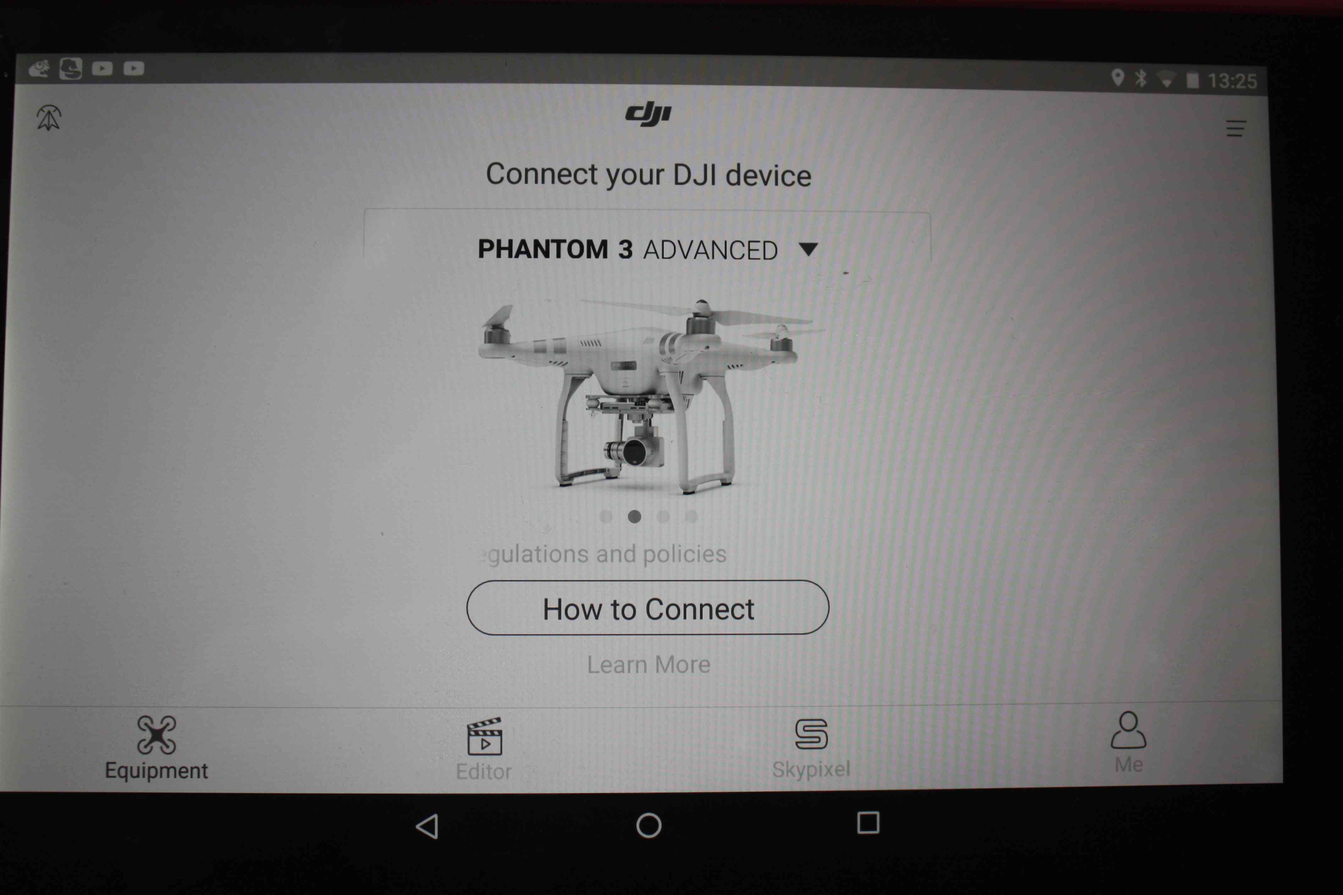

The main problem is that RC does not communicate with the tablet or smartphone.
When I connect the USB cable between RC and TABLET and open the DJI GO application it does not allow me to enter and it gives me the writing "HOW TO CONNECT" instead of "VIEW CAMERA".

See the image attached
