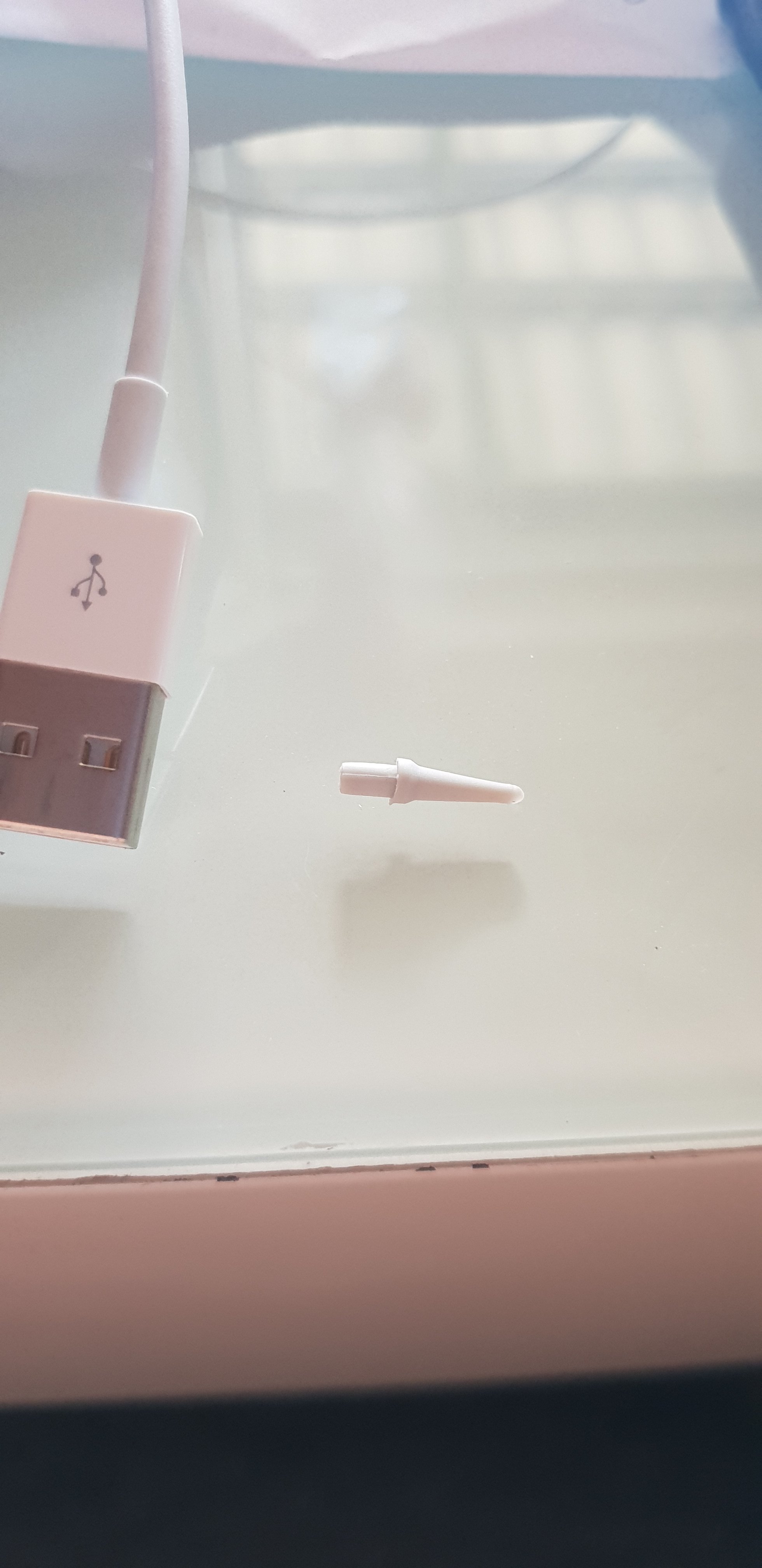

Anyone know where this goes.... it dropped out from the controller when I pulled it apart.
