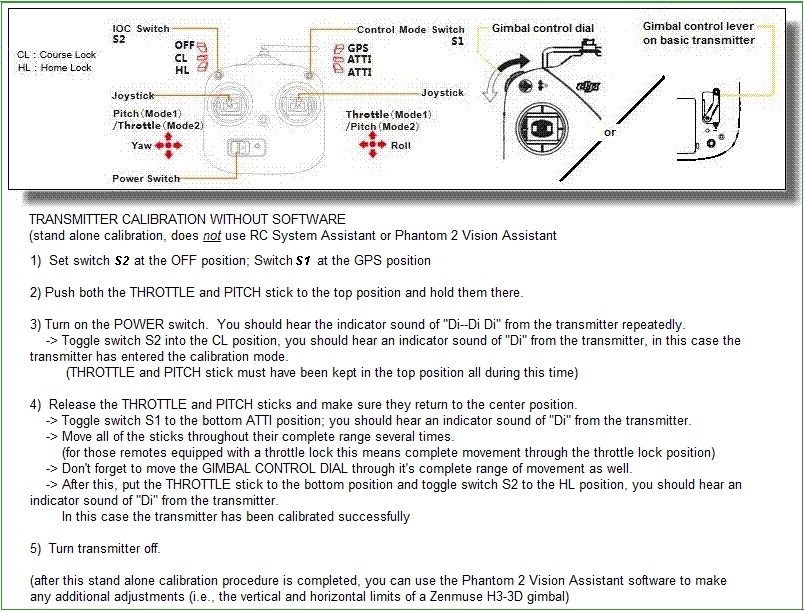

Having the basic RC model I do not have a USB connection to it, thus I would not know how to use the RC assistant; standalone I do the calibration following the attached flow. As said, the second calibration in the app Phantom 2 Assistant also gives me evident indication that the RC is calibrated correctly.
