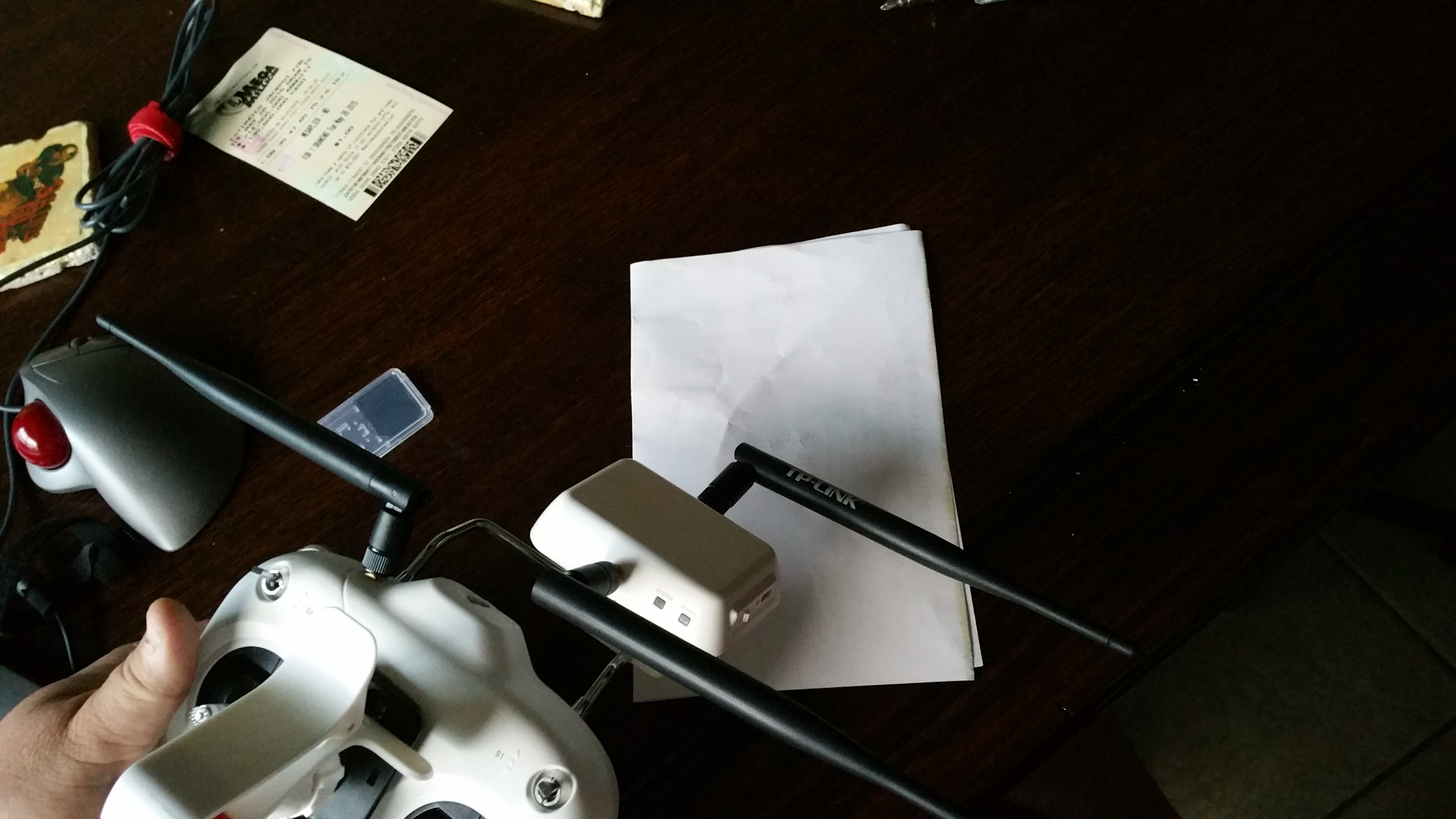

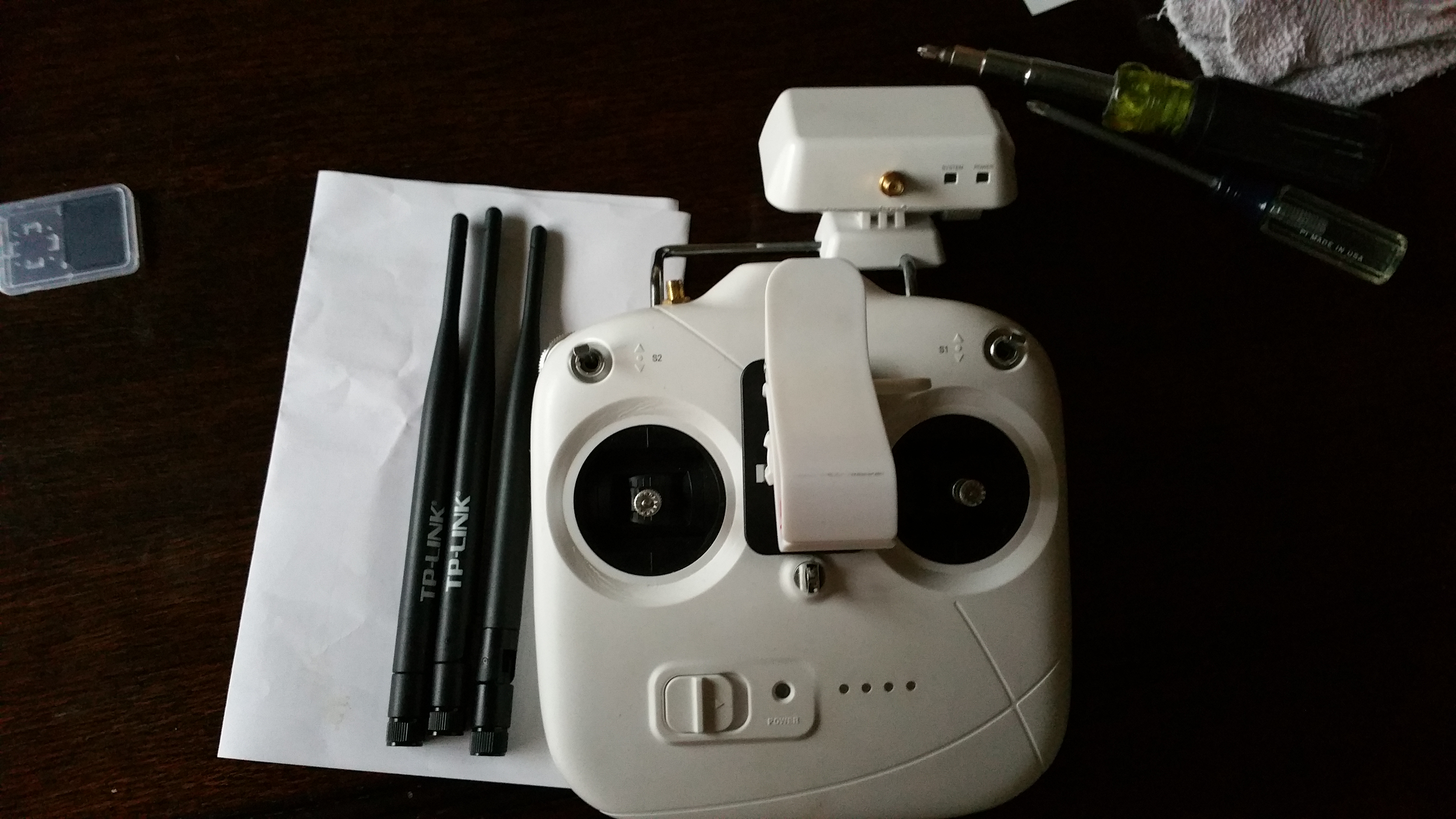

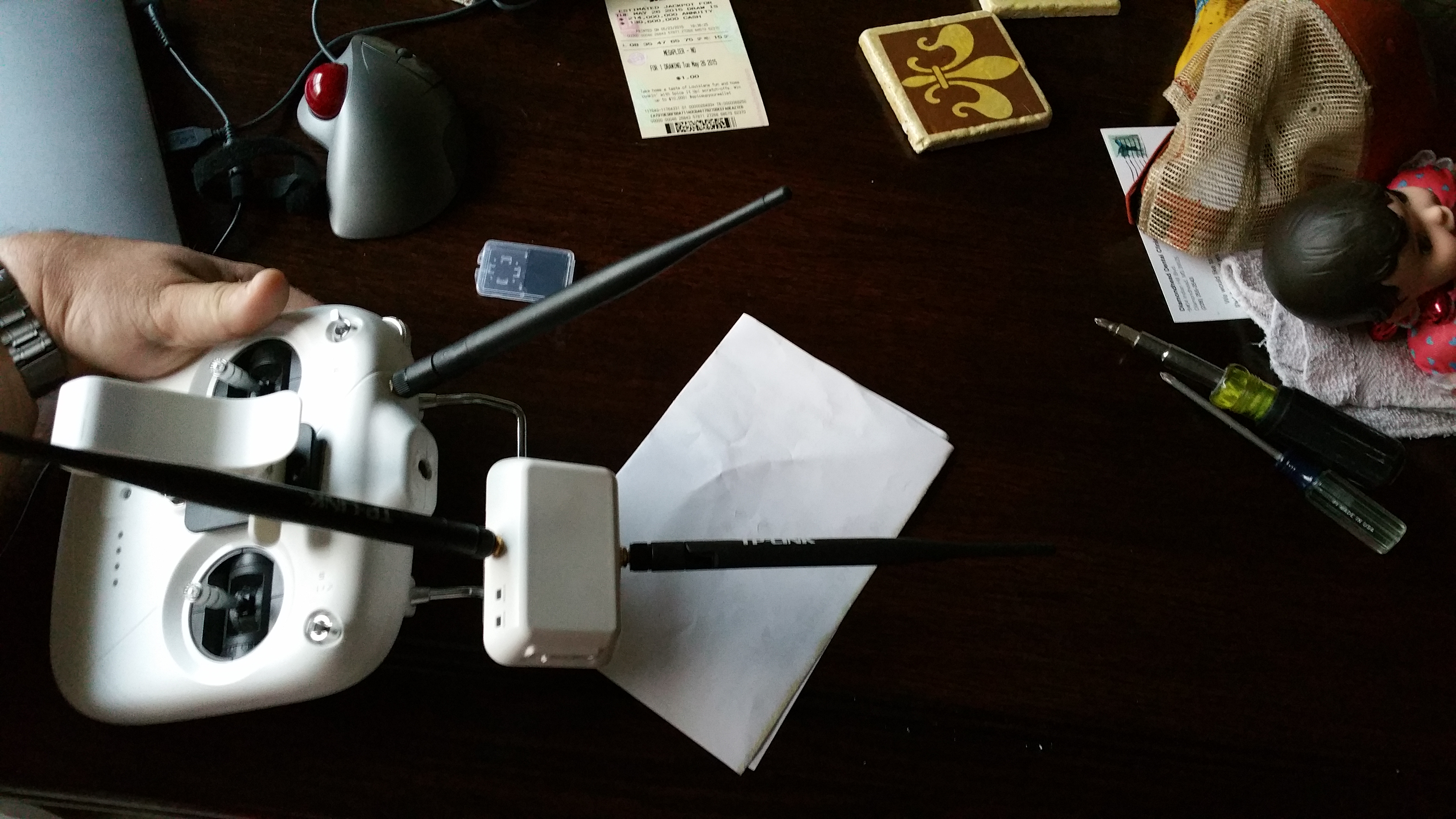

Can you show me how the antenna is pointed? take photo please...
As you can see, you can pretty much set the antenna orientation however you like. The tx antenna i always point it with the long end (not the tip) pointed in the direction of the drone, whether horizontally or vertically.

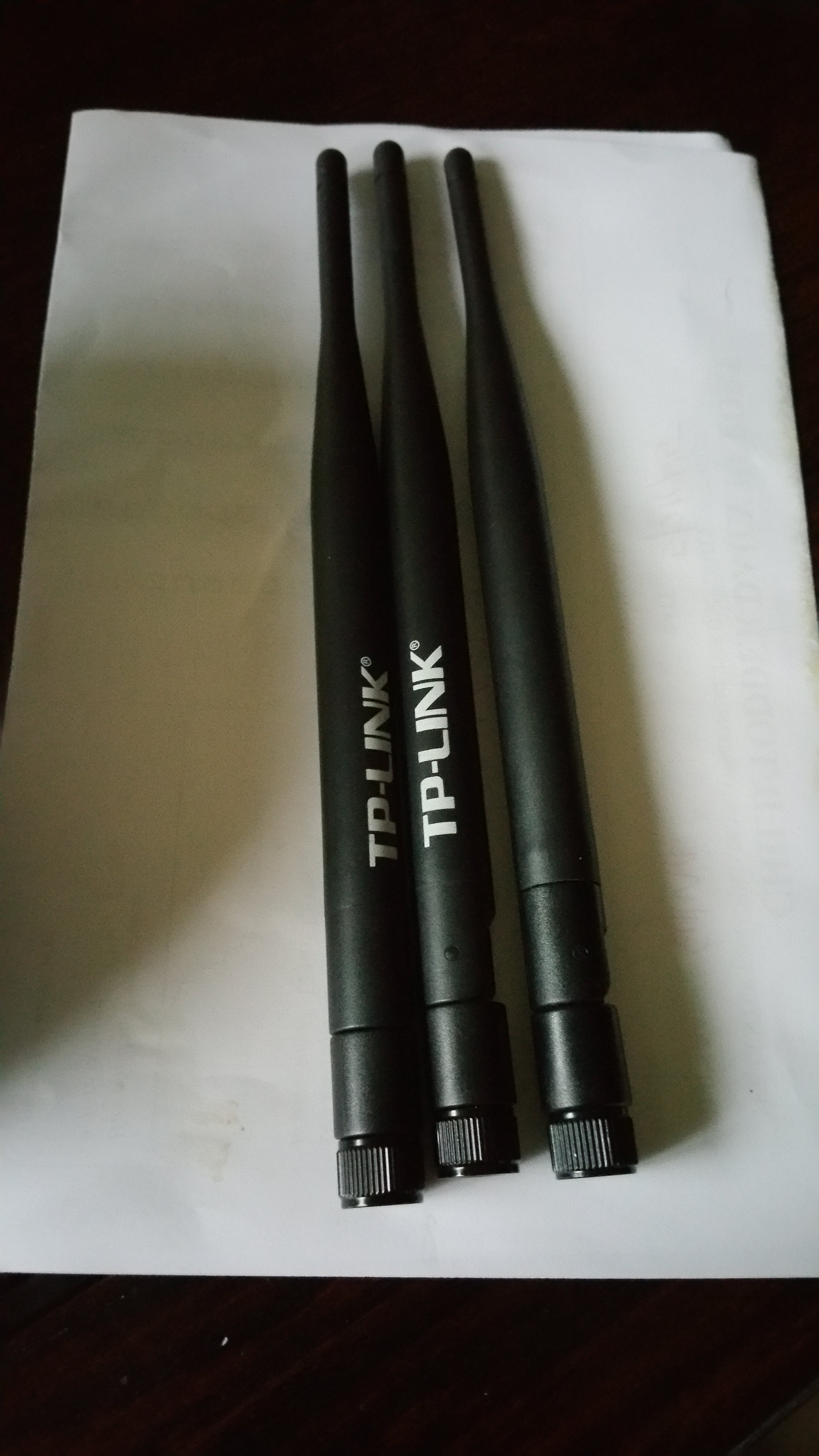

Your antennas look the same. Please be very aware that you cannot mix the antennas. 2.4 antennas are different than 5.8 even though they look exactly the same on the outside.
On the controller side, you should switch back to stock to test.
I don't know for sure of there is a difference but two say TP link and i was told to use those for the wifi extender and one has no writing and to use it for the remote. But over all length and diameter they are the same.

I can tell you now the antenna on your controller is a tad too long for 5.8ghz and that is probably a 2.4ghz and probably jeopardising your control signal. A 5.8Ghz antenna usually isn't that long.
After careful inspection of the 3 amtennas. The 2 I use for the wifi extender have a smaller antenna incaseed in the plastic housing. The one for the remote has a thicker antenna incased In its plastic housing. Not sure of the difference.
