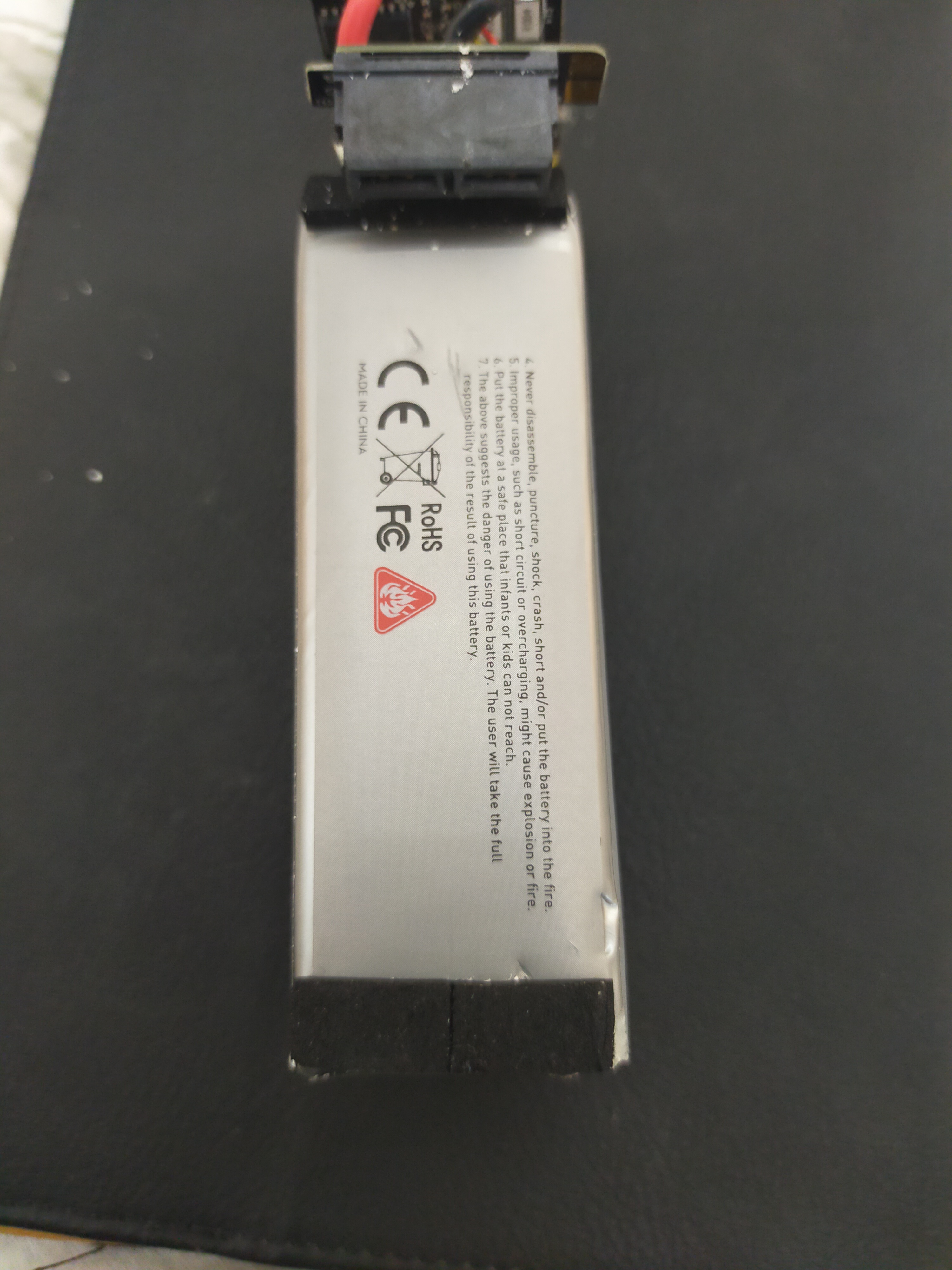

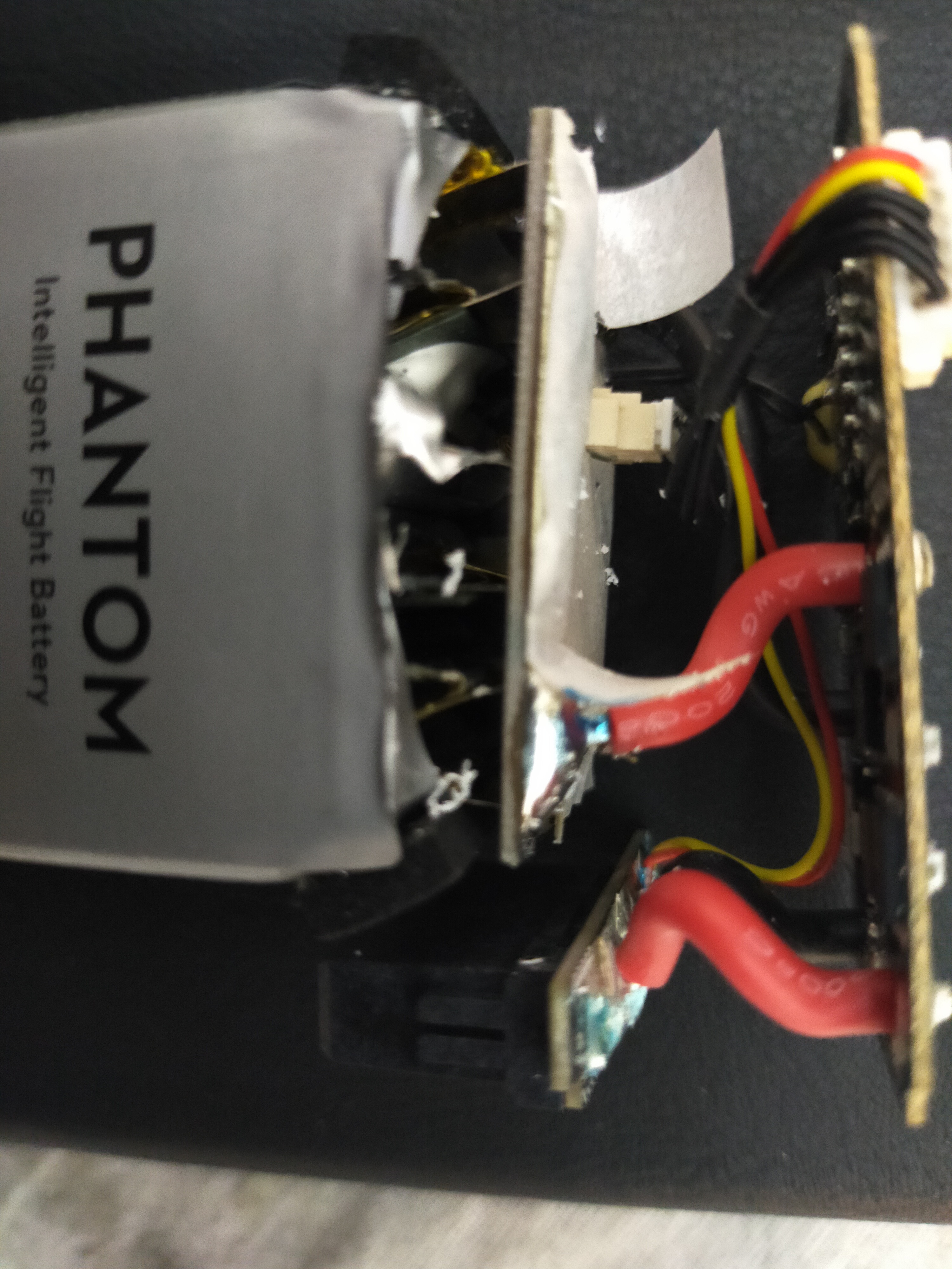

The cells look okay with no swellng and the battery seems to have 6 cells.
What would I need ?
I suppose I would need to get a slow trickle charger.
Cheers

Yes there are actually 6 cells, 3 banks of 2.
If you look at the connections from the cell banks to the underside of the control board, those are the connections to each of the 3 banks of 2 cells, if you take a voltage reading at those 3 points, you will notice that banks 1 and 3 are connected at the same polarity but bank 2 is reversed polarity. This is also the connection point to charge each bank individually (to balance them) and bring them up to at least 3.3v and no higher than 3.4v and with the correct polarity. If you can get all 3 banks in that range, then connecting the factory charger should do the rest.
Can I use a car charger or do i need something else?
That's the interesting question, too high of voltage or current could cause issues and high heat. Ideally you want a programmable charger set to 3.3v but a 6 volt charger could be used, the slower the better, but even quick blast could add enough to that cell to get it's voltage up. The trick is to monitor the cell voltage while charging very carefully.
