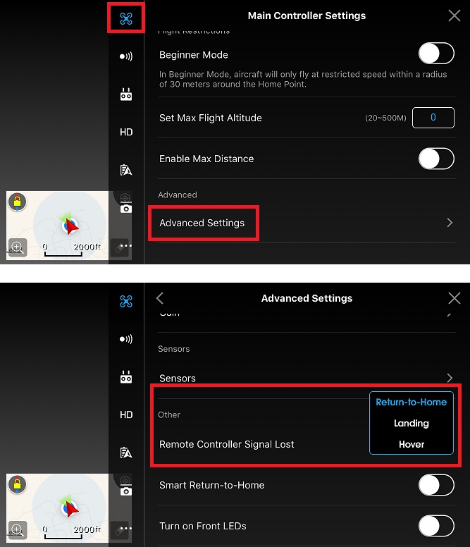

If you know you're going to be flying under obstacles, then you could do the following to make sure this does not happen:
1) Set the "Remote Controller Signal Lost" setting to "Hover".
2) Disable the "Smart Return-to-Home" setting.

Wow, thank you so much for that quick response! And also the workaround! So extremely helpful! Thank you!:)

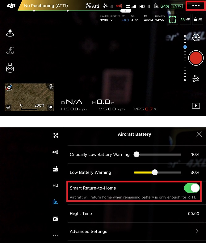

The "Smart Return-to-Home" feature (in my screenshot above) makes the Phantom auto return home (if not cancelled within 10 seconds in DJI GO) when it calculates there is only enough battery remaining to make it back to the home point safely.
